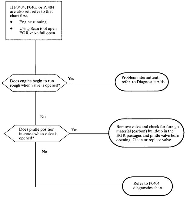

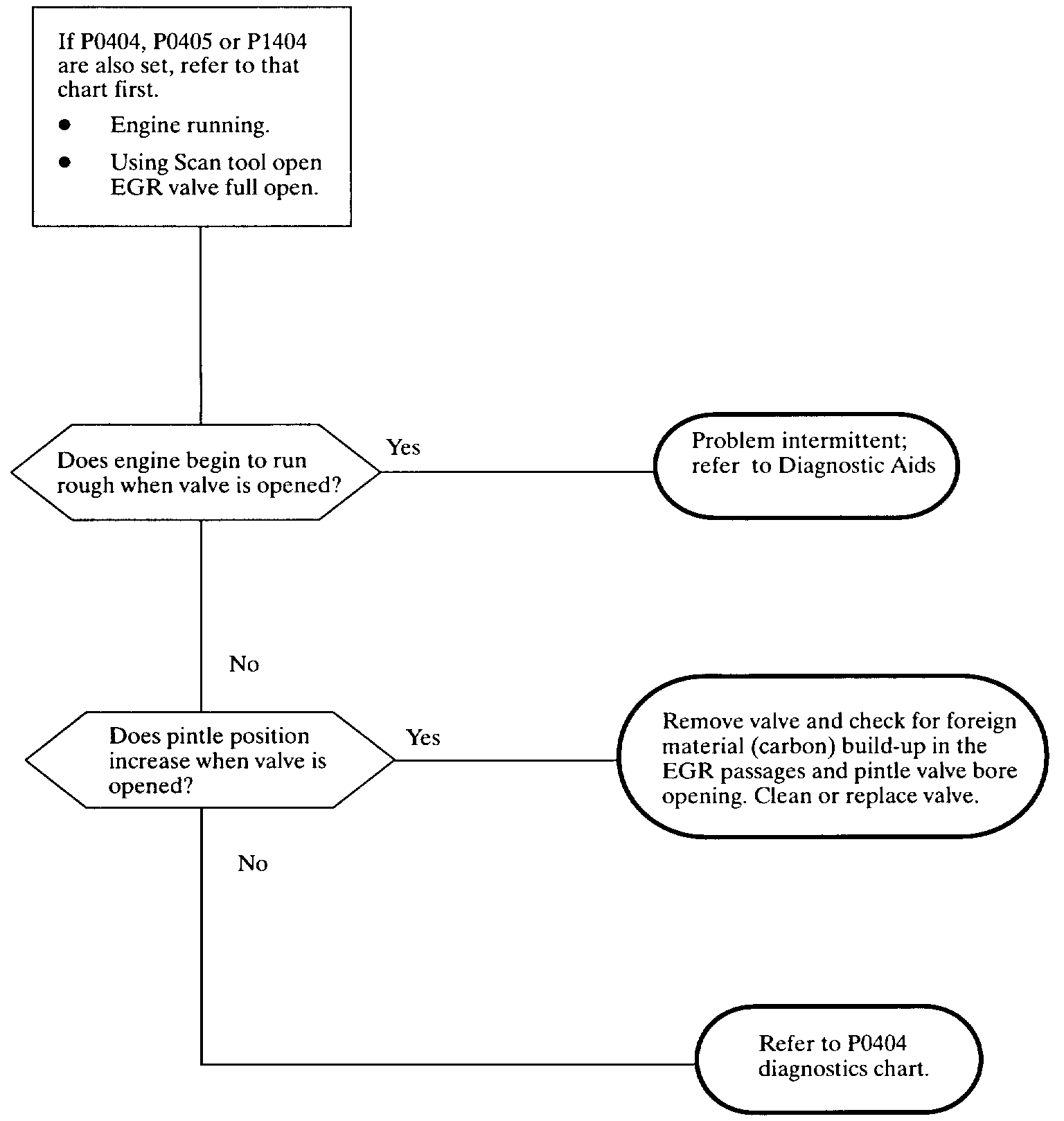

You are correct about the EGR. What I have done is provide a diagnostic flow chart below related to a P0401. This code indicates there is a restriction in the EGR flow. You could simply have carbon built up causing a restriction. In most cases it is carbon causing the issue around the pintle. Check for that.

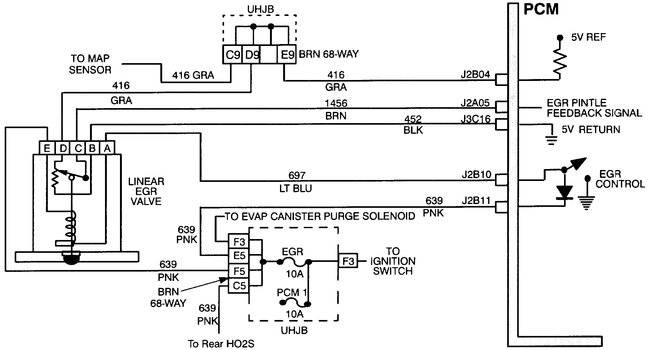

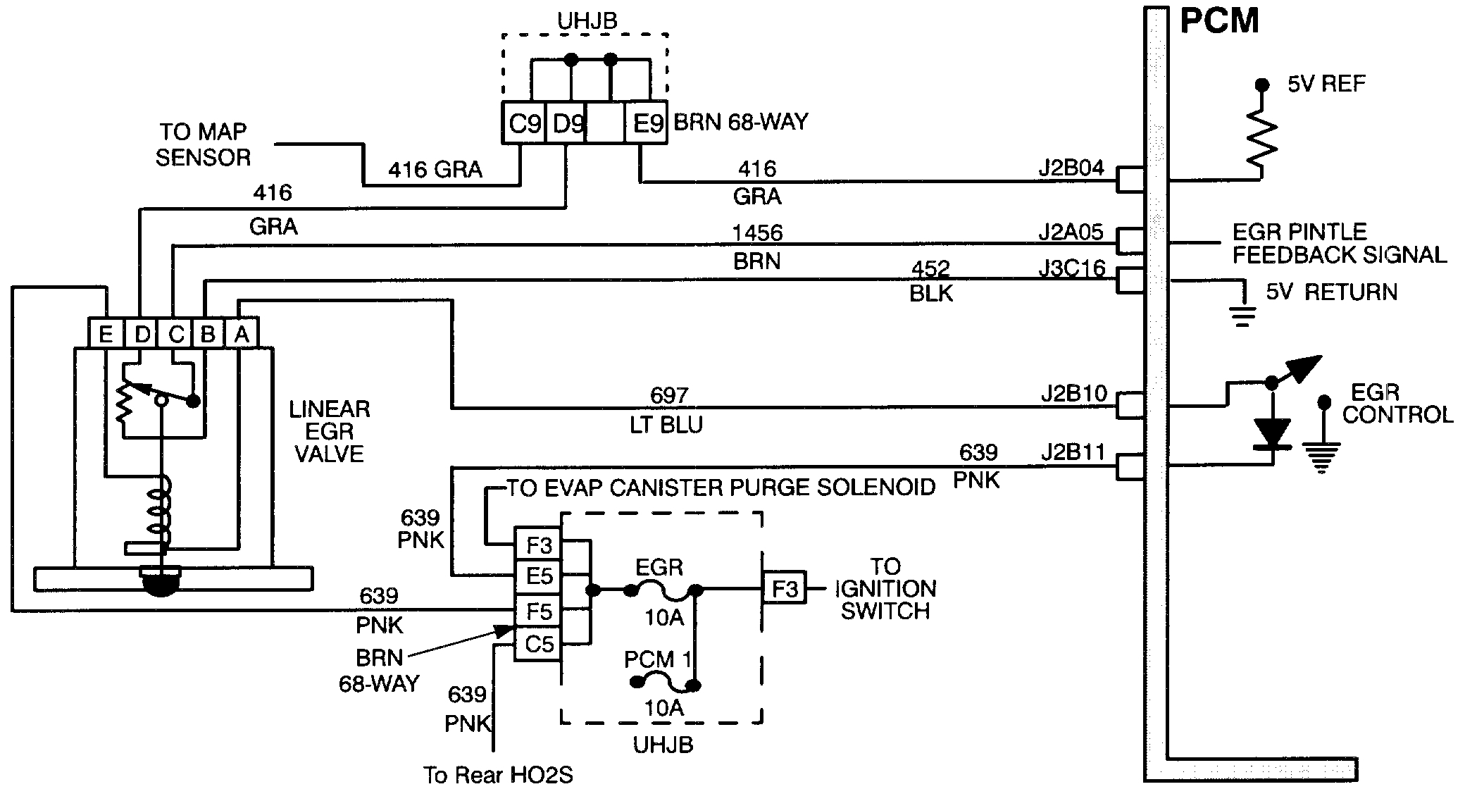

Regardless, here is info related to the code and pic 1 below is the flow chart and pic 2 is the schematic of the system.
Let me know if this helps. Also, if you do have a live data scanner, pay attention to the O2 sensor voltages. When the vehicle is warm, they should be changing. If they don't, replace the affected sensor. I would need the code you got to determine which sensor it would be.

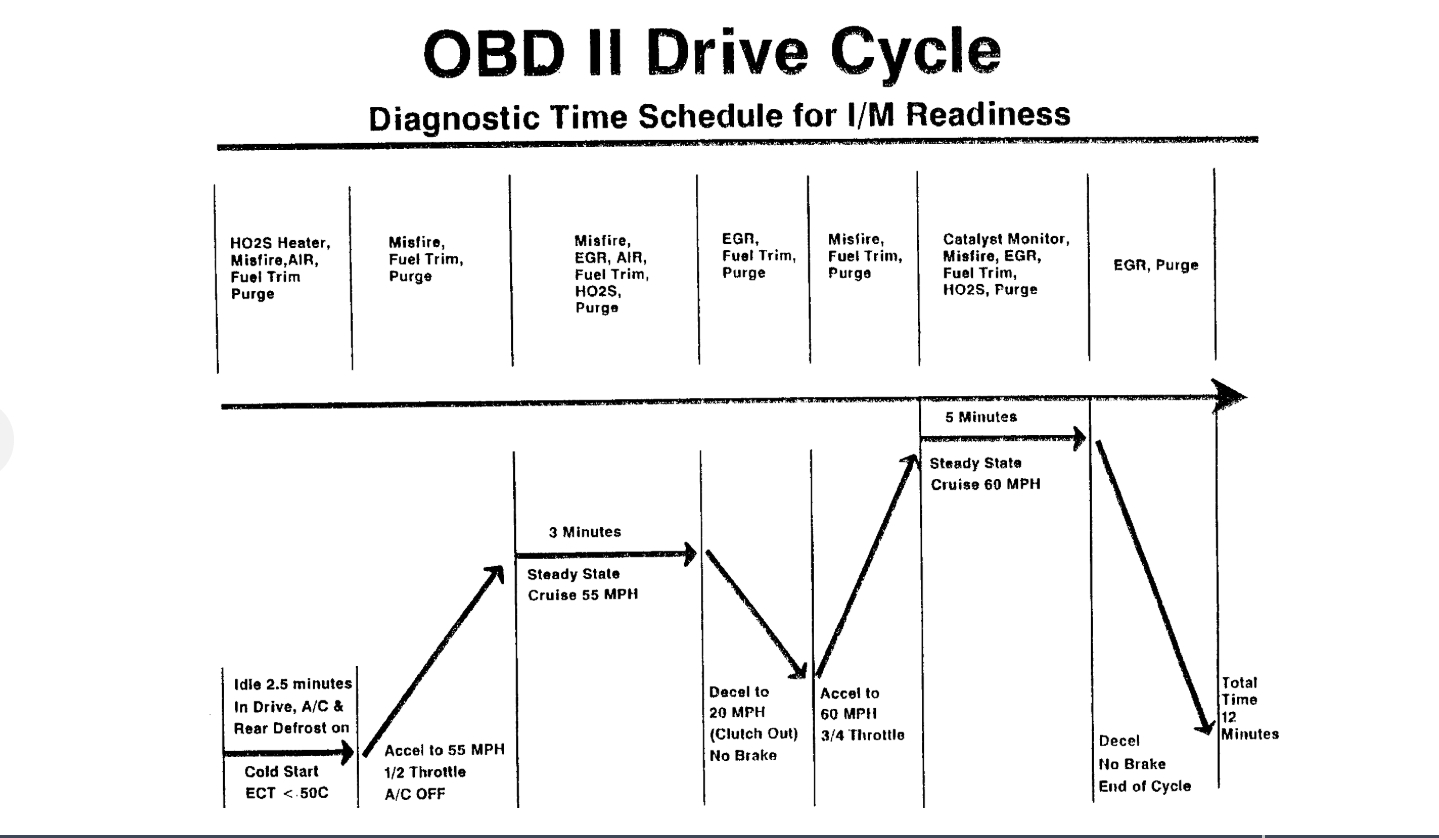

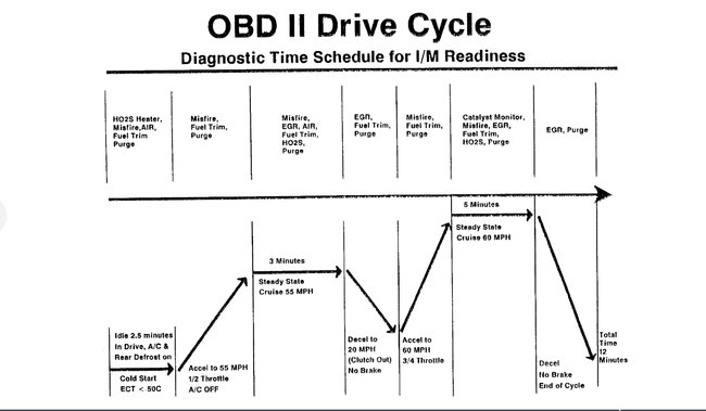

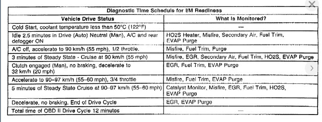

Feb 24, 2020 at 11:13 PM
SCGRANTURISMO
  • 4,897 POSTS
Hello again,

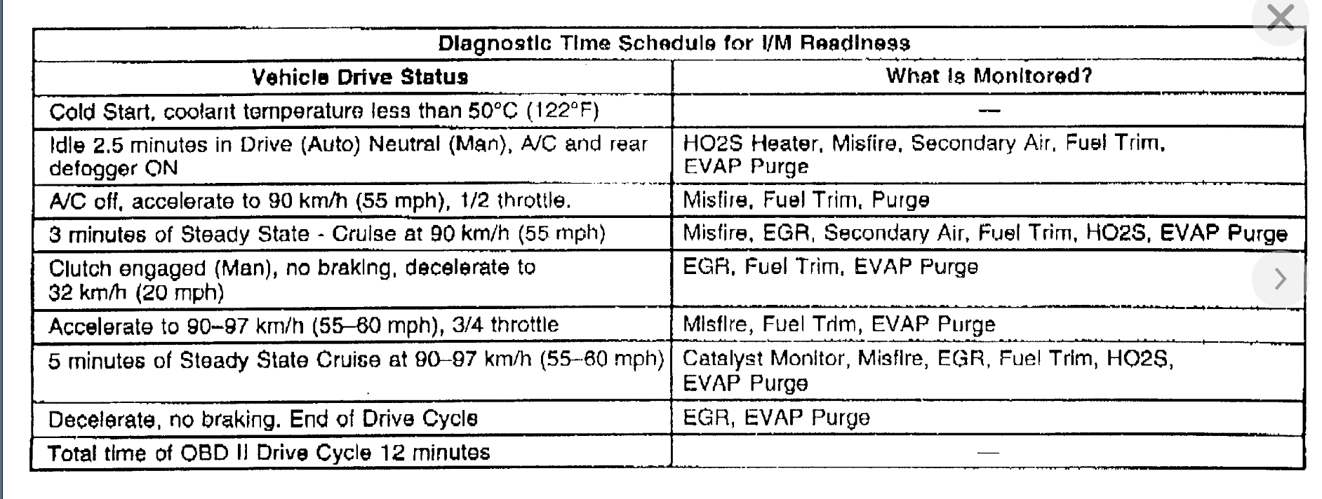

In the diagrams down below I have included the OBD2 drive cycles to run monitors for your vehicle. These diagrams will explain how and when the I/M readiness are read by your vehicle. Please go through them and keep us informed. I hope that this helps.
