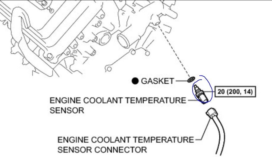

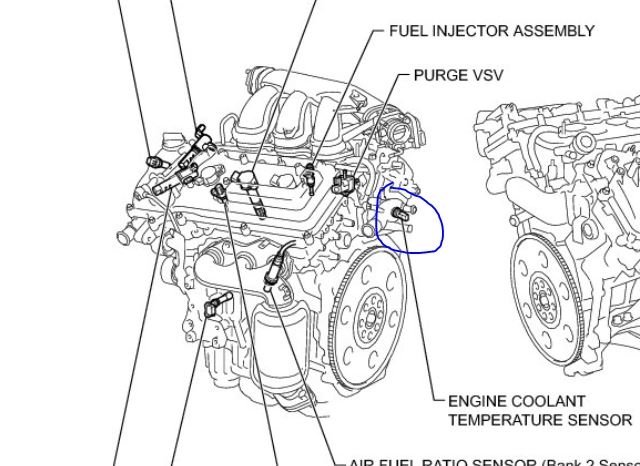

I think you are on the right track. The code is for the coolant temp sensor. For this code to set, there is no change in the reading from the sensor between a cold engine and a warm engine. With that, either you have a bad connection, damaged wire, or the sensor is bad.
Since this controls the fan operation, most likely it is causing the AC issue as well. The first two pictures I attached show location. I circled the sensor.

Thanks Joe. Man, that's a lot of steps to just replace a sensor! Do you think there's a way to get to the the sensor without so much disassembly? I'm a little confused of its location, too. Is it on the lower right side of the engine, in front of the firewall? If I took it to a local mechanic, how many hours would the charge be?

Looking at the pictures, I see why it's confusing. One shows it in the rear of the engine and the other right rear the upper radiator hose. Take a look on your vehicle where the upper radiator hose connects to the engine to see if that is where it is. In the past, that is where I remember them being.

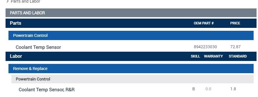

As far as parts and labor, take a look at the picture I attached. It shows part price (original equipment) and labor time.
Let me know if that helps.
