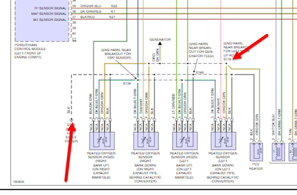

This car has been giving me problems. It has gave several obd codes; p0032, p0038, p0052, and p0058 are the ones given mostly. It has also gave codes p0300, p201-p206 injector codes all six, p2096. I cannot remember any others right off seems like they were a couple more. I figured it was an electrical problem so i cleaned what grounds i could find before i had a FSM. Now that I have a FSM i am going to check the wiring for the O2 sensors. The car would run fine and shut off and not start back then I could remove the negative battery terminal and put it right back on and it would do fine. Well after the first episode it ran fine for a month. Then it done it again. Now it has gotten to where it is doing it more often. Any help would greatly be appreciated.

check battery for condition including load test. a lot of times a battery going bad will cause false or inaccurate codes. in wiring diagram it seems all O2 get power from same area and ground at same area. just wondering if that may be the cause as most are O2 related. See picture. like a broken or shorted wire in harness.

i got a new battery and installed it and it done it within five minutes of starting it! i am trying to check the wiring and o2 sensor's but i have never gotten that detailed into tracing out wiring on a vehicle before!

just for the heck of it try driving it if you already have not the computer may have to relearn.

i did drive it the computer went to flashing the MIL, limp mode. it is done okay today i put about one hundred and twenty miles on it. i changed plugs and fixed a wire someone had spliced before on the 2/1 o2 sensor. it was a shady splice. but i do not know if it was the problem. time will tell.

I drove the car Thurday-Saturday for about 250+ miles and she done fine like her old self! I"ll for sure be on here cussing if I didn't get it lined out! J/K lol
