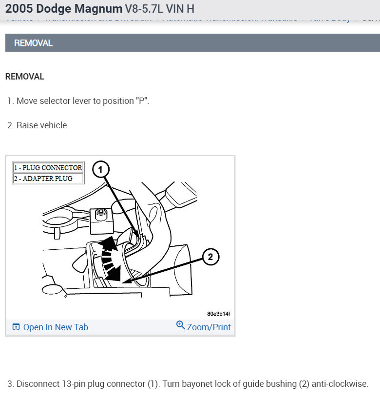

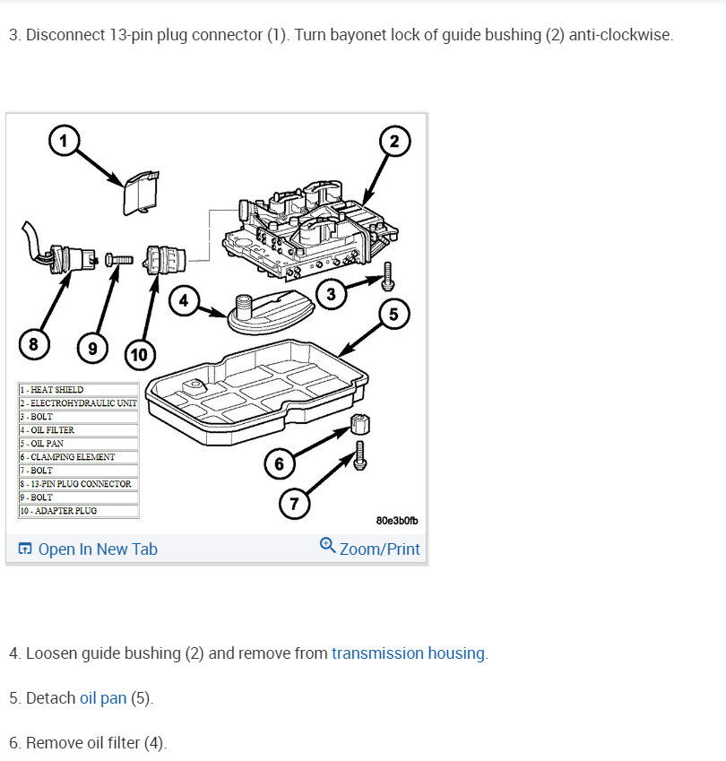

Yes, the turbine sensor can cause this, but I need to ask what kind of fluid did you use because this car takes only one kind of fluid and if you put the wrong fluid into the transmission, it will act this way. here is the location of the sensor so you can change it out and clear the codes.
Mopar ATF +4, Automatic Transmission Fluid is the recommended fluid for DaimlerChrysler automatic transmissions.
Both input speed sensors are part of the lead frame portion of the valve body inside the transmission. Check out the images (below). Please let us know how it goes.

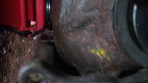

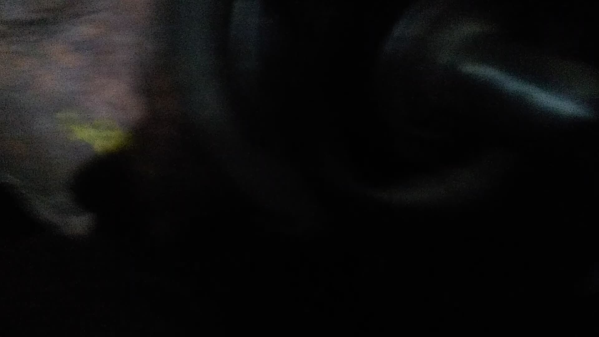

Is there supposed to be this much play in the rear end? i turned the center carrier bearing around as you suggested and it's a lot worse! Now I'm getting code p2767 turbine sensor which also has in common with the low fluid/dirty fluid! If the carrier bearing is a lot better with no vibration installed backwards, there has to be something way out of whack, correct?

It is hard to see in the video what's going on, can you please add more light? Here is more information on the problem.
The P0731 code on your 2005 Dodge Magnum indicates an incorrect gear ratio for first gear.
