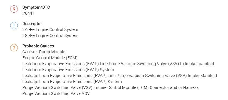

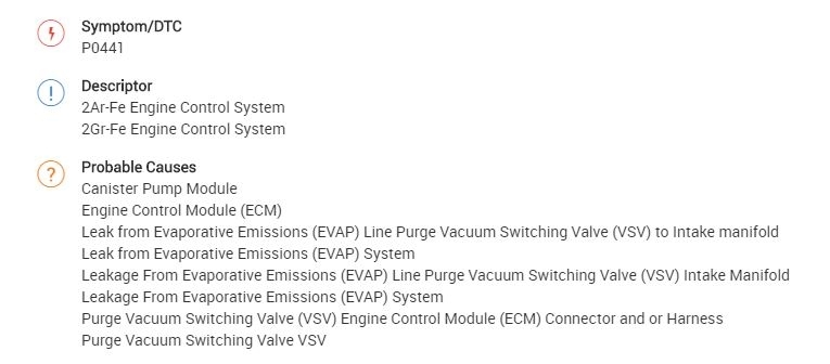

OBD code P0441. Toyota dealership has replaced the purge solenoid, they replaced the charcoal canister and finally they replaced the cars computer. After driving for 30 minutes I still have the 0441 code. Toyota dealership is mystified as to the cause. They kept my car for a week and still cannot figure it out. Help.
Feb 24, 2020 at 4:54 AM
Good afternoon,
I attached the flow chart below for the code. It is not an easy code to resolve. It appears the dealer has no experience techs to do this repair. You will need an advanced scan tool to follow this flow chart.
DTC SUMMARY
DTC No. Monitoring Item Malfunction Detection Condition Trouble Area Detection Timing Detection Logic
P0441 Purge VSV (Vacuum Switching Valve) stuck open Leak detection pump creates negative pressure (vacuum) in EVAP system and EVAP system pressure measured. Reference pressure measured at start and at end of leak check.
If stabilized pressure higher than [second reference pressure x 0.2], ECM determines that purge VSV stuck open.
Purge VSV
Connector/wire harness (Purge VSV - ECM)
ECM
Canister pump module
Leak from EVAP system
While ignition switch off 2 trip
Purge VSV stuck closed After EVAP leak check performed, purge VSV turned ON (open), and atmospheric air introduced into EVAP system. Reference pressure measured at start and at end of check.
If pressure does not return to near atmospheric pressure, ECM determines that purge VSV stuck closed.
Purge VSV
ECM
Purge flow While engine running, following conditions successively met:
Negative pressure not created in EVAP system when purge VSV turned ON (open)
EVAP system pressure change less than 0.4 kPa-g (3.0 mmHg-g) when vent valve turned ON (closed)
Atmospheric pressure change before and after purge flow monitor less than 0.1 kPa-g (0.75 mmHg-g)
Purge VSV
Leak from EVAP line (Purge VSV - Intake manifold)
ECM
While engine running 2 trip
