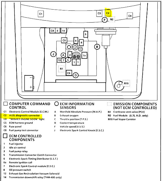

Where is OBD 1 located?
1989 GMC SIERRA
117,000 MILES • 5.7L • V8 • 4WD • MANUAL
PCBRIAN
OBD1 location.
Nov 26, 2022 at 4:29 PM
  • 110,194 POSTS
If you are looking for the data link connector (DLC), it is in the vehicle under the dash on the driver's side of the vehicle. It should be visible.
I attached a pic below showing the location. See if you are able to find it. If you can't let me know. Also, here is a link that explains how to retrieve codes from the OBD1 system for a GM vehicle.
https://www.2carpros.com/articles/buick-cadillac-chevy-gmc-oldsmobile-pontiac-gm-1983-1995-obd1-code-definitions-and-retrieval-method
See pic below.
