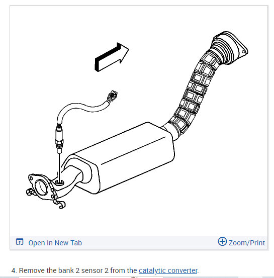

Hello, I need details on changing my O2 downstream sensor for a code p0137 bank 1 sensor 2. Any photos will help and what all I need. thanks

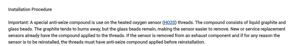

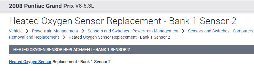

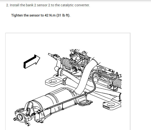

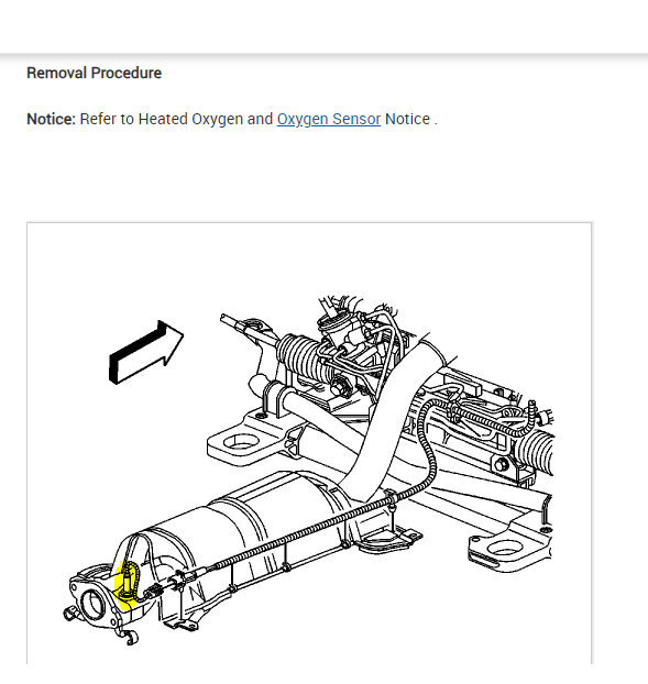

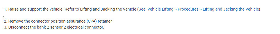

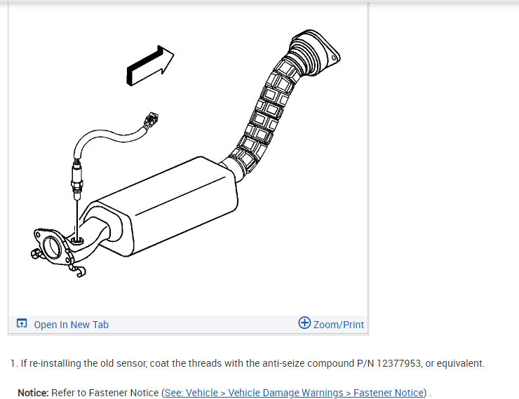

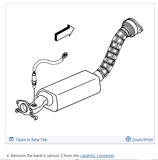

I attached a pic below showing the downstream oxygen sensor. I need you to confirm something for me.
If I recall, the exhaust on this vehicle has a cross-over pipe that joins the two manifolds together. If that is correct, the sensor will be after the catalytic converter. I attached directions below.
Note: When you replace this, it may be extremely hard to get out. Take your time. Also, when you install the new one, make sure to use an anti-seize product for O2 sensors. Additionally, you will need a special socket to be able to remove and install the sensor that prevents damage to the wiring. Chances are a parts store will lend one to you
Let me know if this helps.
See pics below: Note: The heading indicates it is for bank 1 sensor 2. Then, it is referred to as bank 2 sensor 2 in the directions. I'm not sure why they did that, but if I am correct that the two sides go into one converter, the directions are correct.
