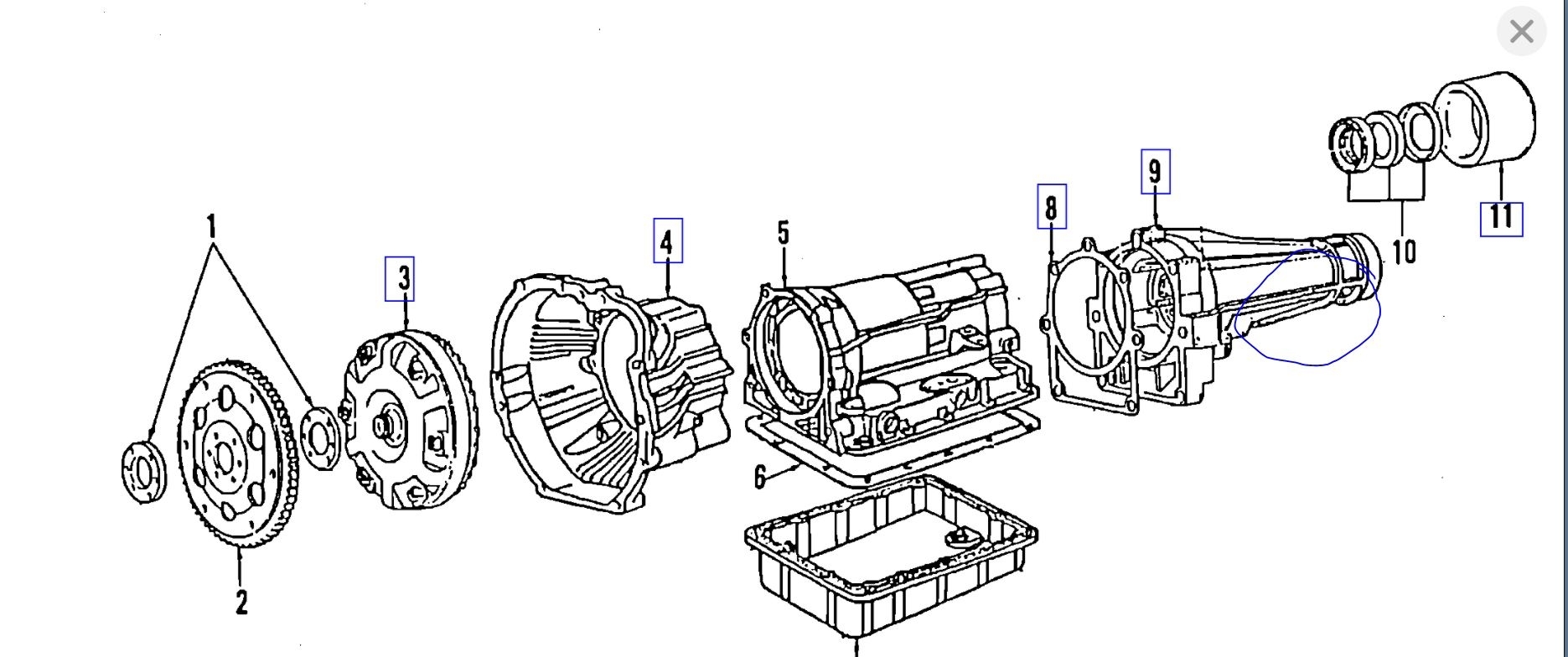

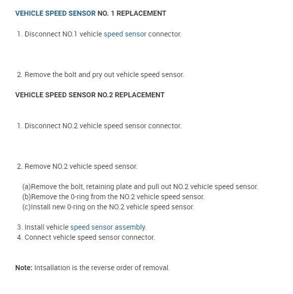

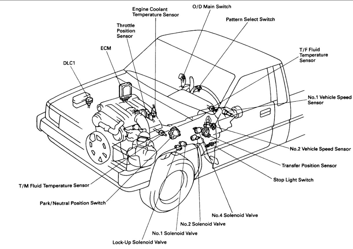

I need the code number to help. There are 2 vehicle speed sensors, and the code number will narrow down which one has the issue.
The fact the speedometer is not working is why both lights are coming on. The engine and transmission need to see road speed at all times.
I attached the procedure and location for you of the sensor.
