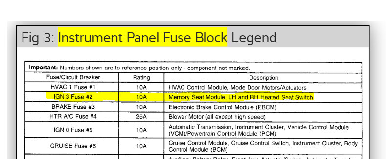

I replaced the front actuator, the shift case motor and the control panel and fuse still pops. I don't have a clue what can be popping it. I'm not too good with testing thing, as you can read by me just replacing parts. Any help or ideas what it can be?

I'm looking at the under-hood fuse box and fuse 2 indicates it's for the heated seats and seat memory. Where is the fuse located and I suspect it is for the 4wd based on what you mentioned. Let me know.
Also, let me know if the fuse fails when you first install it regardless of the ignition key position or if you have to select 4wd for it to fail. One last thing, let me know about the fuse amperage.
See pic 1 below and let me know which applies to your vehicle.

Sorry for not being specific. It's the number 2 fuse on the side panel by the steering wheel. Found a whole role of wires going across the top on engine that were burned on driver side manifold. It fixed the 4x4, radio window and the wipers finally work. I'm still troubled about the truck kind of hesitating after sitting a little while. Did fuel pump and spider injectors. I was trying to do fuel filter but i don't want to bust the line.

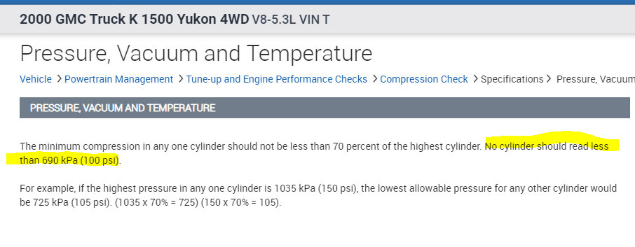

Let me know if that eliminates the fuse issue. As far as a compression test, you can do it at home. All you need is a compression gauge. Most parts stores will lend one to you.
Here is a link that explains how it's done:

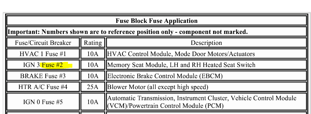

Next, I went to a different manual and found the same information for fuse 2. See attached pic. That is the fuse box at the end of the dash, correct?
As far as the compression is concerned, it isn't hard to do. I'm interested in knowing what is found. I attached the compression information below. See pic 2
