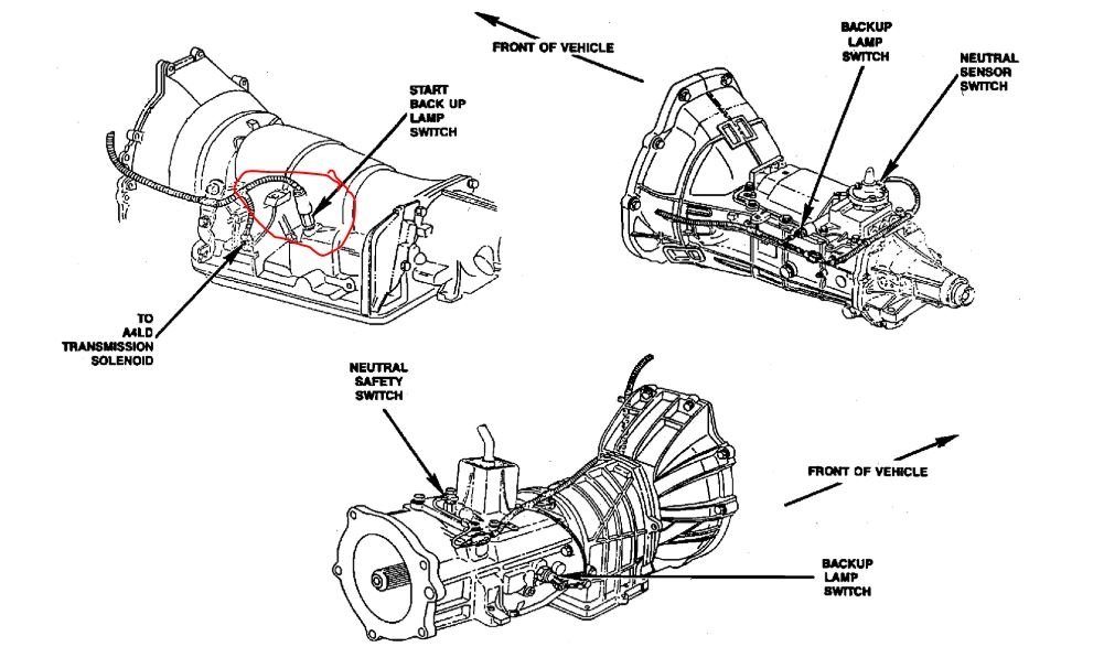

Can anybody tell me where is the NSS [Neutral Safety Switch] on my vehicle ? Anybody have a Haynes Shop manual with a pictures?
It's not on the transmission and it's not on the steering column.
May 20, 2020 at 6:22 PM
Good morning,

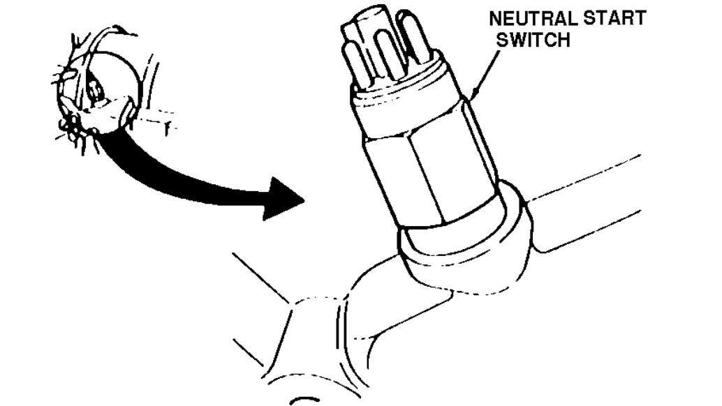

Yes, it is on the transmission. It has to be to get a signal for park and neutral.
I attached a picture of the location for you and the procedure for replacing.

(was looking for "old style" mechanical NSS on the transmission gear selection/shifter cable linkage. my bad ;-(

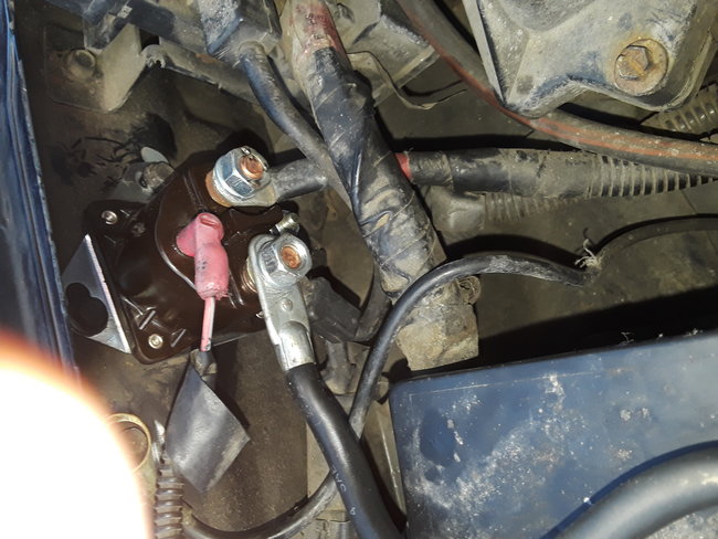

I have ignition circuit voltage 12.9v (small red wire on top center small post of solenoid) at the solenoid switch (on rf firewall) when i turn on the key start on steering column. ie. On column ignition switch [mechanical/electrical] is "working" or seems to be working.
Vehicle will not key start in p (park) or in (neutral) shift position(s).
Other details; new solenoid switch, battery at 12.9v,all battery cells at 2.1v each, new battery terminals, electrical grounds at firewall and right front fender cleaned and dielectric grease install.
Solenoid switch "clicks" one time only when ignition key is activated- but starter does not turn over (not activated at all).
Vehicle will not jump start from second vehicle with battery to battery cables.
Vehicle will start strong (every time) when solenoid switch is bypassed. positive battery terminal to positive starter cable at solenoid.

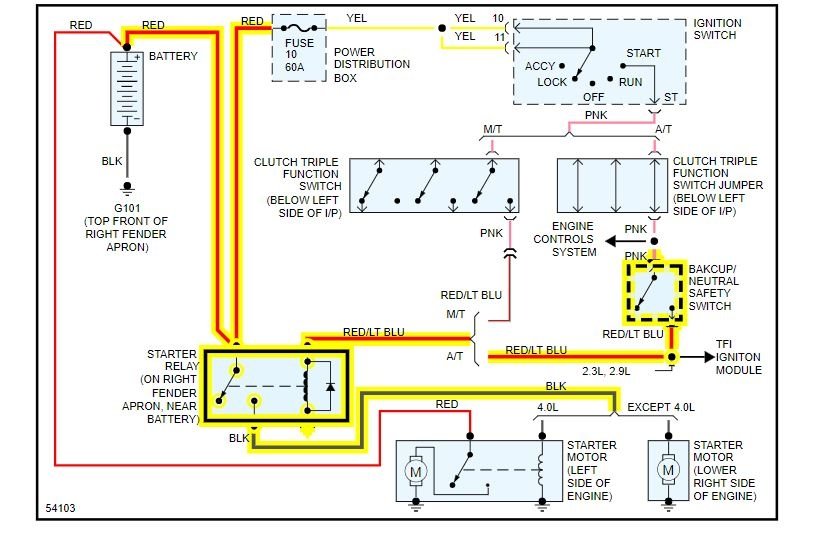

Okay, the little wire on the solenoid should have power in the start position. To see if the starter works, use a screwdriver from the positive of the battery post to the stud that the little wire is attached to. It should activate the starter.
As far as the neutral switch, there should be power at the pink wire. That is from the ignition switch. Then the power goes to the red/light blue wire and off to the solenoid.
I attached the diagram for you.

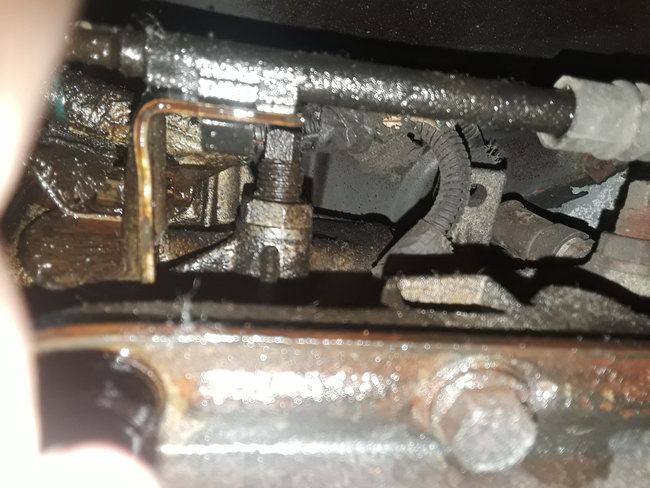

Problem: can't get the NSS electrical connection off. Heat "frozen" on there? Don't want to wrench on it and possibly damage the electrical or NSS (if good).
Question: is there an alternate way to remotely test the NSS? Maybe through the on steering column starter switch? Or other way?

You can try back probing the wires at the switch for power without removing the connector.

At the solenoid under the hood, the little wire to the push on the stud should only have power in the start position. There should be no voltage at any other time.
That voltage comes from the neutral safety switch. The pink wire gets power from the ignition switch only in the start position. The switch will allow voltage to go to the red wire that goes right to the solenoid.
