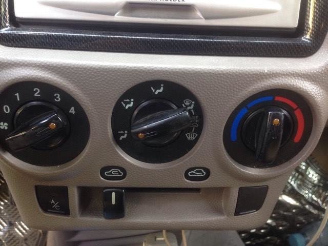

Dear Sir,
My Problem is when my car run about 1 hours (Operative Temperature) my car not roll by it self, i mean when after waiting the traffic light and put the transmission to D or L it not roll by self and i need to push on gas pedal and than it feel like someone hit my back. When in cool it work pretty well. After some testing i found that when it start the problem i turn the air con to hot part (look at the picture) but without turn off the air con with max air, than it work much better. so, what is that problem? it is very difficult to drive in summer.

first we don't have that model in USA so no info but your car has a 1L engine with a/c that is not a lot of power to begin with and the a/c is drawing a lot of power to cool the car so that is why it doesn't run very well with a/c on.

Thank you for your reply. Actually, when turn off a/c much worse than turn on the a/c. Driving with a/c and without a/c are the same of engine power but without a/c problem come faster than a/c on.

like I said we have no info on this model so scan for codes and check fuel pressure if you can but not having specs I cannot go much further with this.
