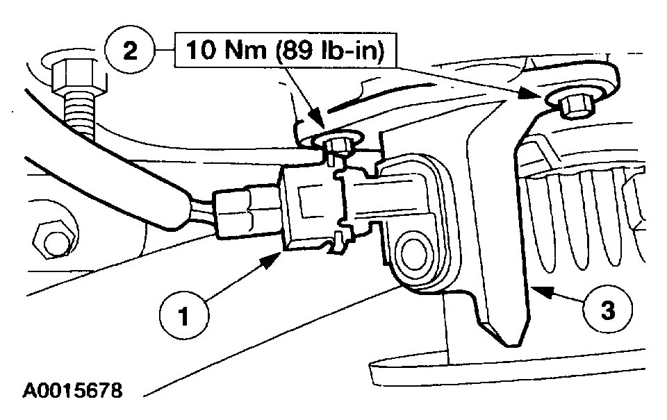

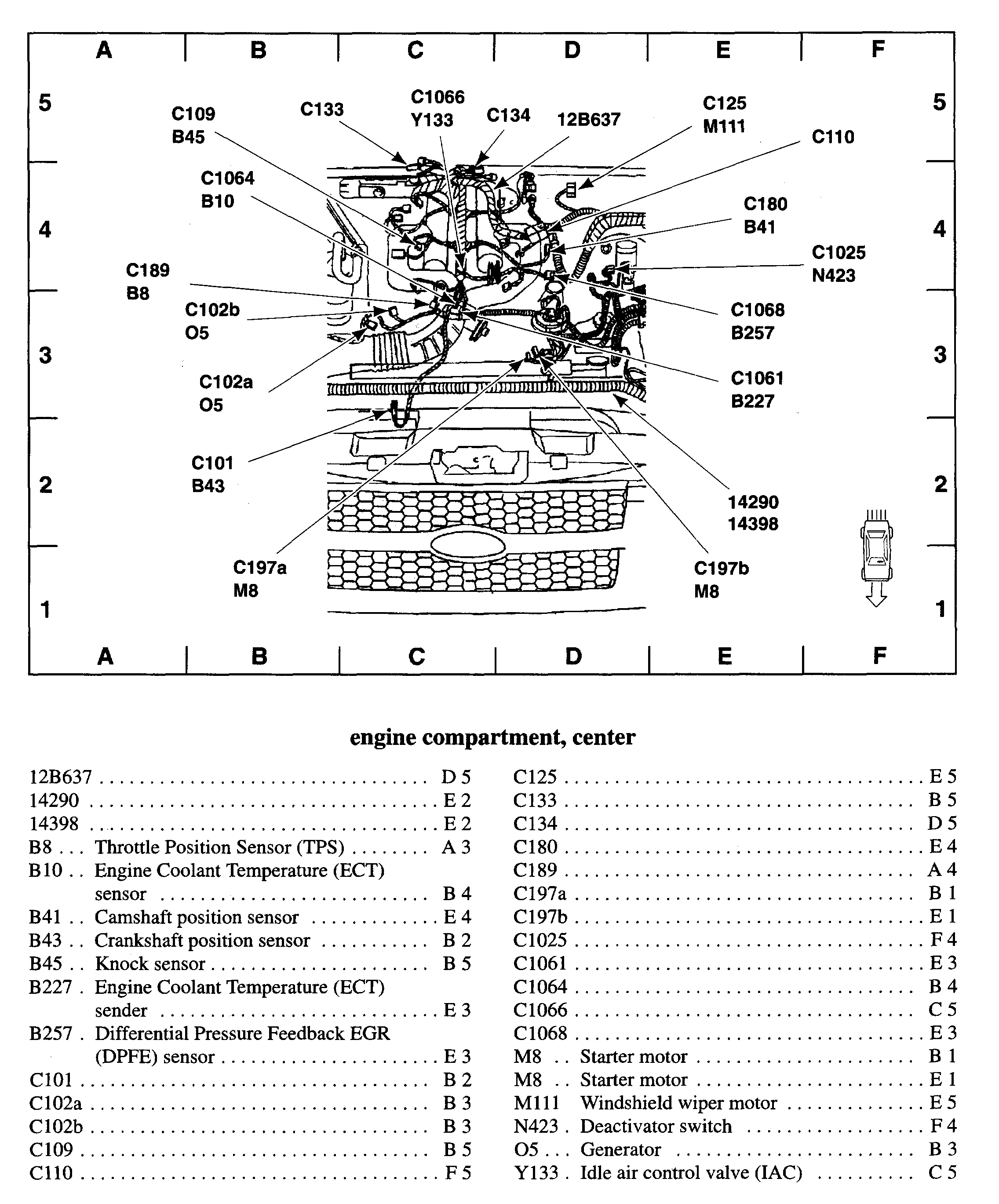

Next, here are the directions specific to your vehicle. The attached picture correlates with the directions. Note that picture 1 is location and picture 2 is provided as a guide when replacing.
____________________
PROCEDURES
REMOVAL
picture 2
1. Remove the Crankshaft Position (CKP) sensor.
1 Disconnect the electrical connector.
2 Remove the bolts.
3 Remove the sensor.
INSTALLATION
1. To install, reverse the removal procedure.
NOTE:
^ The new CKP sensor needs to be touching the damper. The new sensor has wear tabs that will wear off after several engine revolutions.
^ Be sure the sensor wiring is routed away from the battery cable.
