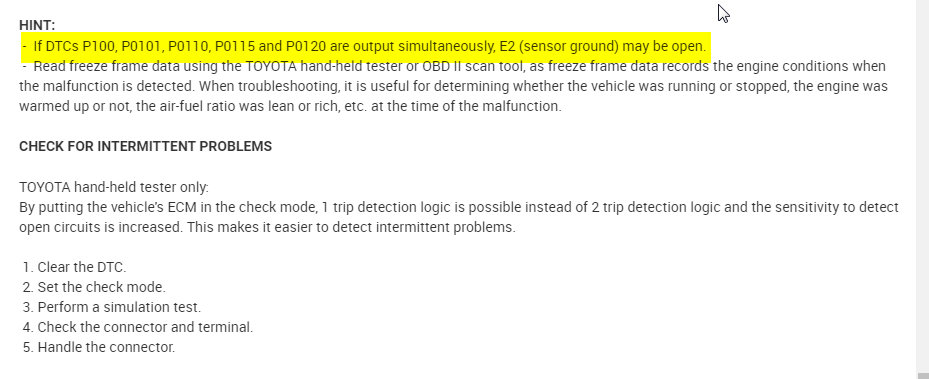

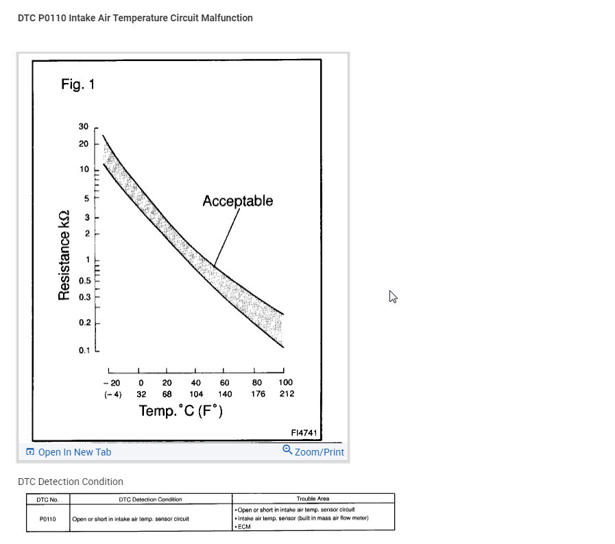

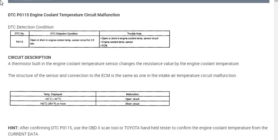

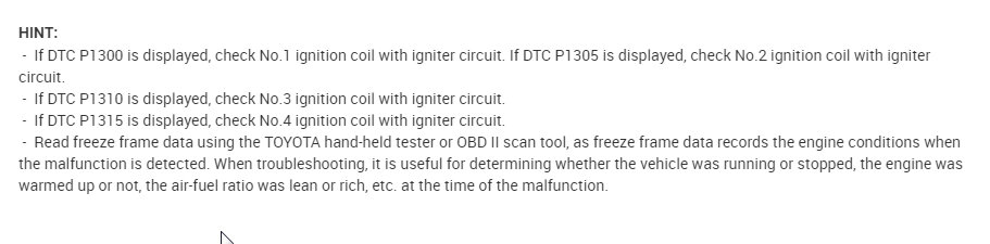

A few months ago I changed my car's PCM/ECU and soon after that the car started decelerating even when I pressed the gas pedal. On cleaning the mass air flow meter, this problem stopped. It started again a few weeks ago. And once i press the gas pedal once, it surges forward. But it only occurs after it had been parked for a long time and it doesn't occur again after 10 minutes of driving. Always the same pattern.Then I did a scan and these are the results:
P0110
P0115
P0135
P0155
P1300
P1315
The mechanic suggests i change my MAF and cold start valve but i don't want to take any steps before I get a second opinion.

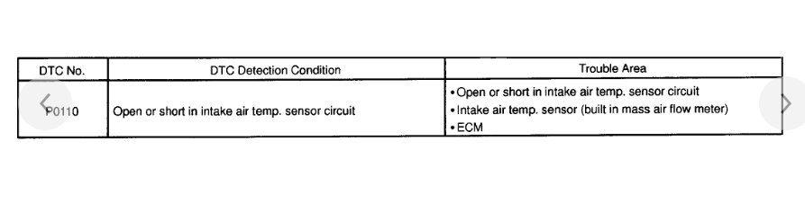

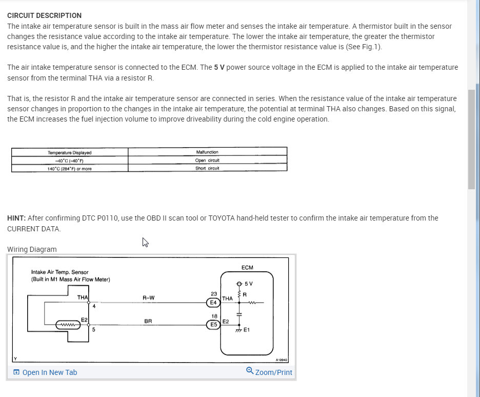

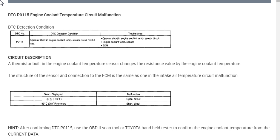

It is possible that you have an issue with the MAF sensor but I don't think that will solve all the issues. Plus take a look at the third attachment. I highlighted the important part. It states that if you have these additional codes then you have an open ground circuit. While you don't have all the codes it doesn't mean that this is still not the issue.
I don't see anything here that says it is not the MAF but I would need a little more convincing to think it will resolve all these codes.
I assume that he is going on the fact that cleaning the sensor fixed it last time so now it is just past cleaning and needs replaced. Again, not saying that is wrong but with this info, there could be a larger issue.

This doesn't sounds like a MAF sensor problem because these codes are all over the map. Can I ask why you changed the PCM out? It sounds like it is not correctly programmed for the car. Here is the instructions for how to do so in the diagrams below:

I would try clearing codes then just turn the key on to see what codes come up if none, start it for a second and check again.

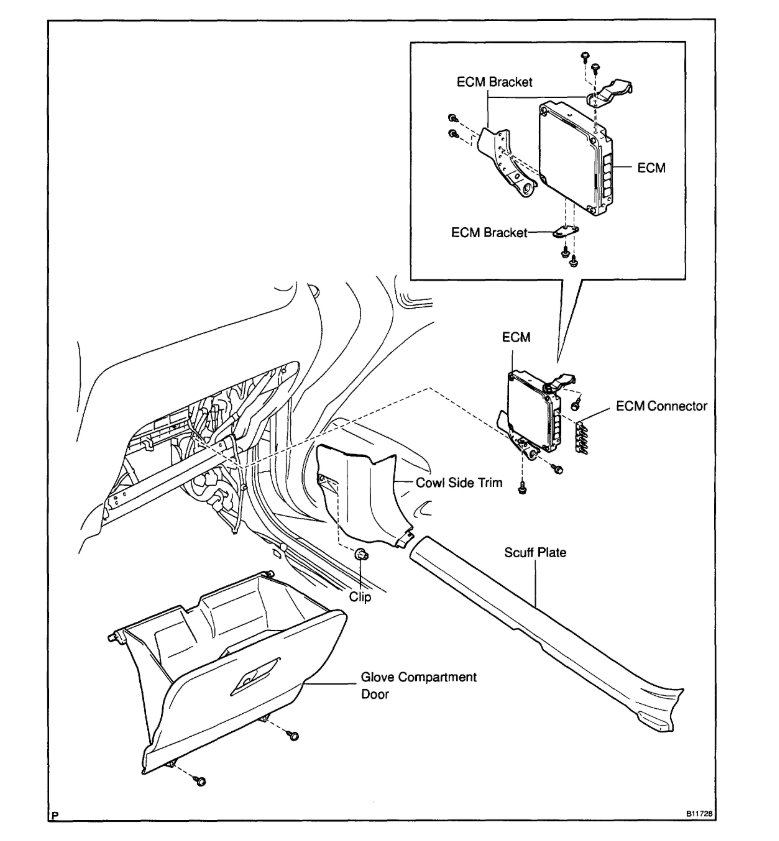

Also, I saw wire hanging loose from where the ECM is supposed to be located. It seemed paired with another wire. The symptoms improved. Is what I did safe?
Also the car exhibits this in the morning and when I have parked it for some hours. During the day it runs fine.

Ken has a good suggestion of clearing the codes and seeing what returns. There is a chance that some of them are old and could lead us down the wrong path. The fact that this happens when it is cold is an indicator that a sensor could be coated with dirt or other contamination and once it warms up it starts reading accurately. However, let's go with what Ken said and see what comes back when the vehicle acts up. That will give us a better idea as to what is happening. However, as Ken said, if these come back I doubt the one sensor is causing all these issues.
