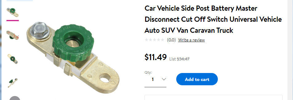

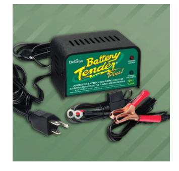

I have this car that I don’t drive a lot. However, I’ve been driving it once every couple of weeks for like 15-20 miles. Half of that has been on the highway. Recently I’ve been traveling and I’ve only driven once every 3 weeks. Should the car be okay? I know it’s not good for the battery but other than the battery maybe going bad, should it be okay?

To answer the question as best as possible, it should be fine for a while but I would suggest getting a battery tender. This is a small charger that you hook to the battery that will keep it properly charge. Or at the very least get a quick disconnect for the negative terminal. This will disconnect the electrical system and will not drain the battery. Then it is like the battery is just sitting on a shelf and will not drain as fast.
I attached pictures of these items. Clearly the charger is the best as the disconnect switch will require you to reset the radio and clock all the time.

If you think you might run into a problem, look into a solar-powered battery maintainer. You can find them at Harbor Freight Tools, Walmart, any auto parts store and at most hardware stores. They have to see the sun during the day, then they put a very small charge into the battery to make up for what the computers used. Most of these plug into the cigarette lighter socket, so they'll only work if that socket stays turned on when the ignition switch is off. Those lighter sockets go dead with the ignition switch off on a lot of import models. There are some models of battery maintainers that clip right to the battery's terminals. Those are a little more cumbersome and should be disconnected when you drive the car.
