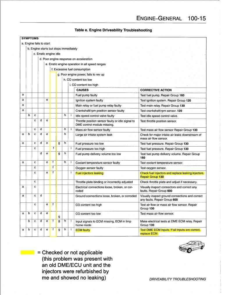

I am trying to do this because my car is getting about 11.34 miles per gallon instead of 35.8mpg.
I have changed the oil filter, air filter, cleaned and refurbished the fuel injectors with a Mr. Injector refurbishment kit and replaced the car's computer (DME unit) - though it was a used unit from Europe (and the problem was present with the old unit). I have not been able to check yet if there is a spark going to each spark plug.
On the number 1 cylinder, where the right hand bracket is that holds down the ignition coil, in the top corner of the bracket the screw hole in the engine block has no thread, leaving that bracket looser than it should be. I am wondering if that has anything to do with it.
Note: When refurbishing the injectors, I rigged up a circuit and switch (that also had a fuel injector plug attached) which I hooked up to my car battery that activated the injectors when I pressed the switch. When doing this I also forced carburetor cleaner through the injector to clean out any gunk. All injectors worked fine when activated and the spray became uniform in all of them.

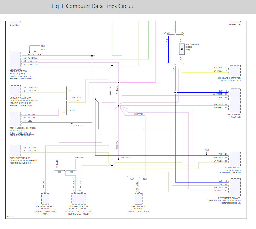

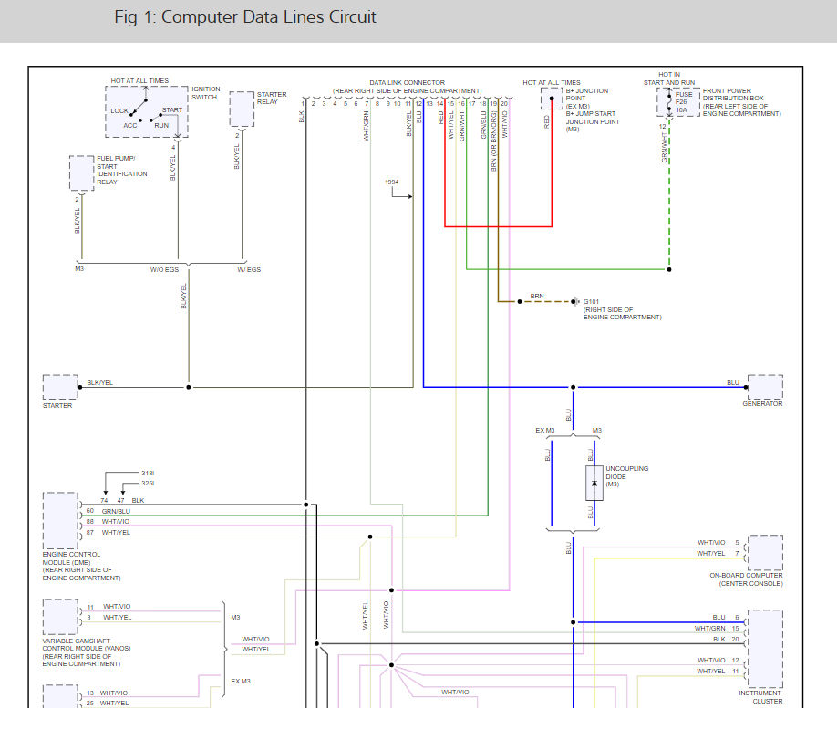

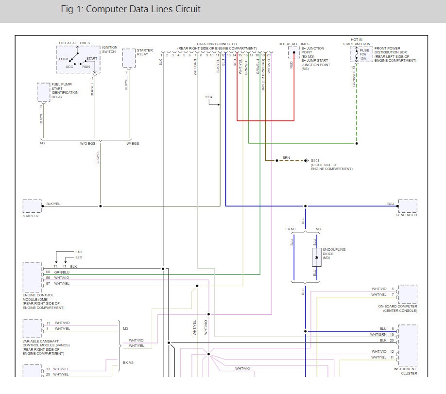

It sounds like you either have a ECU that is out or the wiring to the diagnostic connector is bad. here is a guide to help test the wiring with the connecting wiring diagram below so you can see how it works and which wires to test:

When you talk about a diagnostic connector are you talking about the OBD1 connector in the engine compartment on the right side near the strut tower? And how could a bad diagnostic connector cause my fuel consumption to increase so much?
As a note, I have gone ahead and ordered a new oxygen sensor. Also, I looked at the driveability section of the Bentley manual and it had some indicators as to what I need to look for.

We need the connector under the hood to work so we can get the codes if any. Do you have the tools to get the codes? BMW takes a special tool or this guide can help:
https://www.2carpros.com/articles/bmw-obd1-1995-and-earlier-code-definitions-and-retrieval-procedure
