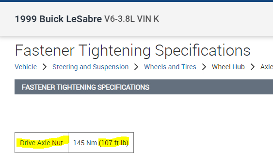

In the specs I have in this Chilton Manual for 1985-05 Buick, Oldsmobile, Pontiac, front wheel drive they only call for 118-foot pounds torque on the drive axle nuts of 118 ft lbs for 1998 and later whereas for 85-90 it is 180. In 1991 it calls for 192. Those are the years with the highest foot pounds on that hub nut. Could they be wrong? I ask sincerely.

A couple of months ago I would have said the 118 foot pounds was wrong, but in fact, I did run across one model that was listed that low. That really surprised me. The better alternative is to go by what is specified on the instruction sheet that comes with the new bearing assembly. Typically they will call for the same as for the original dealership bearing, but sometimes an aftermarket supplier will have one already in production for other models that will work on a newer one that calls for a lower value. In that case you have to go by what the bearing needs, not what the manufacturer specified for that model year.

I felt the need to jump in too. LOL The axle nut torque specs for your vehicle is 107 ft lbs. I looked several times and didn't notice that mentioned. (see pic below).
Next, it may be the bearing itself that is faulty. So many parts are coming from overseas. If I had a nickel for every faulty aftermarket part I've gotten, I would be rich!
Also, unless the camber is seriously out, I don't feel it would do this. Even then I would question it.
Take care and let us know.
See pic below.

Thank you very much. I appreciate your input also, it's very important to me.
