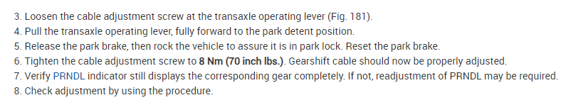

Does not go into park keeps rolling. I suspect the drive line.

Not going into park is likely a linkage related issue. Do the other gear selections work as designed?
As far as the noise, it could be coming from worn brake pads, a faulty axle bearing, or even a bent or rusted dust cover behind the brake rotor.
When you hear the noise, does it seem to make a clicking sound? When driving straight, do you notice any noise?

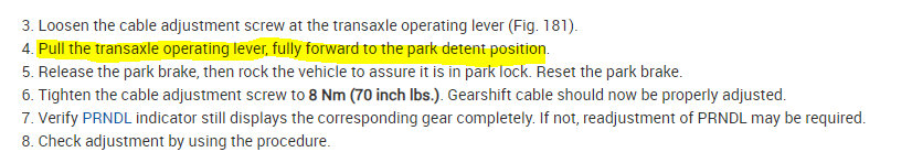

I attached the directions for adjusting the shift cable below. Take a look through it and let me know if you are comfortable performing them. Also, take a look through this link and let me know if anything mirrors what you see/hear:
