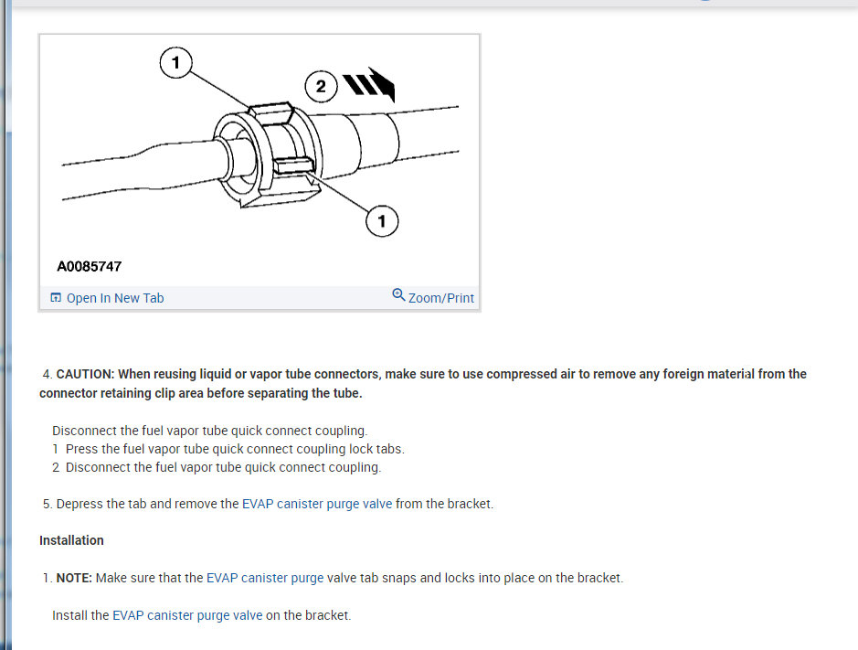

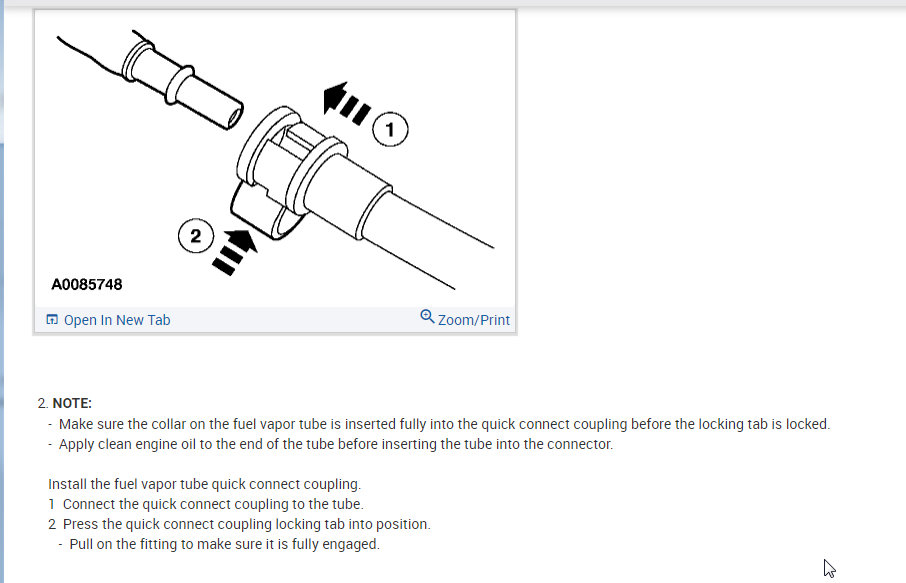

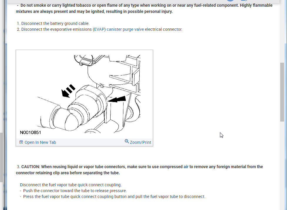

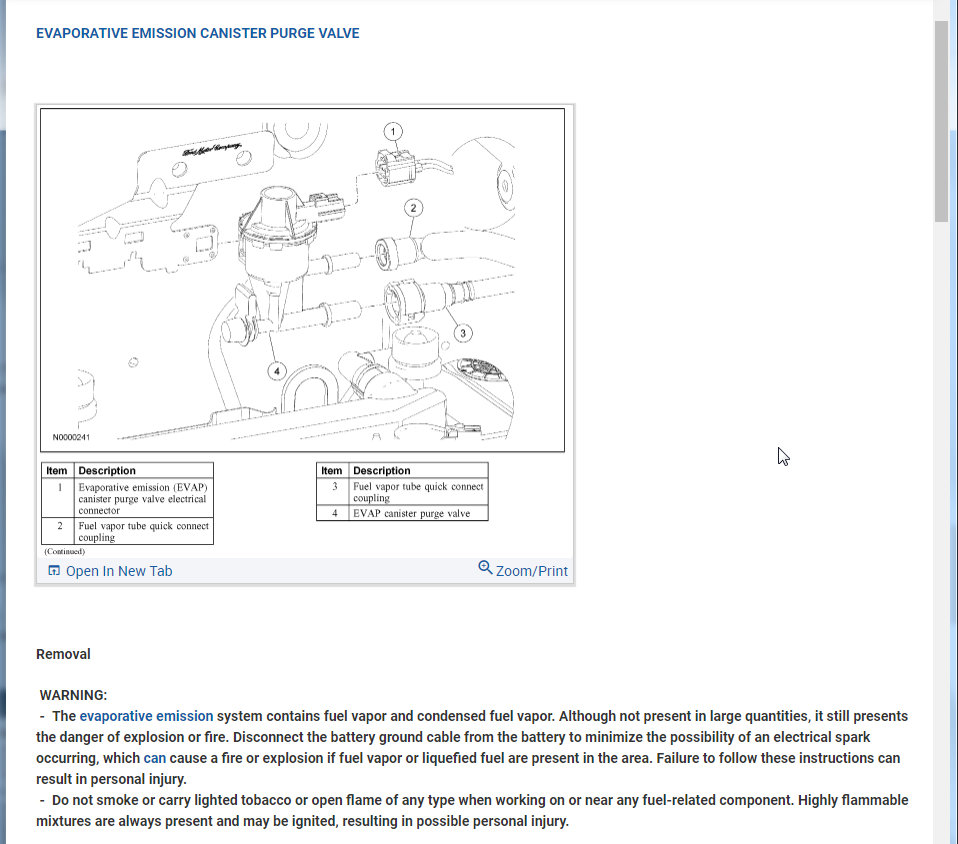

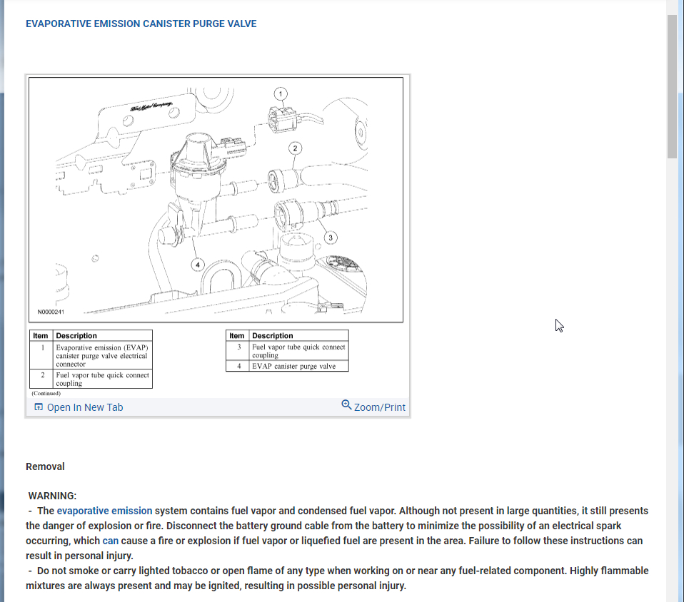

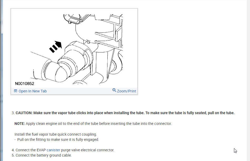

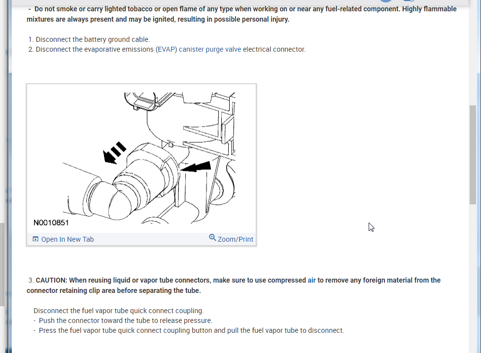

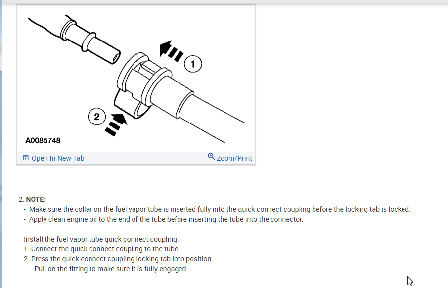

Okay That is great info. I highly expect the EVAP purge solenoid is failed. This would indicate why it runs better when the fuel level is different.
This sticks at times and will cause all sorts of engine running issues. Basically when it sticks open it floods the engine and it will cause these types of issues.
I attached the process below to replace this. I would also inspect the charcoal canister for raw fuel in it. If you hear fuel in it then I would replace that as well.
