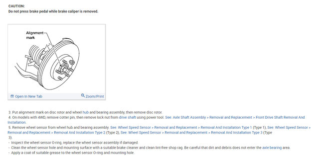

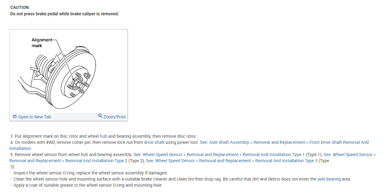

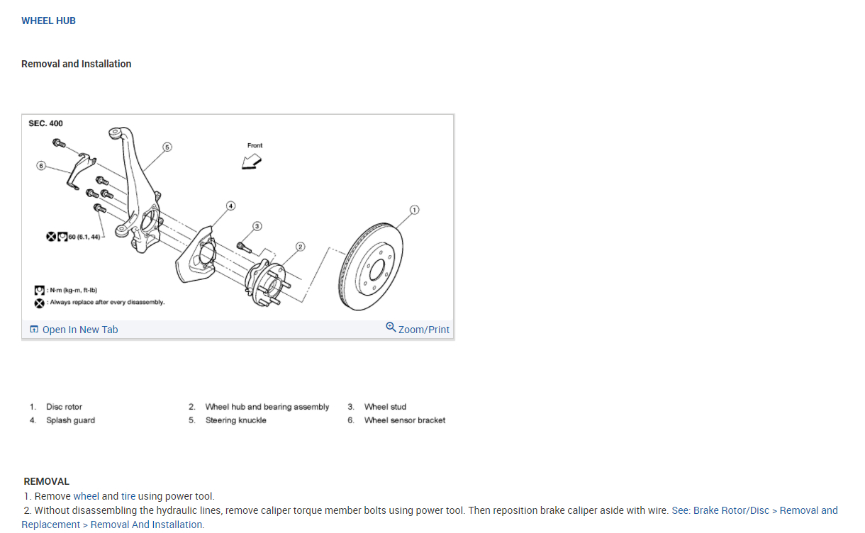

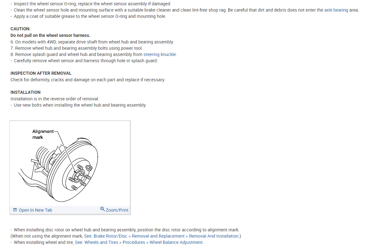

I attached the procedure for you for the repair.
https://www.2carpros.com/articles/bearing-hub-replacement
You are going to need airpower for the retaining nut for the bearing and a torque wrench for tightening it back up.
