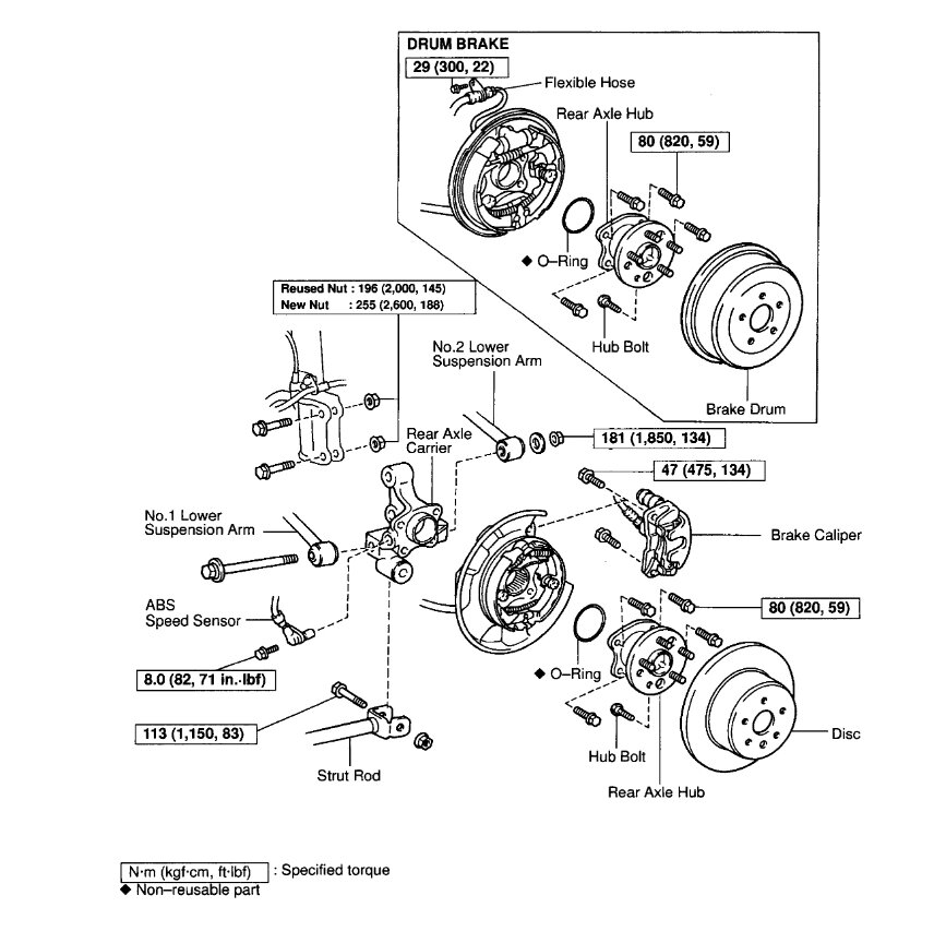

I notice a sound coming from the rear of car. When I make a left turb, also when I drive straight at a low speed. It sounds like woMP woMP, and little bit of grinding. Is it the wheel bearings, tires, struts, help!

Check for bad wheel bearings in rear

I agree with HMAC300, it sounds like a rear wheel bearing, here is how to change it out, check out the images (below). Please upload pictures or videos in your response of any problems so we can see what to help you with.
