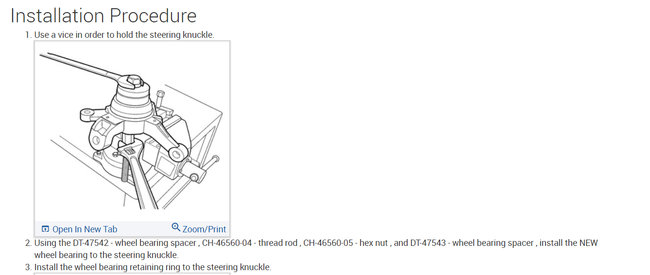

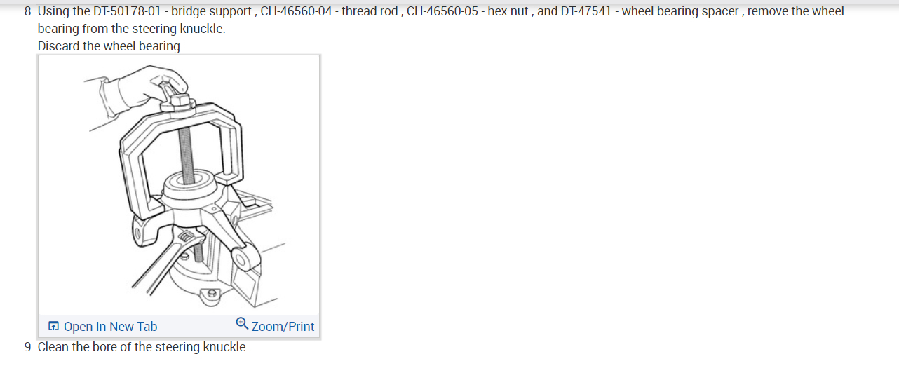

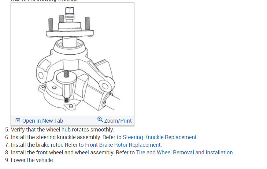

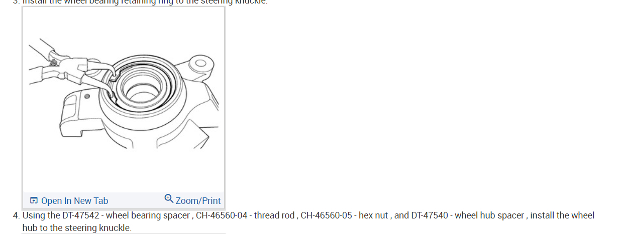

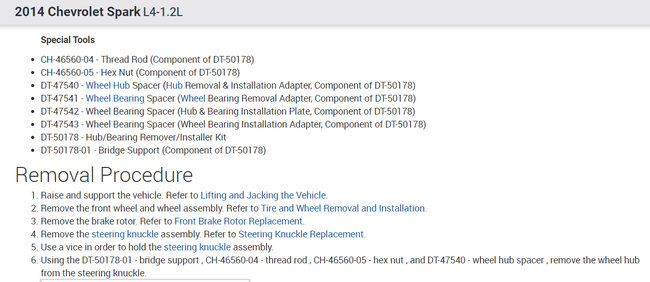

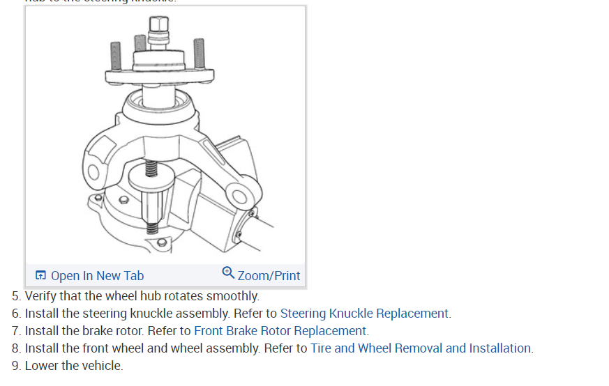

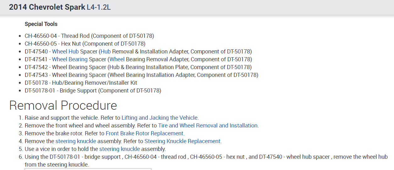

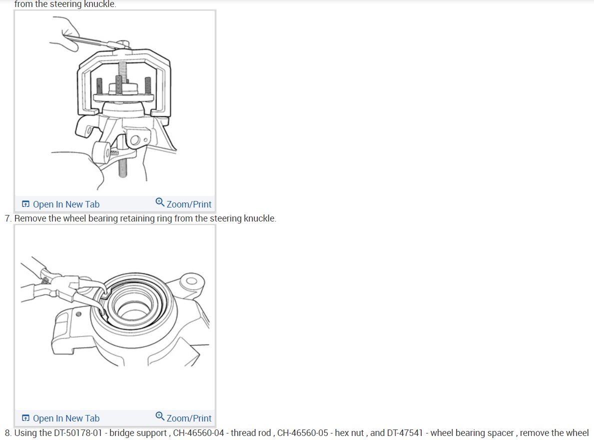

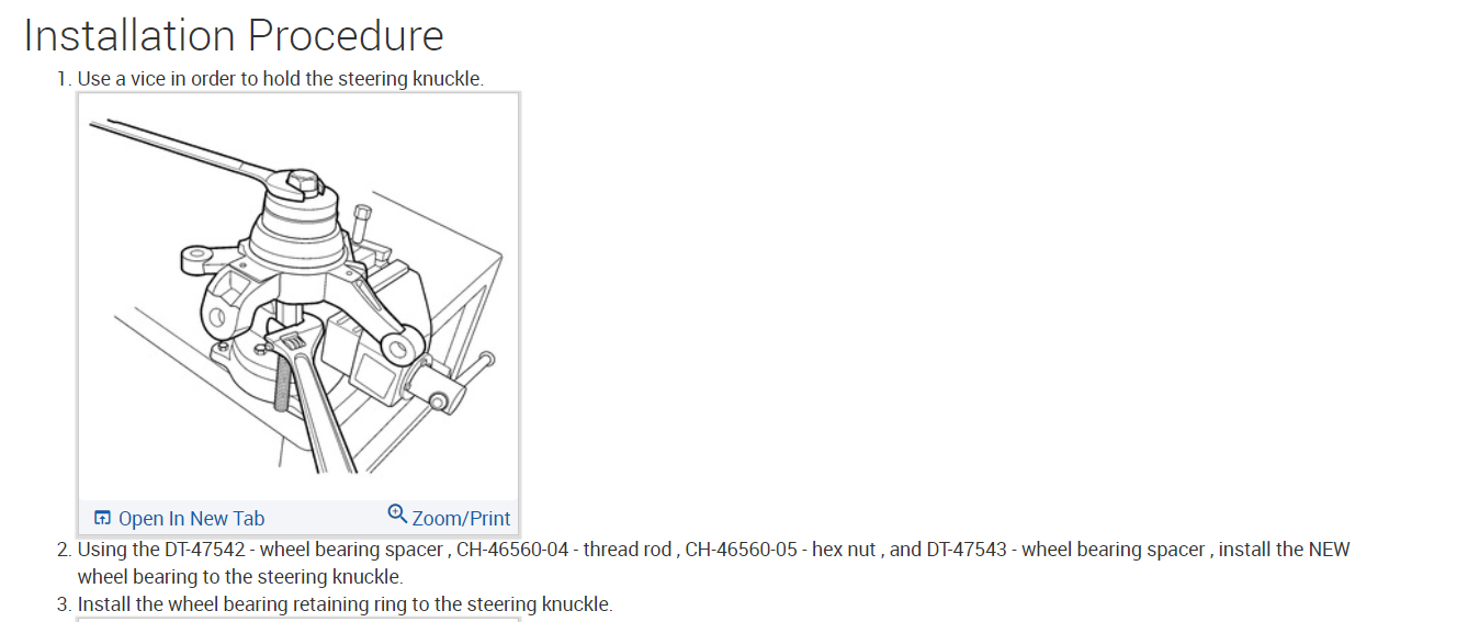

When going down the road gently push the steering wheel a little right, then a little left to see if the sound changes. If so I would replace both front bearing hubs which is common. here is how the job is done in the diagrams below. Check out the diagrams (below). Let us know what happens and please upload pictures or videos of the problem.
