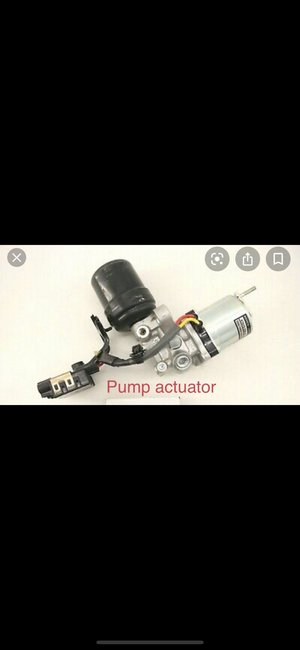

Noise from ABS actuator pump
2012 TOYOTA CAMRY HYBRID
120,000 MILES • 2.5L • 4 CYL • 2WD • AUTOMATIC
BEBOBEBO
  • 116 POSTS

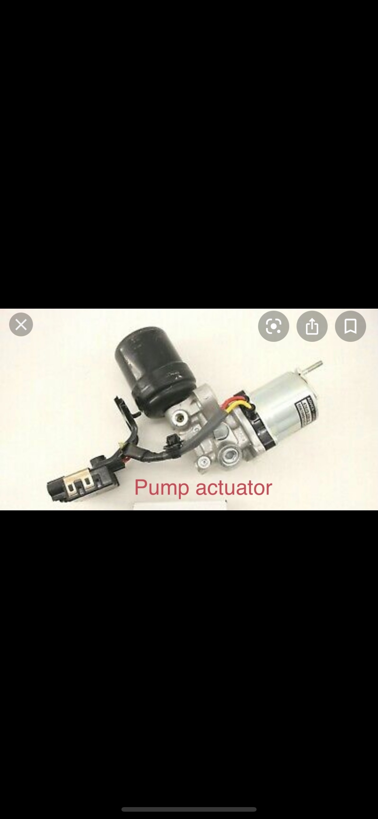

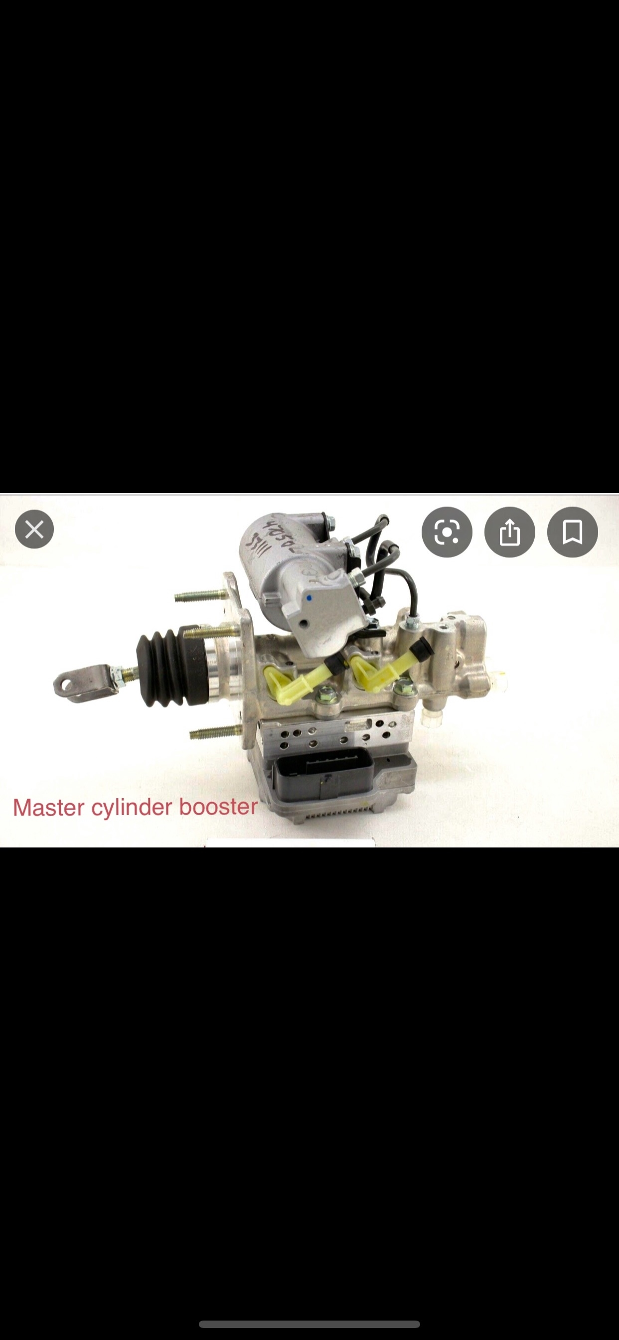

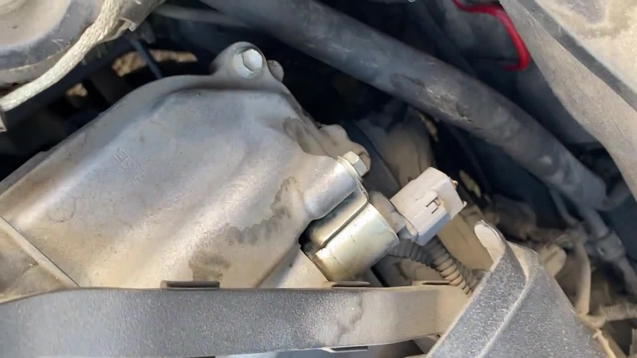

I had the mechanic who do an ABS actuator pump and master cylinder brake booster replacement with a used parts . Now every time I drive the car i can hear it intermittently and when turn it off, the car basically screams. It’s a lot louder than it was before. i noticed the sound come from the right side of hood from the actuator pump location, not from brake booster master cylinder. nor any problem in car performance , nor any ABS dash light , and brake is okay.
What to do ? Is the problem from pump or the master cylinder? Should i replace and change the pump?
Any solution?
Thanks

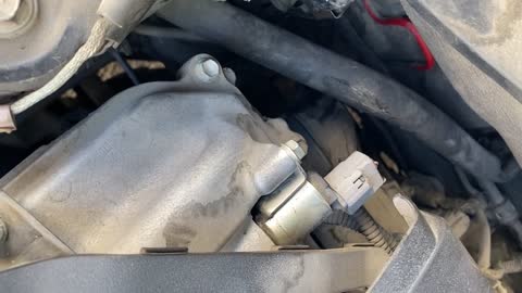

Is it possible for you to record the sound and upload it for me to hear? It may be the pump itself that is bad.
Oct 6, 2020 at 2:11 PM
BEBOBEBO
  • 116 POSTS
Yes, this is the sound down. it happen more frequent than before and louder with mainly every other time when i press brake pedal.
Oct 7, 2020 at 6:35 AM
  • 110,194 POSTS
It sounds like the pump itself may be going bad or just may be louder than your old one. However, it is louder than one would expect. Is there any warranty on the work that was done? Other than the noise, are the brakes working properly?
I don't know if replacing it is something you would like to do, but here are the directions for removal and replacement. Note that even a new pump may be louder than the original one.

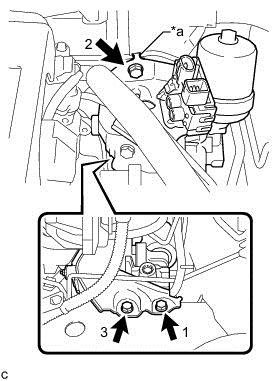

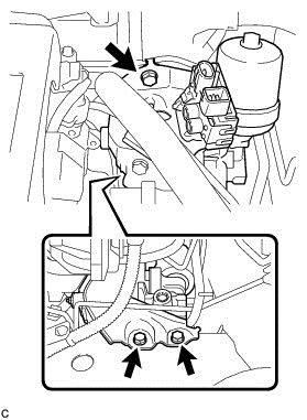

18. REMOVE BRAKE BOOSTER PUMP ASSEMBLY WITH BRACKET
(a)Disconnect the 2 connectors from the brake booster pump assembly.
pic 6

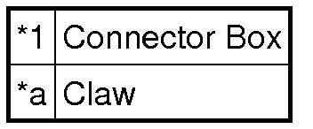

(b)Remove the bolt and separate the connector box of the brake booster pump assembly from the brake actuator bracket assembly.
pic 7
Text in Illustration
pic 8
(c)Remove the 3 bolts and brake booster pump assembly with bracket from the vehicle body.
pic 9

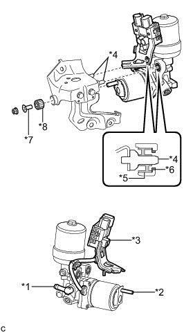

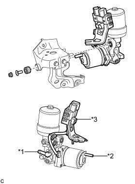

20. REMOVE BRAKE BOOSTER PUMP ASSEMBLY
(a)Disengage the wire harness clamp from the brake actuator bracket assembly.
pic 11

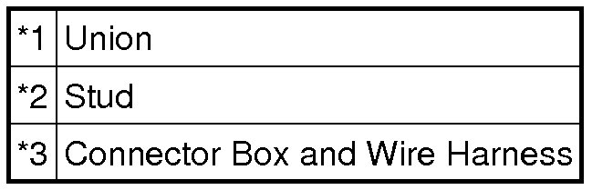

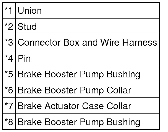

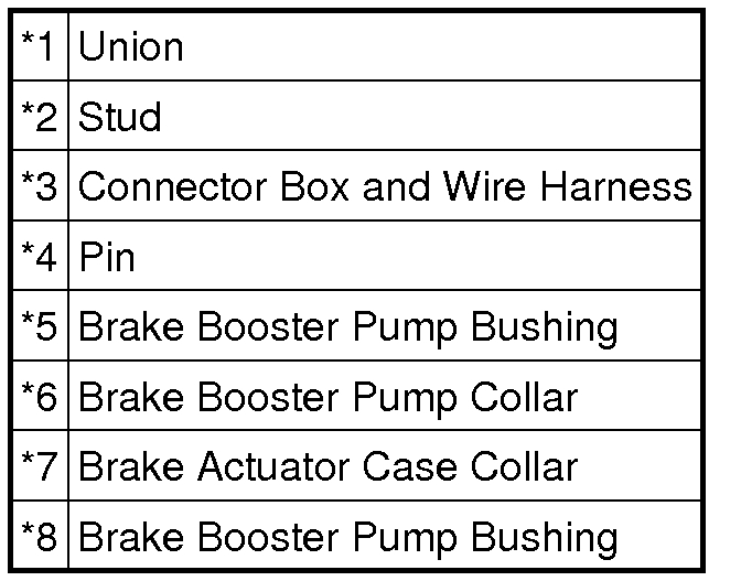

(b)Remove the nut, brake actuator case collar, brake booster pump bushing and brake booster pump assembly from the brake actuator bracket assembly.
pic 12
pic 13

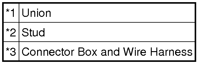

NOTICE:
* Do not carry the brake booster pump assembly by the parts shown in bold (*1, *2 and *3) in the illustration.
* Do not drop the brake booster pump assembly when carrying it.
* Be careful not to allow any brake fluid to enter the connector.

1. INSTALL BRAKE BOOSTER PUMP ASSEMBLY
(a)Insert the stud of the brake booster pump assembly to the hole of the brake actuator bracket assembly, and insert the 2 pins of the brake actuator bracket assembly to the 2 brake booster pump bushings (*5).
pic 14
pic 15
NOTICE:
* When installing the brake booster pump assembly to the brake actuator bracket assembly, confirm that the 2 brake booster pump collars (*6) and 2 brake booster pump bushings (*5) are installed on the brake booster pump assembly.
* Do not remove the hole plugs before installing a new brake booster pump assembly because the brake booster pump assembly is filled with brake fluid.
(b)Install the brake actuator case collar (*7), brake booster pump bushing (*8) and brake booster pump assembly to the brake actuator bracket assembly with the nut.
Torque : 5.4 Nm (55 kgf-cm, 48 in-lbf)
