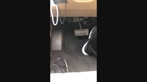

There’s a continuous noise that’s coming from my car which begins at a speed of around 25-30 MPH and gets louder as my speed increases. You only hear the noise when the vehicle is moving, and it goes down when you slow down to below 20 MPH. I inspected the rear of the tires to make sure nothing was touching and had the tires rotated and aligned? There isn’t anything that changes the sound’s pitch. For example, when applying the brakes, it doesn’t change? I the mechanic who replaced the new rack and pinion said that he bled it, when it was installed but I am not sure. The sound is not metallic or a sound like something is loose but rather a continuous noise.

Yes, the noise is coming from the front. The noise only comes when I press the gas pedal and the noise stays when I get my foot off the gas until speeds of 25 miles per hour. And then the noise slowly goes away at low speeds.
I had uploaded a video file using my mobile phone. I might have to do it from a computer later.

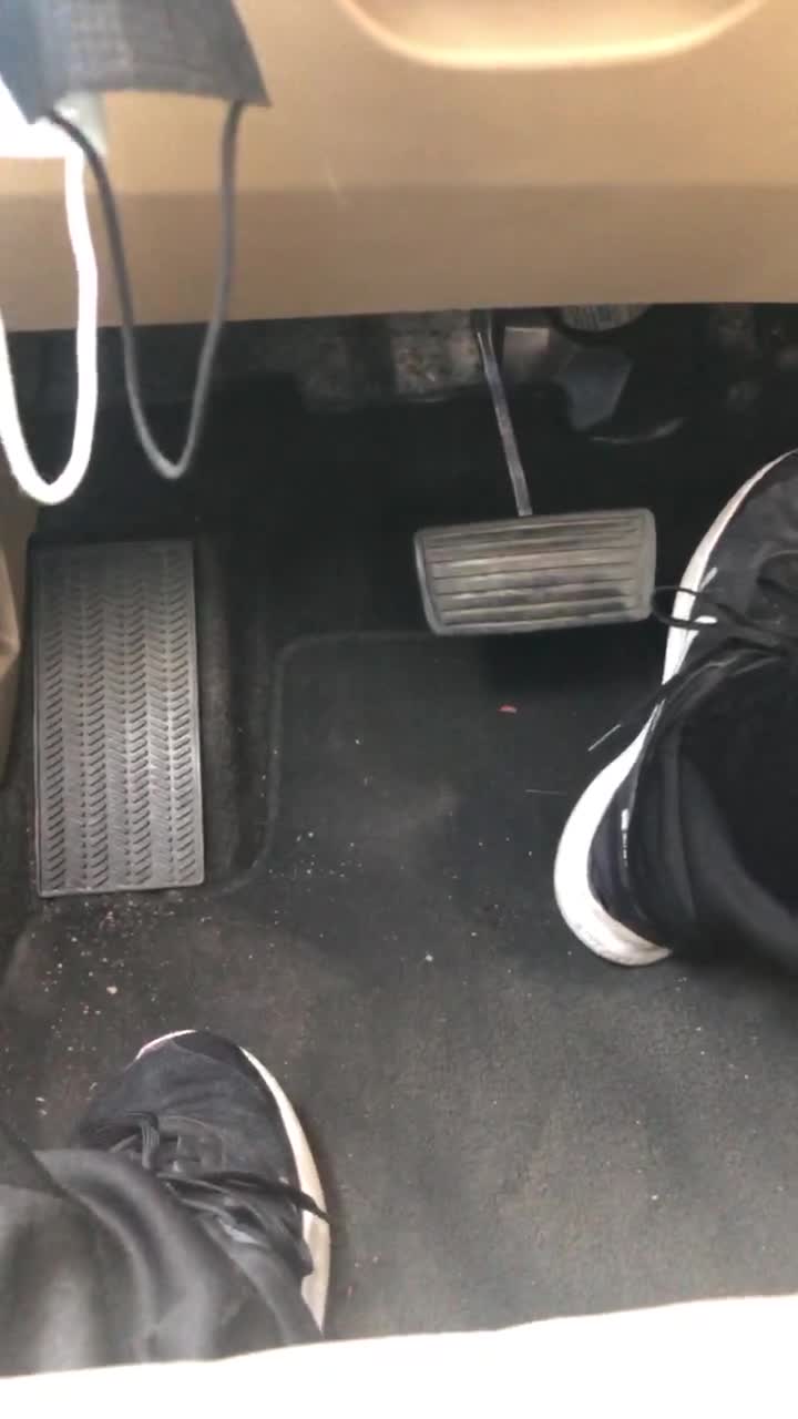

This is the video.

Thanks for the video it helps, it sounds like one of the engine mount/cradle bolts is not in or loose allowing the engine to lay over onto the frame or brace. I would put the car on a rack or jack it up and use a flashlight to see if you can detect the problem. There should be clearance around the engine.
This guide can help:
Let me know what you find.
