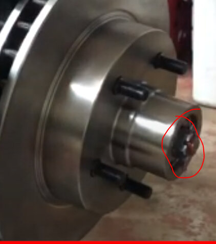

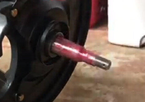

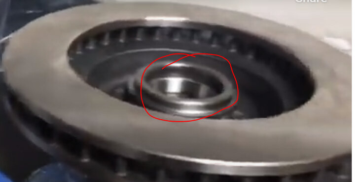

As far as adjustment, i attached three pics below. The first shows the rear of the rotor hub with a bearing. There is an outer bearing as well. Pic 2 shows the spindle. The last pic shows the spindle with the hub installed. I circled the hub nut that is used to adjust the bearing.

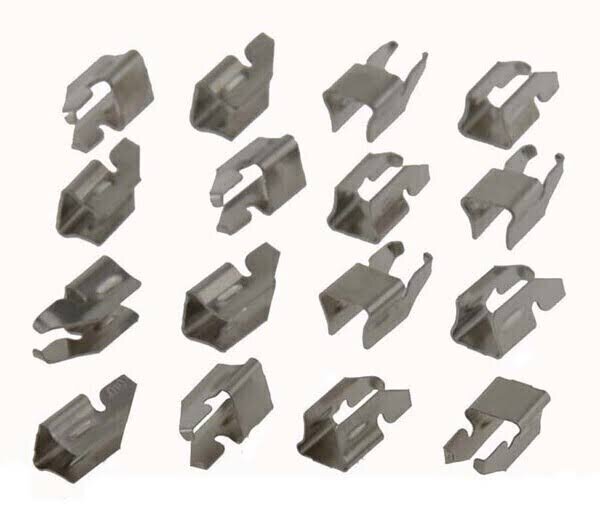

One thing I saw, but it may not factor was those little brake pad clips that go on edge of each pad's ends were not on tops of pads but were on bottoms. does not having those st top of both pads ? factor it?

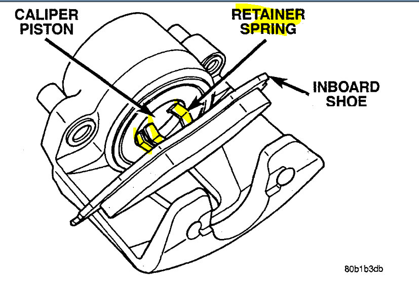

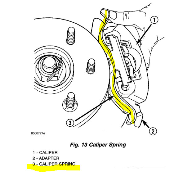

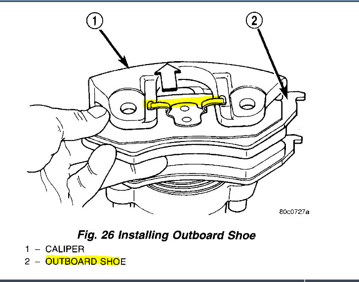

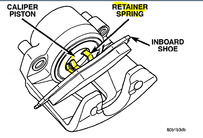

There really shouldn't be hardware clips at the end of the pads. The rear pad has a push-in retainer spring, the outer pad has a clip that holds the pad to the caliper, and there is a caliper spring that holds things tight to eliminate noise. See pics below.
Is it possible for you to take a few pics and upload them for me? I need to see what you are referring to. I've owned Dakotas since 1989 and never remember using the thin, tin hardware on them. I always used what is shown in the pics.
Additionally, I need to see what type of bearing you have just to confirm. Because of where I live, I have always had 4wd trucks. I need to see the bearing you are dealing with. If, however, you had to install an inner and outer bearing and wheel seals, it should be adjustable. I just want to confirm.

I'm talking these little ones.
May 1, 2023 at 2:06 PM
HIDDEN4321
  • 62 POSTS
I'm talking these little ones. do they not need to be on both ends of each pad?
some of mine at top are missing.
May 1, 2023 at 2:08 PM
  • 110,240 POSTS
They don't even show them in the manual, so I would say it is fine. They are rattle clips. Remove them but don't get rid of them until we confirm the sound is gone. Maybe it is the brand brakes you got that require them.
