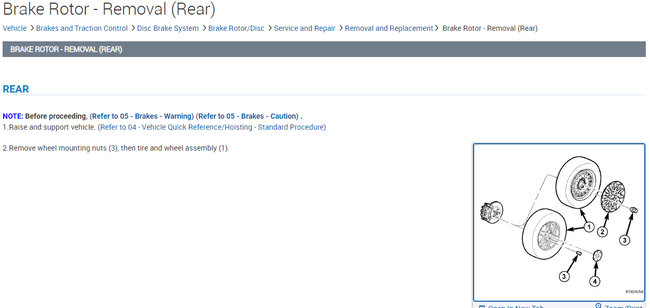

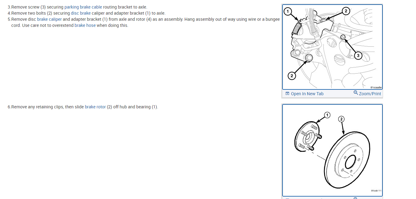

My hub snapped on my rear passenger side and wheel came off while I was driving. I had it replaced and it drove smoothly for awhile. It’s a secondary vehicle so it’s not driven often. Last week I intermittently heard a severe sounding rubbing sound. I replaced the wheel today and still hear it. It gets loudest when I brake but it’s not every time I brake.

We can help with that, it sounds like your rear dust plate has a issue, will need to inspect for possible touching when braking, see link below .
inspect that inner brake pad is in the piston grove.
