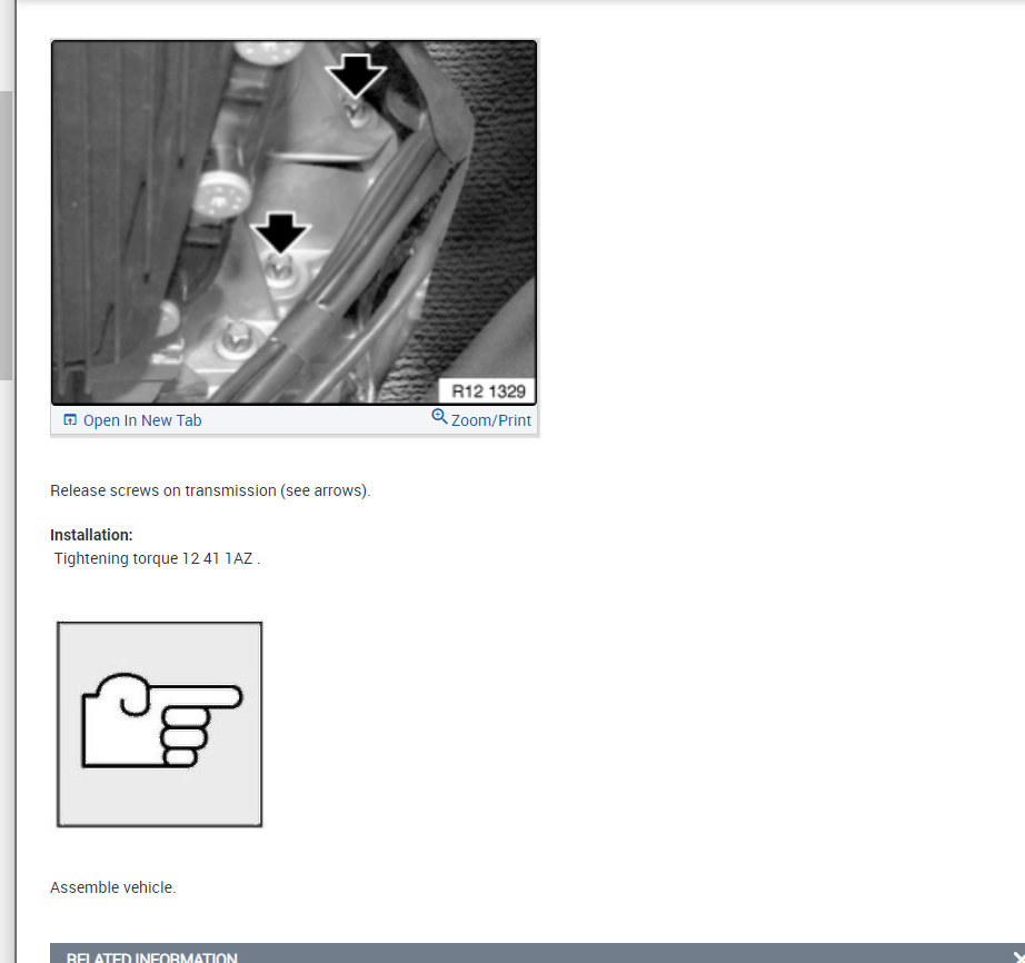

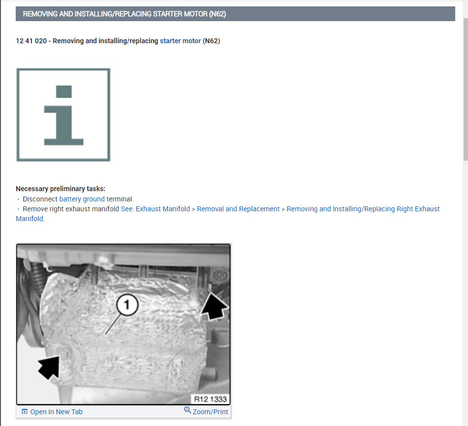

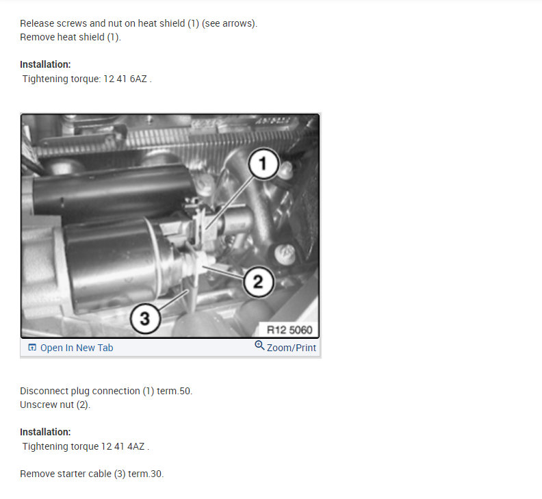

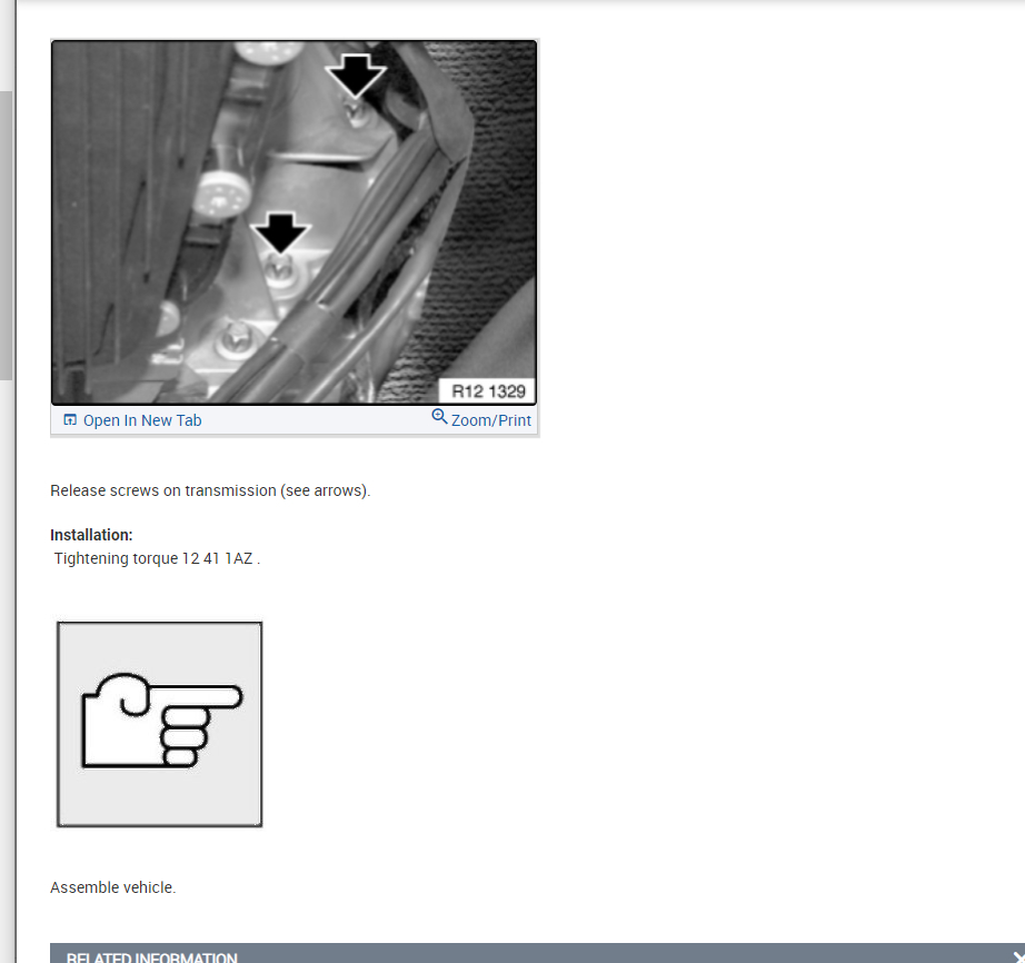

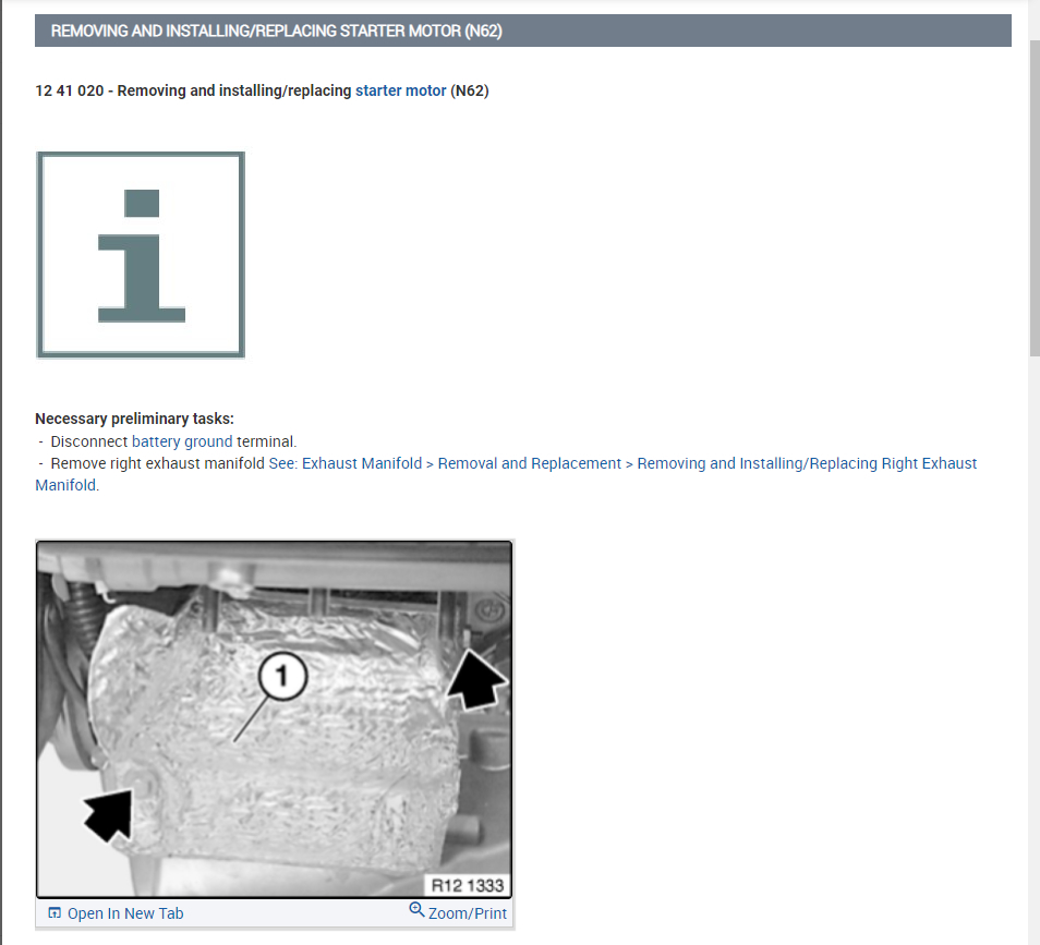

Here are some guides that will help with this issue as it seems like the starter needs to be replaced:
https://youtu.be/5Jd2-wfIKOw
Unfortunately it is not possible to put a remote starter on this vehicle. It is not possible because you need access to the crankshaft and the only place to install a starter like this would be in the current location.
Below is the process from the manual for your review. Please let us know if you have other questions. Thanks

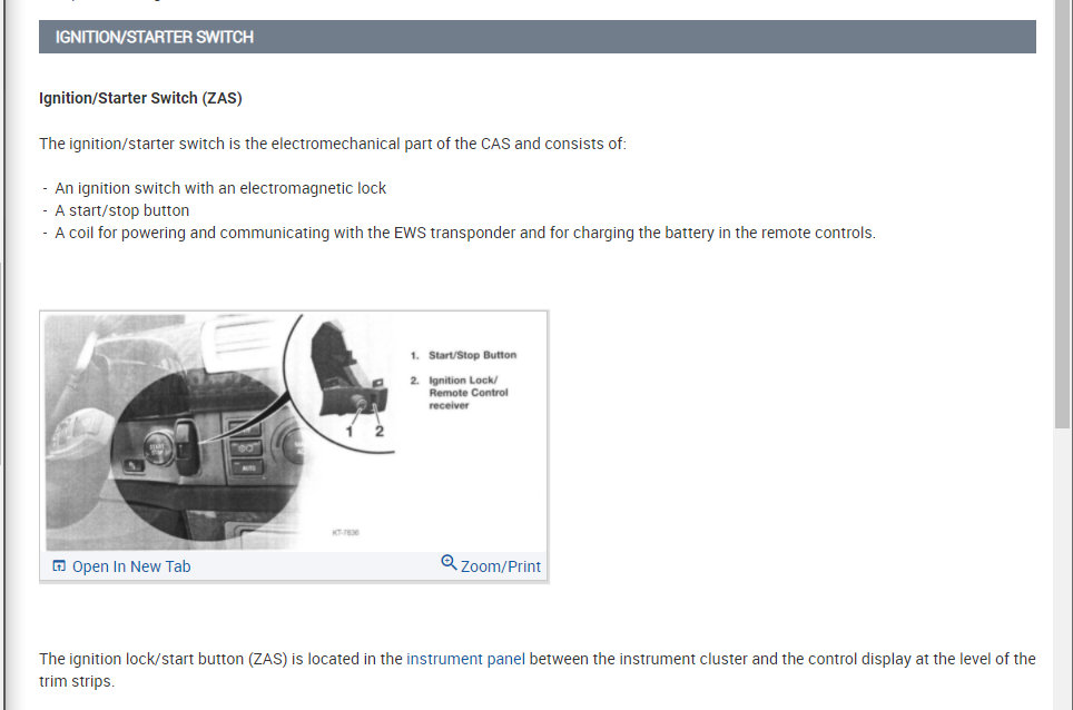

I want to bypass the push button start and wire in my own remote start button.
Monday, June 14th, 2021 AT 5:54 AM
Unfortunately I don't think this is possible. The reason is, the ignition switch contains what is called the EWS transponder. This is basically the module that tells the PCM that a valid key was used to start the engine and that it is okay to start.
So if you bypass the push button then you are bypassing this as well and it will not tell the PCM that it is okay to start and the engine will not start. I attached the info on this below.
Monday, June 14th, 2021 AT 8:22 PM

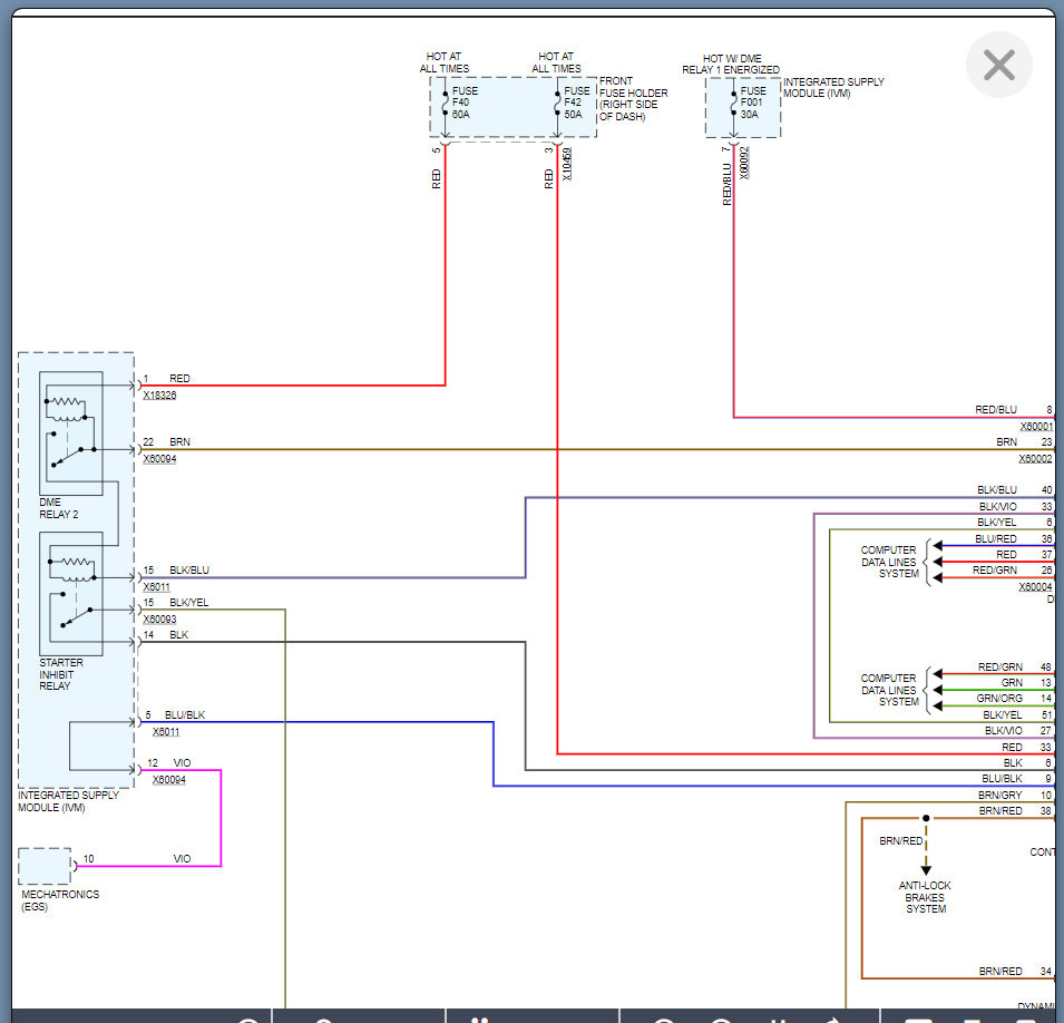

Okay. Does this click and not start happen every time now? If so, can you get a video of this happening?
Also, can you put your finger on the relays that you hear the clicking coming from to find out which one is clicking? I am thinking it is the inhibit relay but if we can prove which one then I would start with changing that out as a failed relay could cause all sorts of different issues.
