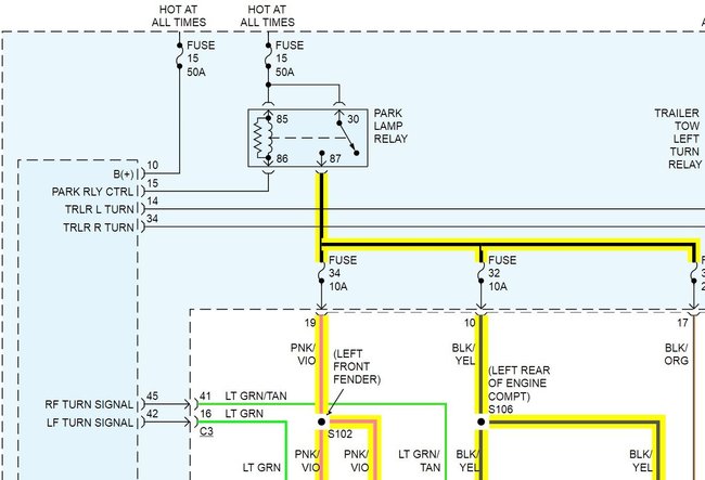

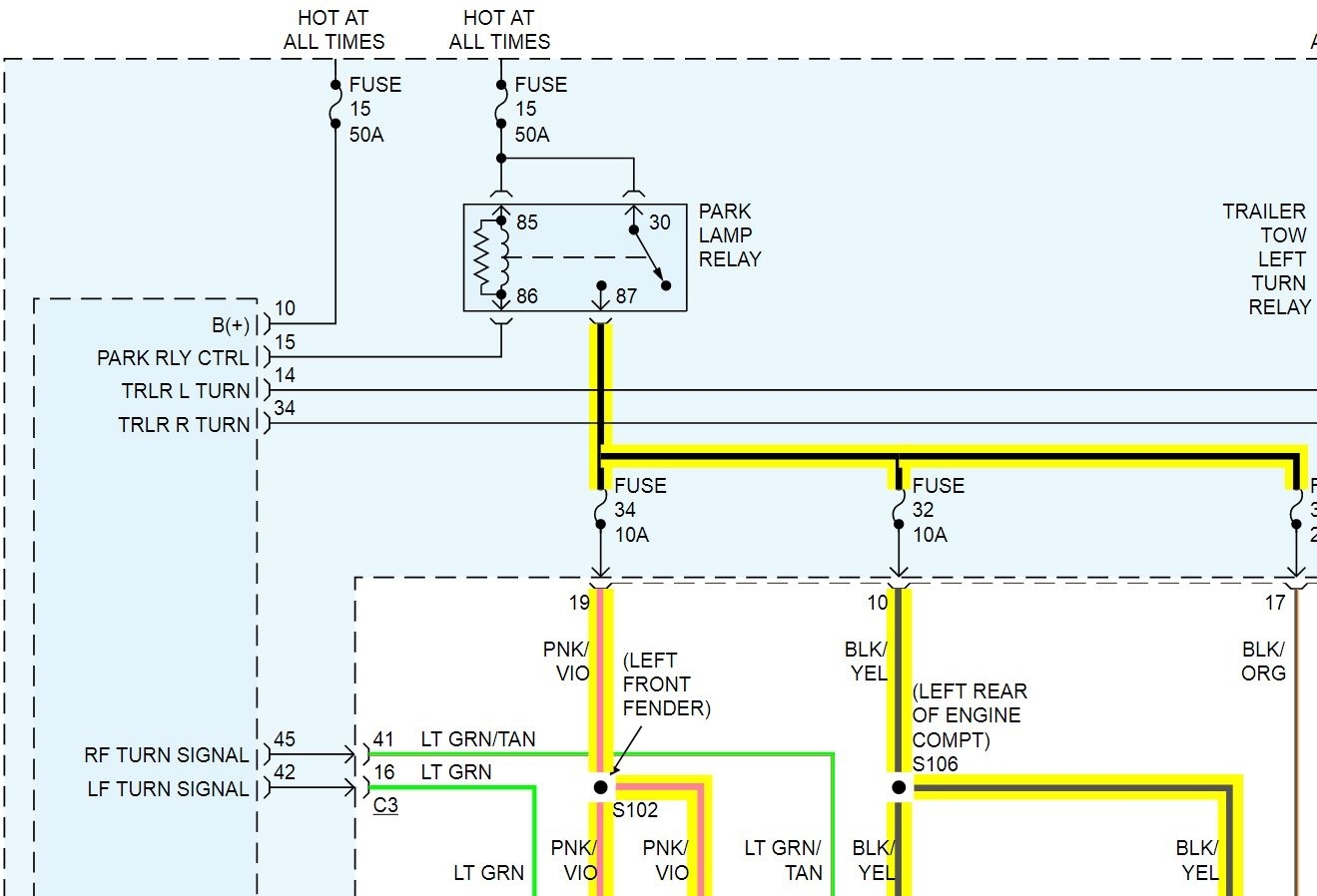

It looks like they never returned to say if it was repaired or what was done. You have the same issue where you have no driving or marker lights and no plate lamps but all the rest work including the brake and back-up lights? They get power from the park lamp relay through the fuses and from there to the front and rear parking lamps. If the front parking lights both work the relay and both fuses are okay
When you step on the brakes or turn on the hazard lights do the plate or front marker lights glow even a tiny amount? A quick way to test if the rear light ground is an issue would be to pull one of the tail or plate lamps out, the Black wire is the ground for all of them. If you take a jumper wire from the black wire to a known good ground and the lights work, the ground is bad.

Okay, if jumping the relay on makes them work then the issue is either in the forward control module (Body Control Module to everyone but Chrysler) or the integrated power module (fuse box) Those ate connected using the internal traces in the fuse box and the connector to the FCM that is bolted to the box using pin 15. No external wiring. Testing which is the issue would be to remove the FCM from the side of the fuse box and then simply grounding pin 15, if the relay triggers the FCM is the problem, if it doesn't then the traces or connector for the relay is the issue.

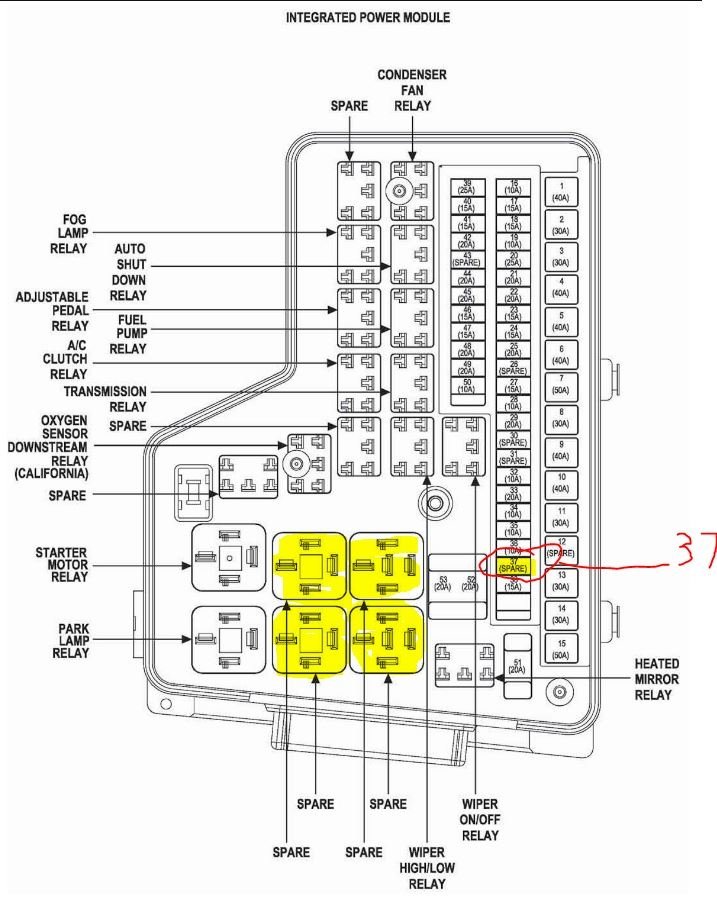

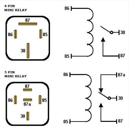

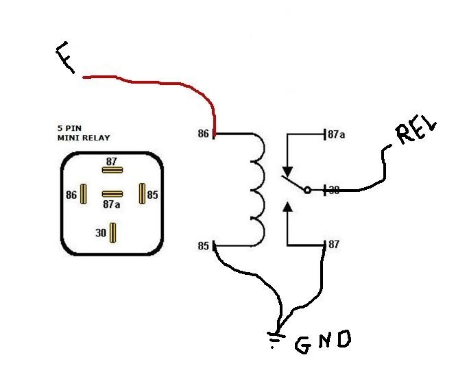

If you don't mind a bit of a fudge you could connect in a relay that would turn on and off with the key as a replacement for the jumper wire. That would take a common relay and some wire connected to a spot in the fuse box that is hot in run, it would also act like DRLs as the parking lights would all be on while the engine was running and only go off when you shut the key off. The third image shows that relay. A common 4 or 5 pin will work, there should be a couple that are spares in that box already if you don't have the OEM towing package. Fuse 37 is marked as a spare fuse that is hot in run. It would connect to the relay on the 86 terminal. The two grounds on terminals 85 and 87 would go to a good ground, I've used the same screw or bolt I mount the relay with and a ring terminal for that, as long as it's a good ground. The lead marked rel on terminal 30 would then replace the wire you are currently using on the relay in the box. In operation the lights would come on when the switch was in the run position. They should be off in Off, Acc and start.
To verify that fuse 37 is actually wired the way the diagram shows I would use a test light to make sure it has power with the key on but none in off. The 4 and 5 pin relays are wired the same way, you would just ignore terminal 87A.
