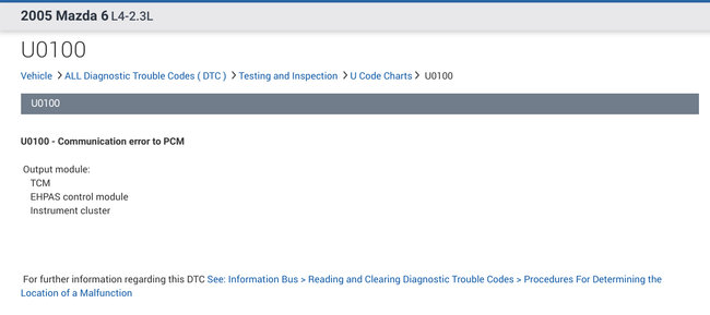

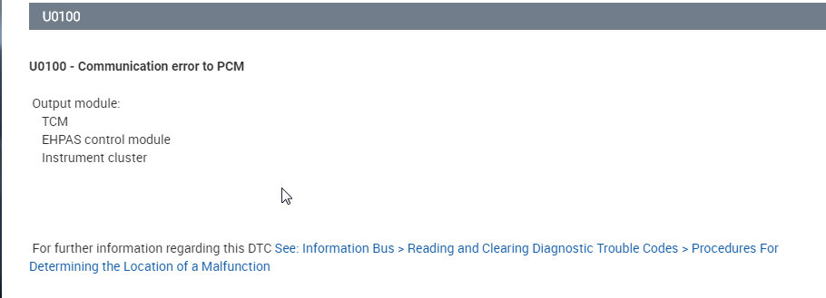

I attached code reader got one code U0100 lost communication with ECM/PCM A
I went immediately checked my ECM wire under hood near fuse box and it fine no burn nothing just crusty gel substance.

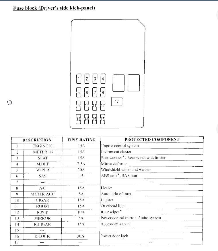

I then tested fuse have no clue it going this right but had key in on position and got read from the fuses except the:
*Injector fuse
*Engine bar fuse
ECM fuse under car on driver side nothing works in the fuse box on driver side just to note but again in not sure if i'm using multi-meter correctly.

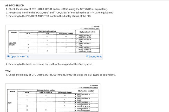

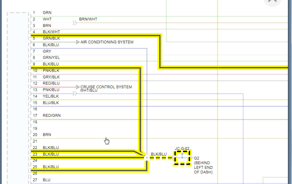

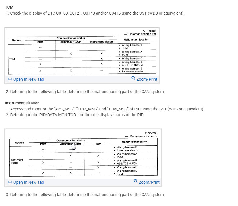

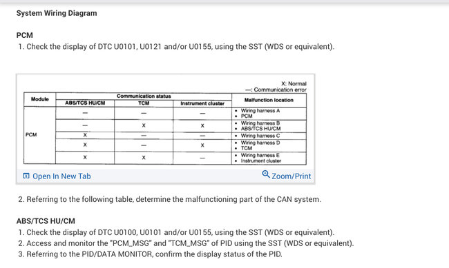

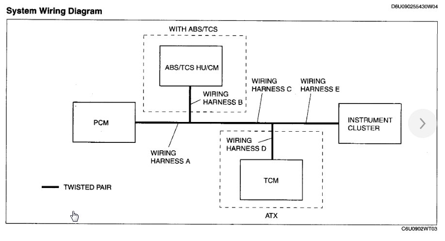

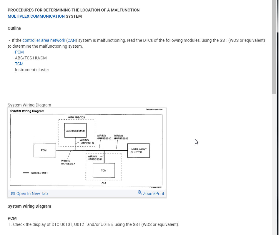

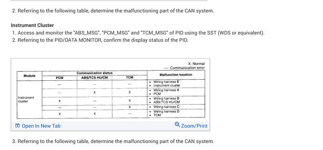

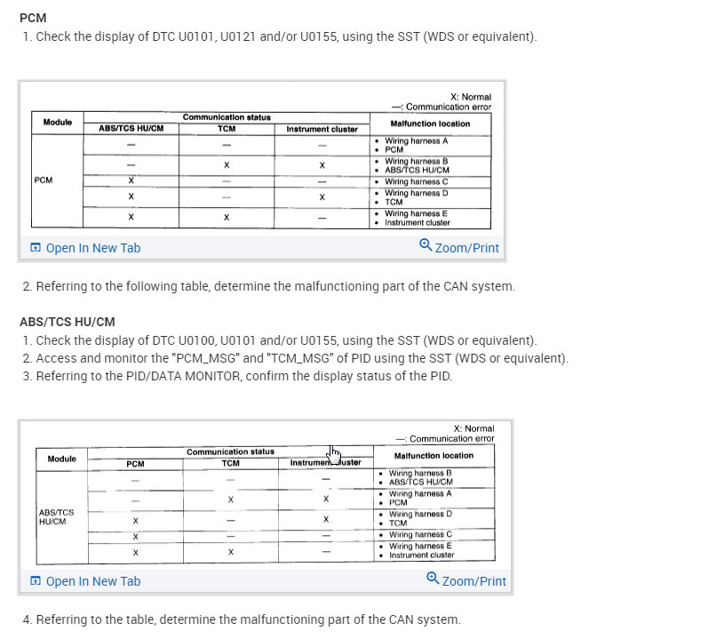

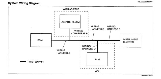

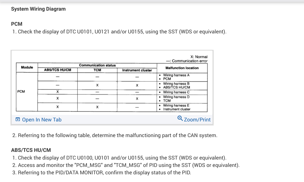

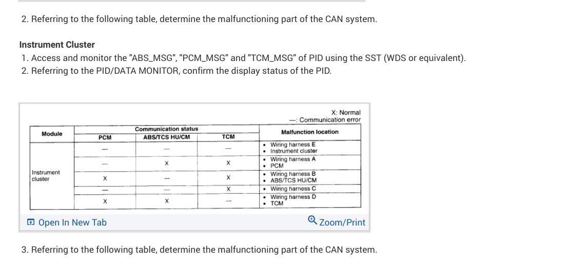

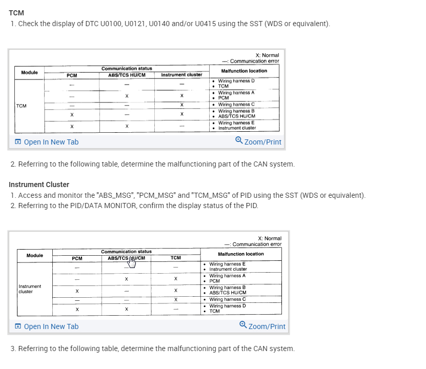

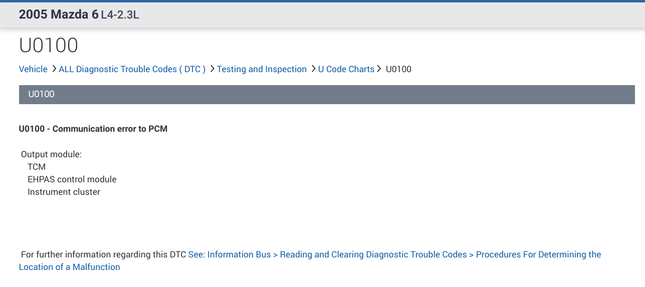

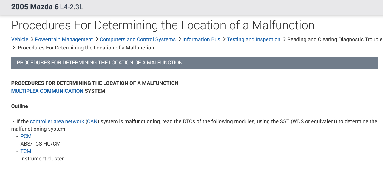

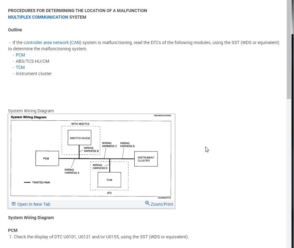

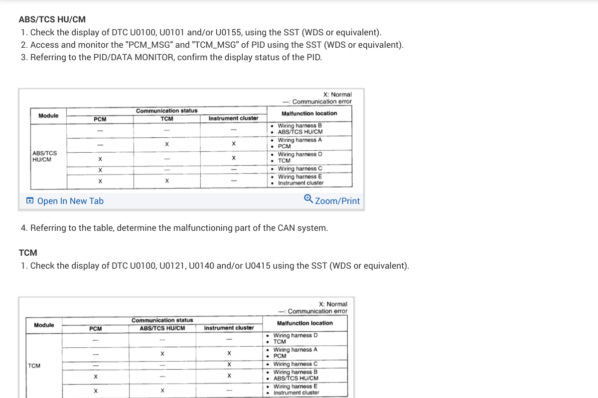

This sounds like you have unwanted resistance somewhere in the Engine Control Module[ECM] circuits.In the diagrams down below I have included the factory diagnostic troubleshooting guide for Direct Trouble Code[DTC] U0100. Please go through this guide and get back to us with what you find.Also, here is a link below on how to properly use a Digital Multi-meter [DMM]:

I suspect you have a general engine issue along with the issue that is causing the code that you are getting.
The fact that this has been running poorly and progressively got worse tells me we need to start at the beginning and pull the spark plugs to see what they look like. If they haven't been changed in a while, I would just go ahead and change the out. Then we need to check fuel pressure to see if you have proper pressure.
Once we verify these items and get the vehicle running we can start looking at the code that you have.
https://www.2carpros.com/articles/engine-cranks-excessively-before-starting
The communication issue code will not by itself cause your issues. If you had other codes with it then we could go there but I think we need to verify base engine things first.

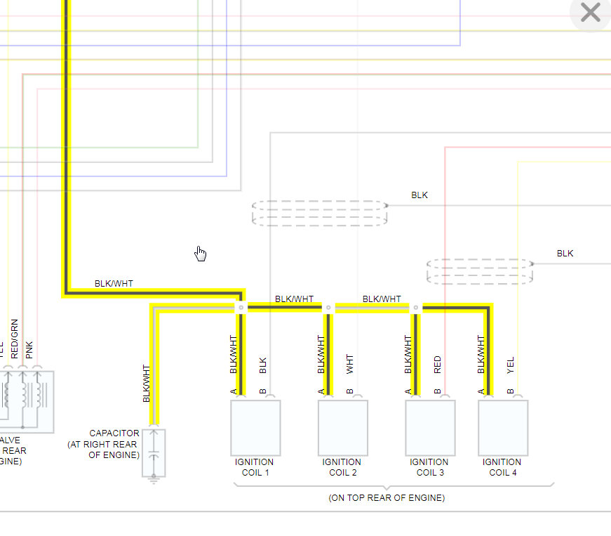

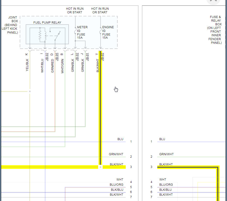

But anyway i put new fuses. In and i found out car tried starting up how ever this (engine in) fuse inside car (number 1) fuse box keeps blowing went attempt to start, yes there is fuel pressure figured that out by jumping starter and placing pressure gauge in engine plenty of pressure seeing if car engages so no brainier there.
however everything else works fine.
Jan 12, 2020 at 10:31 AM
Don't sell yourself short. Some of the best mechanics I know are women.
The fact that this fuse keeps blowing is because you have something on that circuit that is drawing more than 15 amps (which is what the 15A means). If you look at each of the wiring diagrams it shows this circuit highlighted in yellow. Since we know it blows then we need to find what component it is that is drawing more current. Luckily this circuit just has the coils on it so that is the most likely cause. More than likely you have a coil that is shorted. It could be the capacitor but more than likely it is the coils. It could be multiples of them or just one.
There are a couple of ways to figure this out. Test them with a meter, unplug them one at a time and see which ones do not cause the fuse to blow.
Let me know if you have questions and we can walk through whatever you want. This is pretty straight forward to explain so I just need to know what you are confused about and I will elaborate. It is easier to do that then write a long explanation on things you may not need explained.
