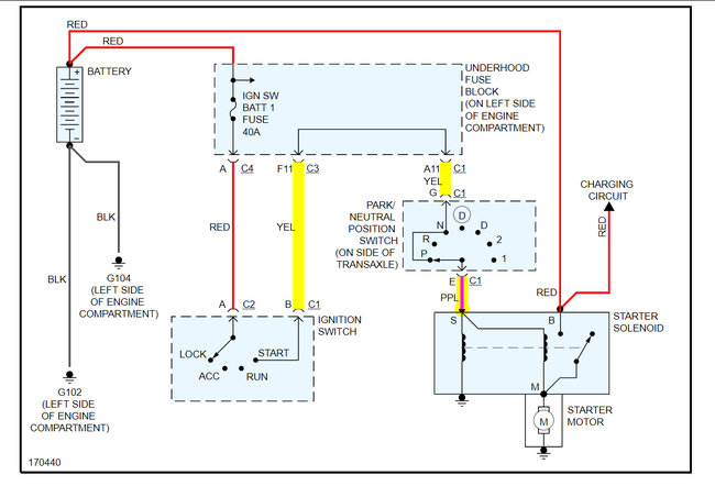

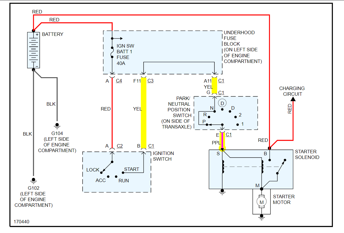

The fact that the theft light does not go out after 10 seconds tells me the theft system is preventing the starter from working. Check the guide below for resetting the system and try it and see if it starts.
https://www.2carpros.com/articles/how-to-reset-a-security-system

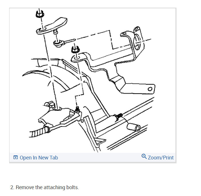

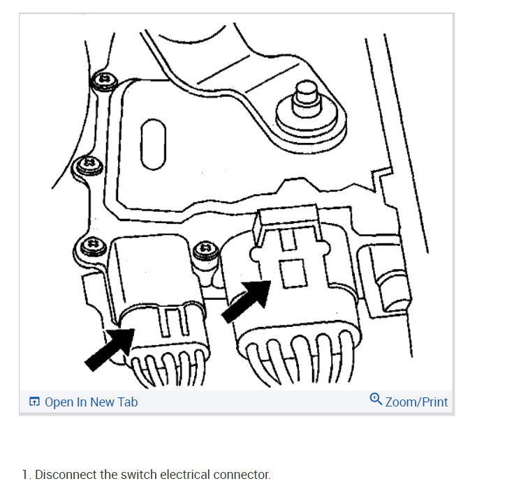

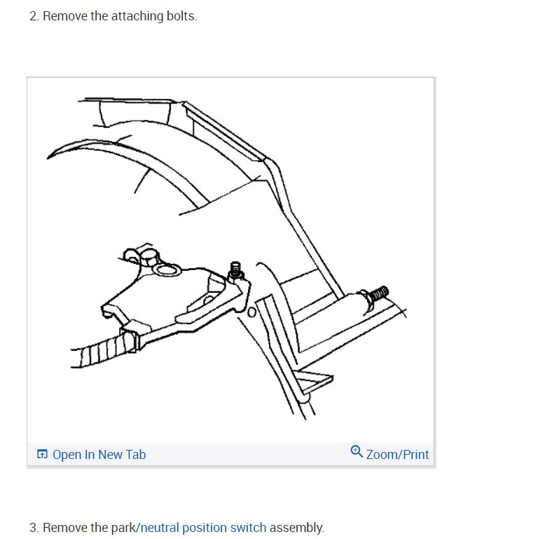

I also attached a wiring diagram for you to view. Check the neutral safety switch and make sure the connections are good and there are no damaged wires.
