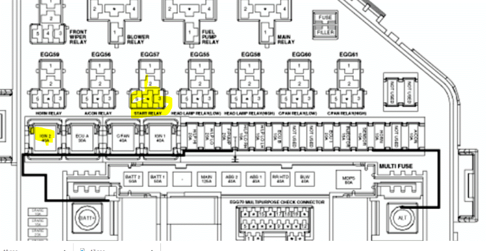

I drove the car shut the car off, drove it again shut it off. Now it won't crank over or start. I replaced the battery and replace the safety neutral switch.

If you replaced the clutch safety switch, then we need to check power. In the under hood fuse box, there is a starter fuse and relay. I attached a pic showing their locations in the box. First, check the ign 2 fuse. Make sure it is good and there is power to and from it. Here is a link you may find helpful:
If it's good, then locate the starter relay and switch it with another relay having the same part number. In the event there isn't one matching, here is a link showing how one is checked:
Do this and let me know what you find or if you have other questions.
