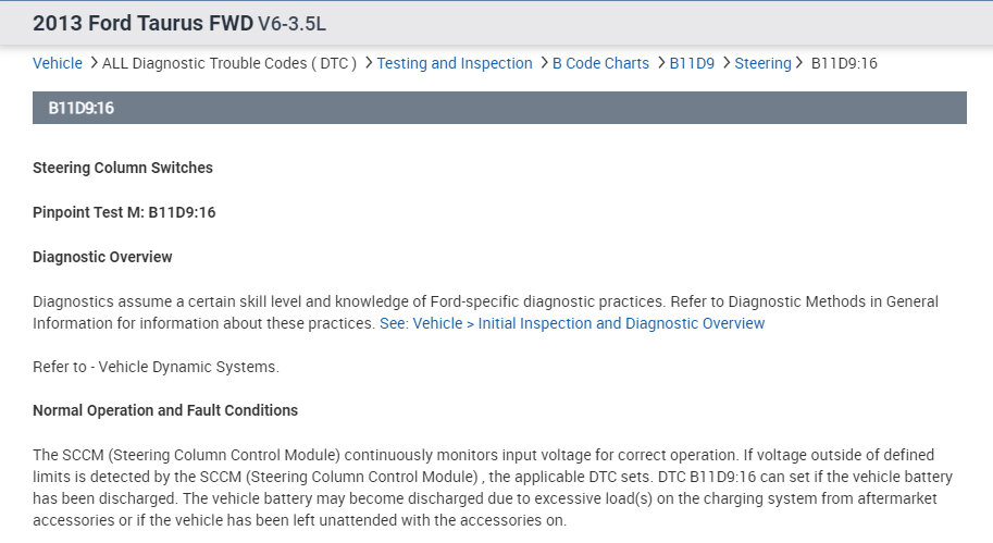

Also, a few of the codes listed are not showing up for this vehicle. However, the one that has my attention the most for the no start/no crank is the B11D9-16. That code is specific to the steering column control module (SCCM).

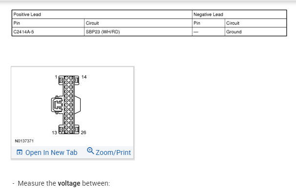

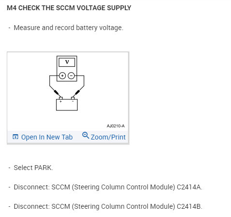

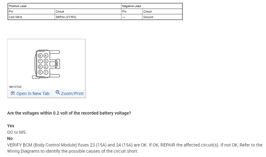

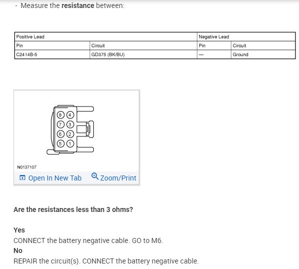

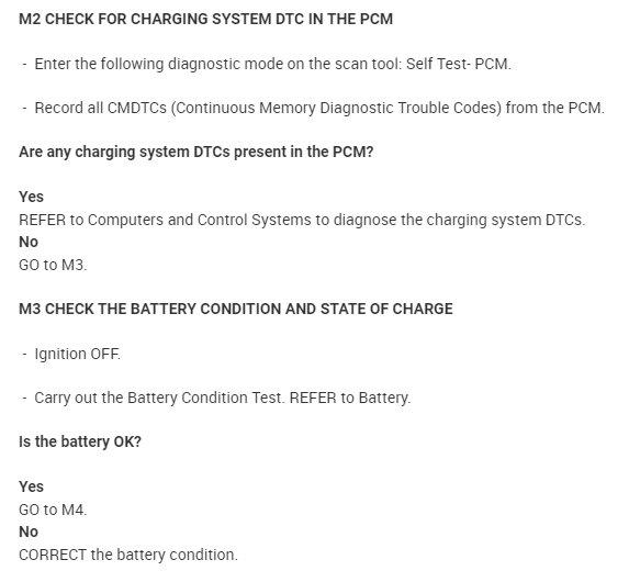

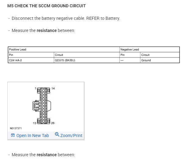

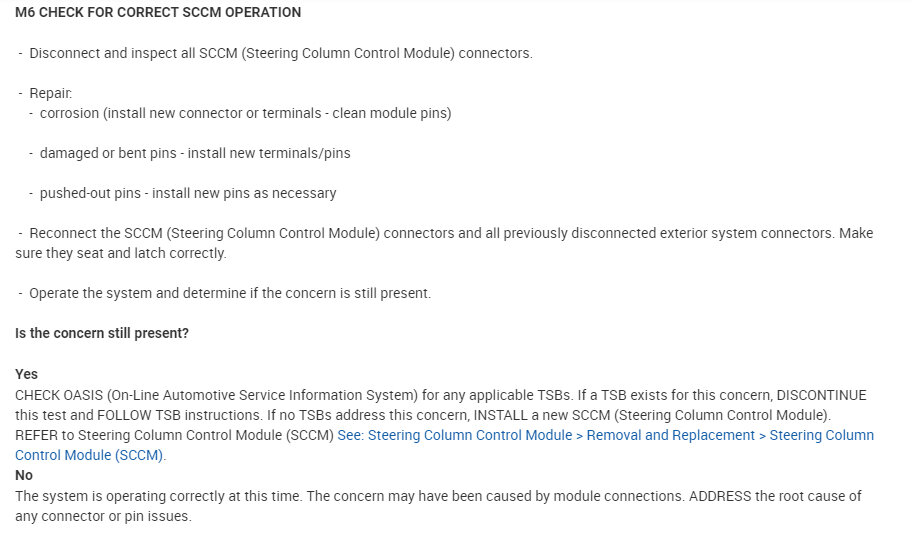

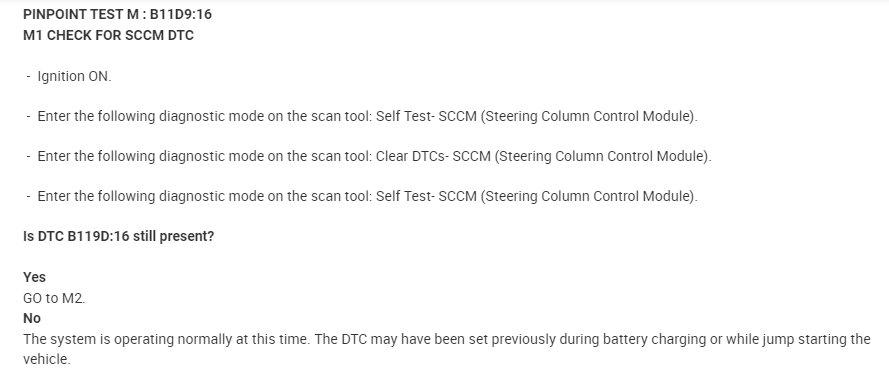

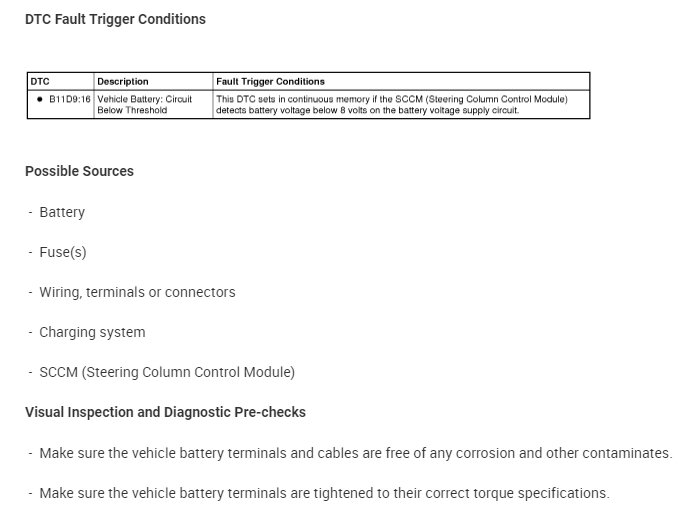

We have so many possibilities. I feel the best place to start is checking SCCM. If the module is causing an issue, it will affect several other things.
If you look below, I attached the diagnostics specific to the SCCM code you provided. This information is related to the 3.5L V6. If you have the 4 cylinder, let me know.
Also, take a look through the diagnostics and let me know if you are comfortable performing them.
Take care and let me know what you find or if you have questions.
