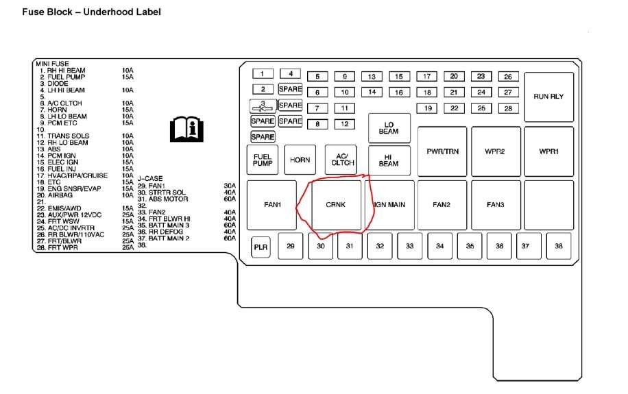

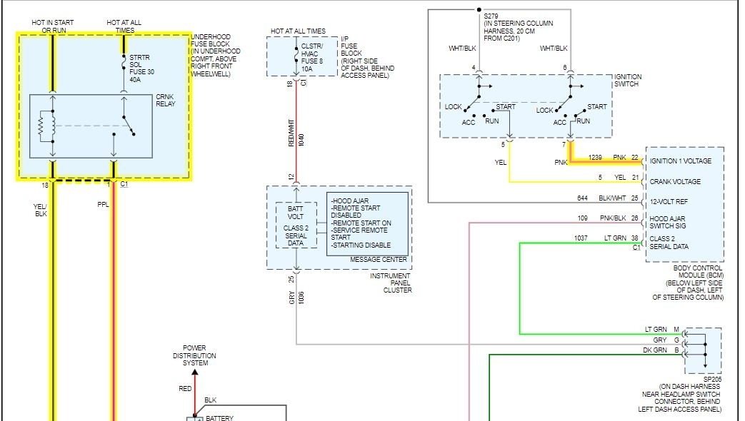

I attached a wiring diagram for you to view. We need to do some testing at the relay.
You will need a test light for these tests.

So, I was able to jump the crank relay and the engine started, but the starter is staying engaged until I turn the key off.
Jul 27, 2020 at 7:39 AM
It will because you have it jumped. There should only be power there in the start position only.
Which terminals did you jump?

Okay, 30 and 87 should make the starter okay.
85 and 86 are the control side of the relay.
With the key in the start position, can you test for power to either 85 or 86?

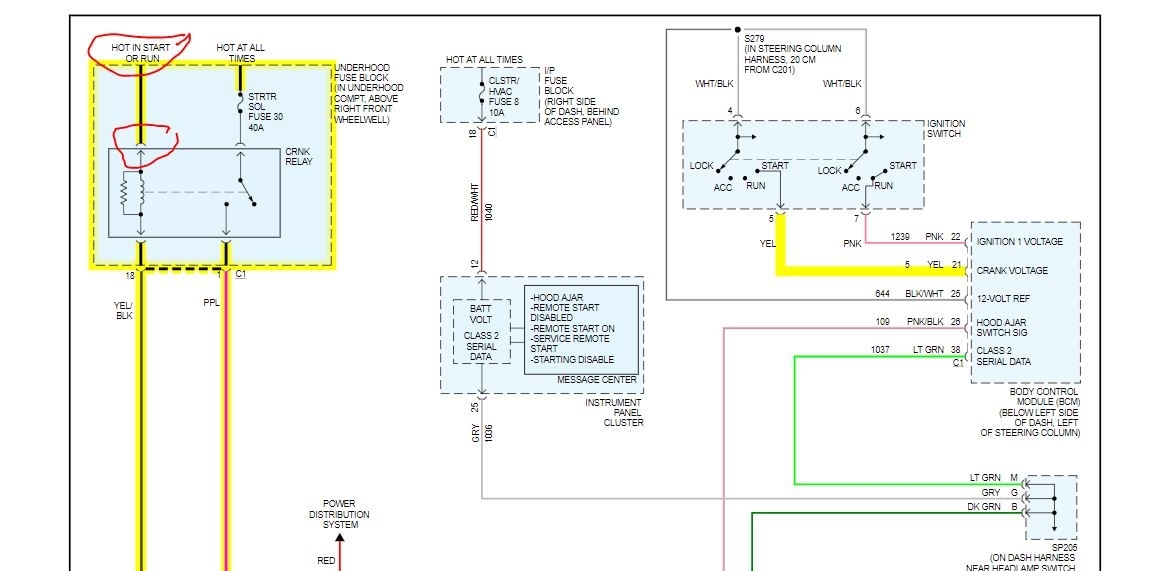

85 is ground and I'm not getting anything to 86.
Jul 28, 2020 at 8:28 AM

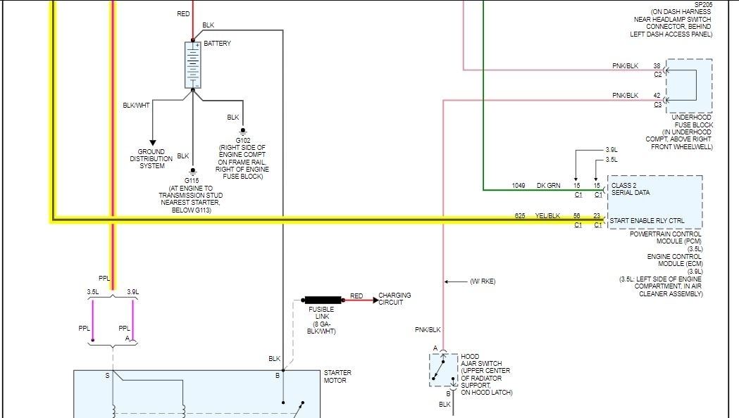

Okay, you should have power in the start position. If you do not, you will need to go to the ignition switch and test the yellow wire for power in the start position. I attached the diagram again showing the wire at the relay and I highlighted the wire at the ignition switch.
That wire goes to the body control module. It then looks for the park/ neutral switch showing it in the correct position. Once it sees that, the it sends a signal to the ECM to ground the control side of the relay.

For ignition switch power modes refer to Body Control System Description and Operation in Computer/Integrating Systems. When the ignition switch is placed in the Start position a discrete 12 volts signal is supplied to the body control module (BCM) notifying it that the ignition is in the Start position. The BCM then sends a message to the power-train control module (PCM)/engine control module (ECM) notifying it that CRANK has been requested. At the same time the BCM is supplying 12 volts for the IGN 1 relay closing it and supplying battery positive voltage for the crank relay coil. The PCM/ECM verifies that the transmission is in Park or Neutral. If it is, the PCM/ECM grounds the control circuit of the crank relay. When this occurs battery positive voltage is supplied through the switch side of the crank relay to the S terminal of the starter solenoid.

No power to yellow wire.
Jul 28, 2020 at 9:21 AM
Okay, sounds like you need an ignition switch

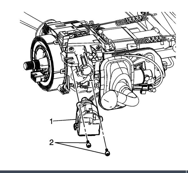

Ignition Switch Replacement
Removal Procedure
1. Disable the Restraint system. Refer to Restraint Disabling and Enabling Zone 3.
2. Remove the steering column trim covers.
3. Remove the ignition lock cylinder.
4. Remove the theft deterrent exciter module from the lock cylinder housing.
5. Remove the screws (2) from the ignition switch (1).
6. Remove the ignition switch (1) from the ignition lock cylinder case.
7. Disconnect the ignition switch electrical connector.
