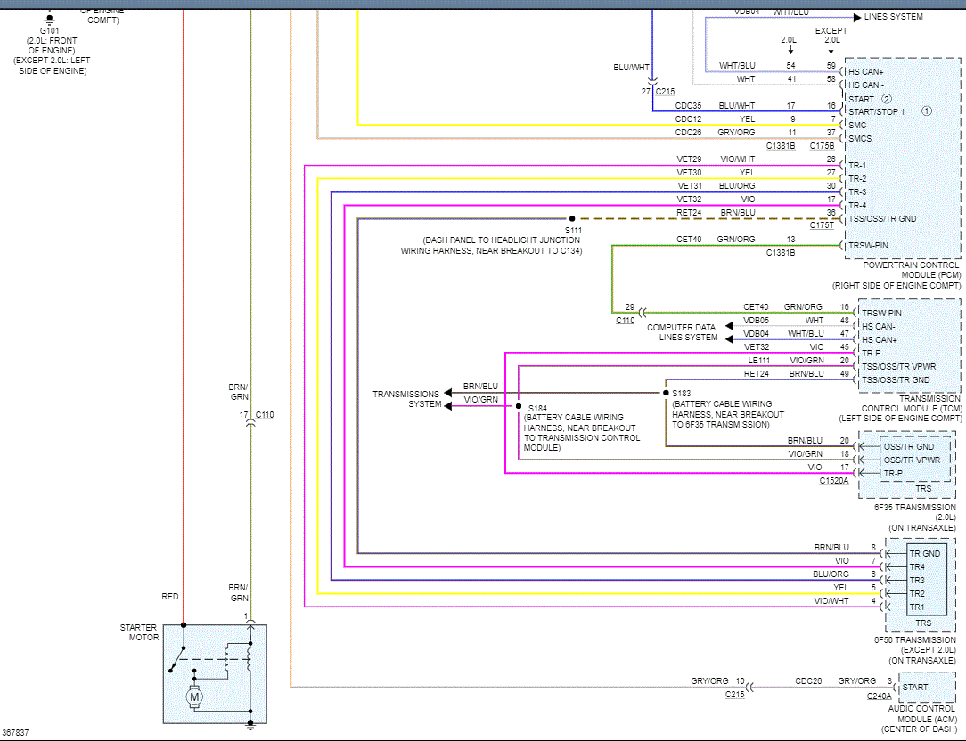

So what could be wrong? When I open the door to the car, the interior lights come on. When I get in the car, I attach my seat belt (just to eliminate any possible problems there). I turn the key to on and shift to neutral, let it drift slightly, and then shift back to park just to ensure the shift lock is engaged. Also, while the key is on, all the gauges come to life, radio presets are still there, headlights and turn signals turn on and off, so I feel everything is okay. I press the brake pedal, again, just to eliminate any possible problems there. When I turn the key to start, there is nothing. No click, no turnover and the gauges go out but return after a few seconds. Do I need to reset something?

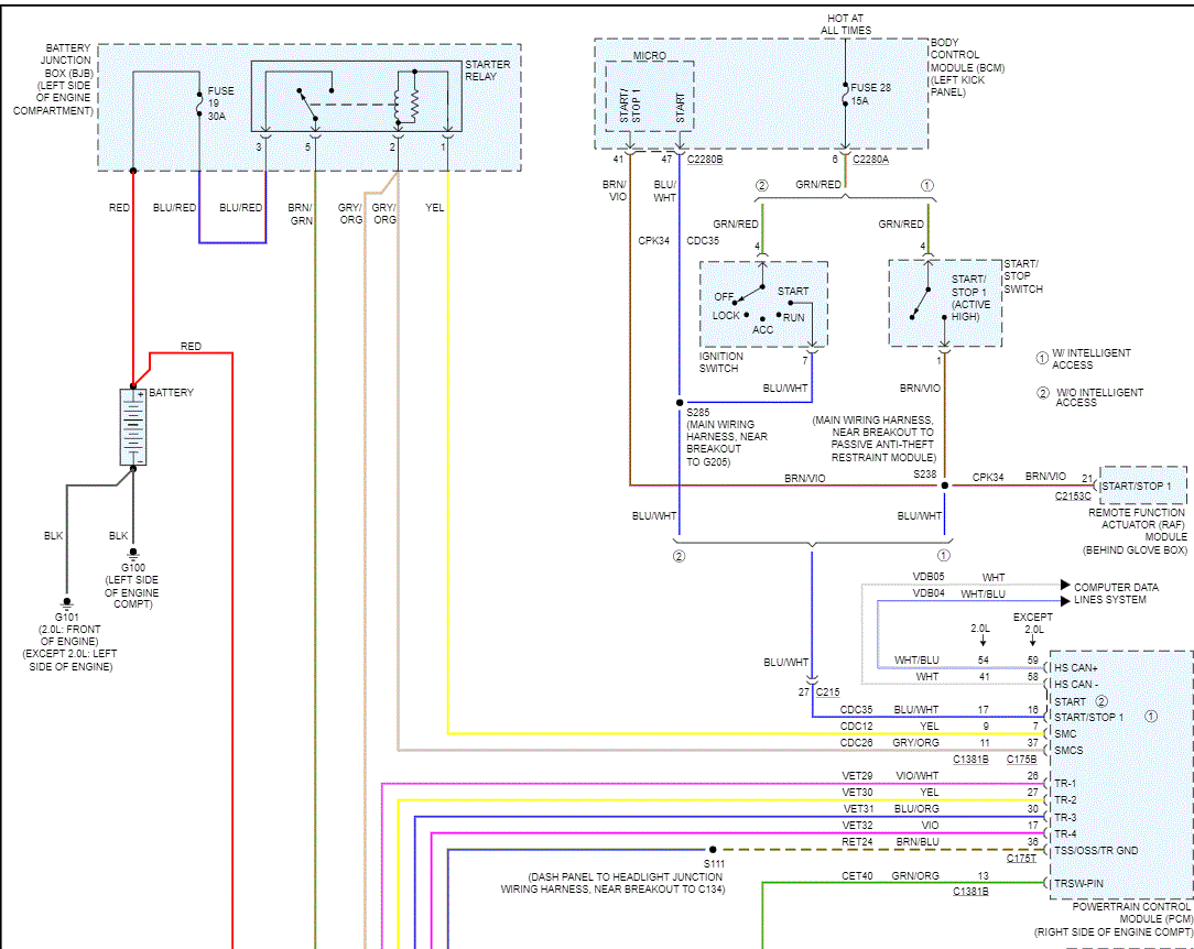

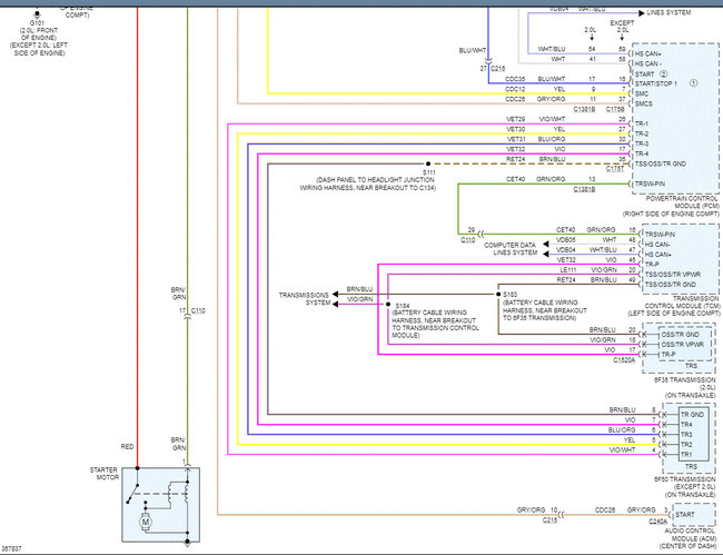

Since everything cuts out for a couple seconds and then comes back, I suspect you have a loose connection. Recheck battery terminals and confirm you can't turn them indicating they are loose. Recheck the main wire you replaced at the starter. Next, there is a smaller wire that comes from the starter relay which is also attached to the starter S terminal. It should only have power when the key is in the on position. Did you do anything that may have damaged or loosened that wire?
Also, check fuse 19 in the battery junction box to make sure it is good and has power. If that fuse blew for some reason, there will be no power to the starter relay.
I attached two pics below. In reality, it is one page, but I cut it in half to make it more readable for you. I did overlap the two so you can easily follow.

Thanks for the info. You gave me a starting point, and my next door neighbor is an electrician/engineer. With the wire diagram you provided and a fuse box diagram downloaded from an online version of the owner's manual, we solved the problem. It turns out I had reconnected two vital wires in the wrong places.
When I began this job, I had serious misgivings about messing with the main wire harness in the engine compartment. I was afraid of cutting a wrong wire or nicking something that would cause a short that wouldn't be easy to diagnose or getting confused by too many disconnected parts and reassembling something wrong. I had good reason for these fears because, in my case, one came true.
I started out with replacing the fuse, as you suggested; hoping the simple solution would be the one I needed. My fuse was blown, so I got a new one and promptly blew out the new fuse (at position 19). Okay...I knew I had no loose connections, but I checked anyway and found I had no loose connections. Again, okay...the last, slightly more daunting task for me was checking the power at the starter as you suggested. I am by no means electrically inclined and, although I have a multi-meter and a continuity tester, I have no confidence in using them correctly. I soldiered on though, and checked for power at the starter as you suggested and found there was no power in the post with the key on or off. This is where my neighbor came in and he began checking for power and shorts in various locations, all related to the circuit between the battery and the starter and he soon zeroed in on the wire coming off of the starter relay post you mentioned. He asked me where the wire to that post went too, and of course I had no idea, so (to my horror) he began splitting the wire harness again to discover the origin of the wire because he was beginning to think we had the wrong wire diagram or there was a short in the wire somewhere (possibly from me cutting the positive battery cable and nicking something ) or, even, me having cut the wrong wire (the positive battery wire is red and there is another red wire of the same gauge inside the wire harness). He was splitting the harness back up toward the battery from the starter, when, almost finished, we discovered it was the negative battery cable. That's not right!
I know it sounds stupid now, with the wire diagram in front of us and the wire harness split wide open baring all the wires for all to see, but looking back to see a mistake and ridiculing it is a lot easier to do than thinking about how to try to solve a problem, putting together a plan to fix it, executing the plan, getting it right and adjusting for inevitable errors. I had no idea I had flipped the harness and wired the negative battery cable (black in the wire diagram) to the starter and the starter relay wire (brown/green in the diagram) to the engine block. In my eyes, I had simply reconnected two very similar looking wires to where I thought they belonged. You see, the wire harness looks like a thick corrugated black plastic pipe covered with black electrical tape as you follow it from the battery to the starter, with junctions where other corrugated pipes (or just wires) split off it or join into it. At a point near the starter, there is a junction where two wires leave the main branch, but on opposite sides of the harness. This junction looks like a plus. Although the one wire is slightly bigger than the other, without knowing what the wires are or what they do or without taking a photo (a lesson I continually have to learn due to haste or lack of thought) of the junction and its components and their destinations, makes this mistake an easy one to have occur. The wire diagram does not represent the actual routing of the wires, so it doesn't show you that both those red wires run alongside one another, along with the black wire from the battery and the brown/green wire from the starter relay. I know wire diagrams are useful tools for engineers and electricians but routing diagrams would be just as useful for DIYers and mechanics/technicians. I am sorry that routing diagrams are no longer produced (another victim of space savings and cost cutting, I assume). Hindsight also informed me that, had I planned on splitting the wire harness all the way from the battery to the starter to begin with, I could have saved that $115 difference between the battery cable and the cable terminal because there was plenty of slack in the cable, once it was freed from the bondage of the harness. However, (again, hindsight) I never had plans to do all that work to split the entire cable length because of the fears I had and the work to rebind/re-tape/rebuild the wire harness quadrupled my workload. Now I know why Ford's solution is to just cut the two ends off and leave the remainder in the harness.
