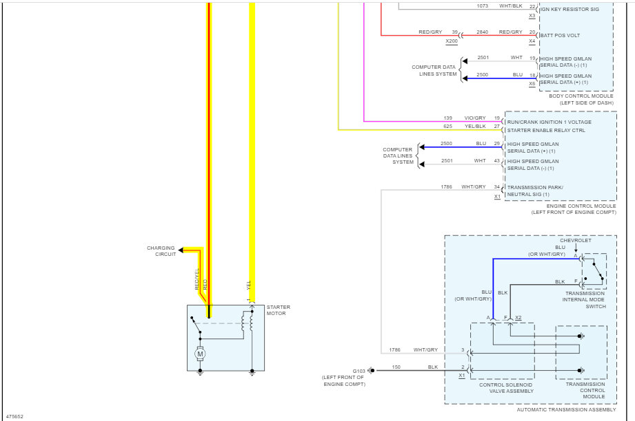

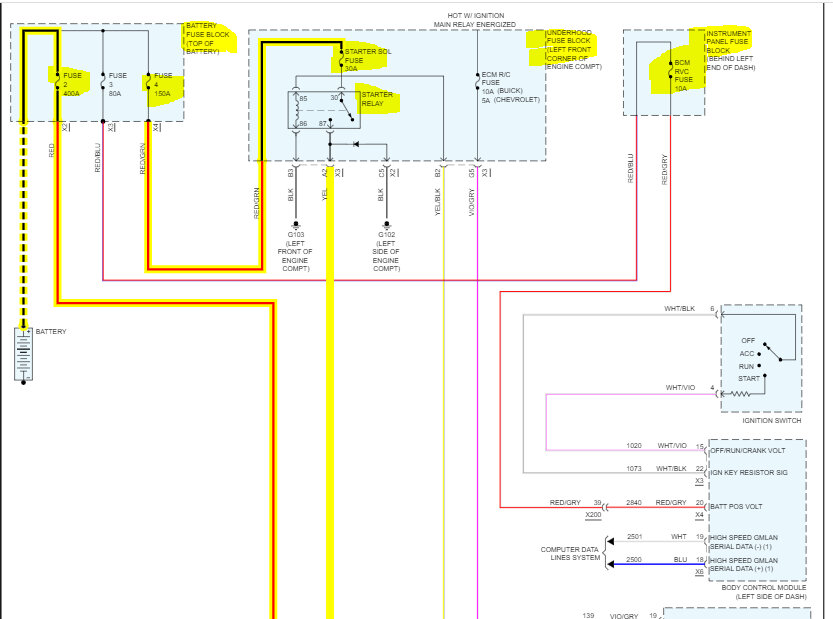

There are multiple fuses for the circuit to work. I attached the wiring schematic below for the starter circuit and highlighted all the fuses and the relay. Note the fuses are in different fuse boxes.
When you check the fuses, confirm there is power to and from them.

Note: I had to cut the schematic in half to make it readable. I did overlap the two so you can follow from one to the next.
