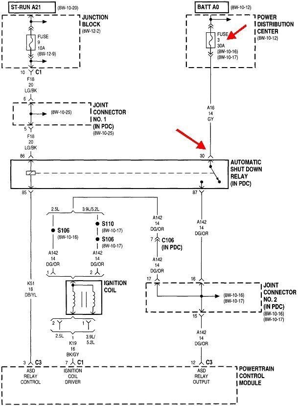

This is fairly common except for the fuel gauge, so lets start with the basics. I'll have to come back and explain how the system works, but in the meantime, find the dark green/orange wire at the ignition coil or at any injector. Measure the voltage there with a test light by back-probing the connector through the rubber seal. You should see the test light turn on for one second when you turn on the ignition switch. You should also hear the fuel pump hum for that one second
What is important is that 12 volts must come back during engine rotation, (cranking or running). If it doesn't, the Engine Computer is not getting a signal from the camshaft position sensor or the crankshaft position sensor. Given the transmission work, the crank sensor is the better suspect, especially if it wasn't removed before removing the transmission.

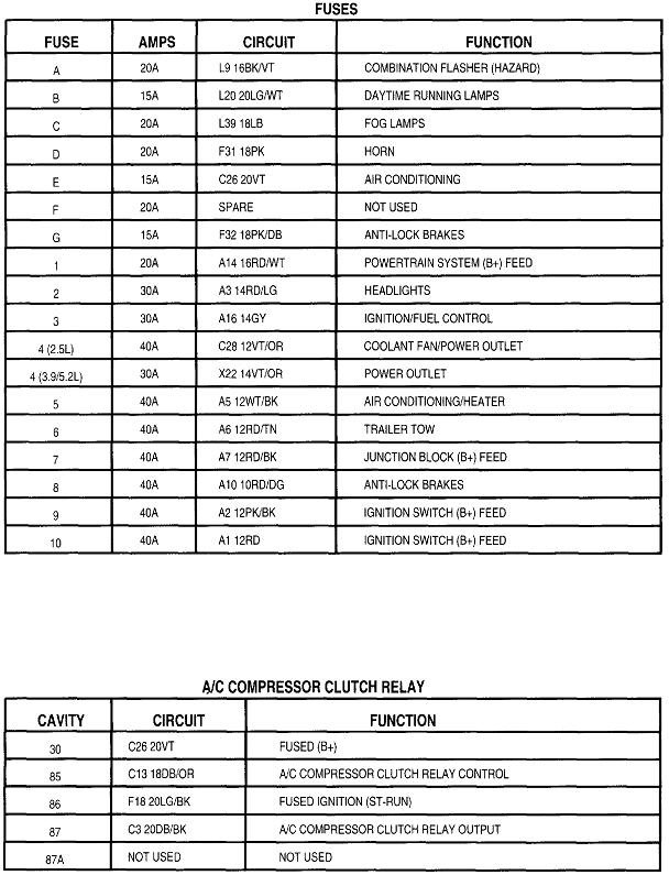

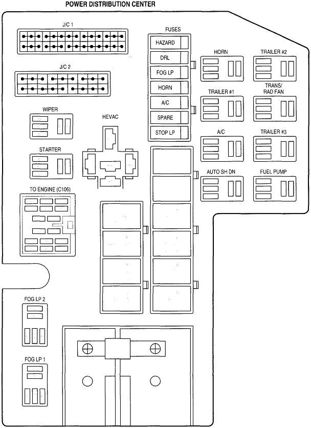

Not even for one second when turning on the ignition switch? If you checked that with a digital voltmeter, you probably missed it. They don't respond fast enough. You need to use a test light for this. If it's still missing, remove the automatic shutdown relay from its socket, then lightly probe each terminal in that socket. You should find 12 volts on one of them all the time. If that is missing, a fuse is blown.
I found the layout for the under-hood fuse box. Wouldn't ya know it; they forgot to number some of the fuses. If you can figure out the numbering of the missing ten fuses by their current ratings, let me know and I'll add that to the drawing.

I have constant power to fuel relay and automatic shutdown relay in pin 30. Rechecked all fuses but still nothing. Now the blue wire on the fuel pump plug has 1.76 volts.

Okay; put the ASD relay back in, and recheck at the ignition coil or an injector on the dark green / orange wire, and be sure to use a test light, not a voltmeter. The test light must turn on for one second when you turn on the ignition switch. If it doesn't, do that again and feel if that relay is clicking. That may tell us which circuit we need to look at, the one that controls the relay or the one the relay turns on and off.
Switch the ASD relay with one of the other ones like it, like the AC compressor clutch relay or the starter relay, and see what happens.

By "main relay" which one are you referring to, the automatic shutdown, (ASD) relay or the fuel pump relay? Why was it bypassed, and do you remember which terminals were connected together? Here's a drawing that can help with terminal identification.
