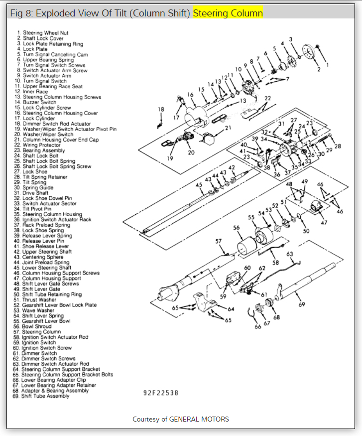

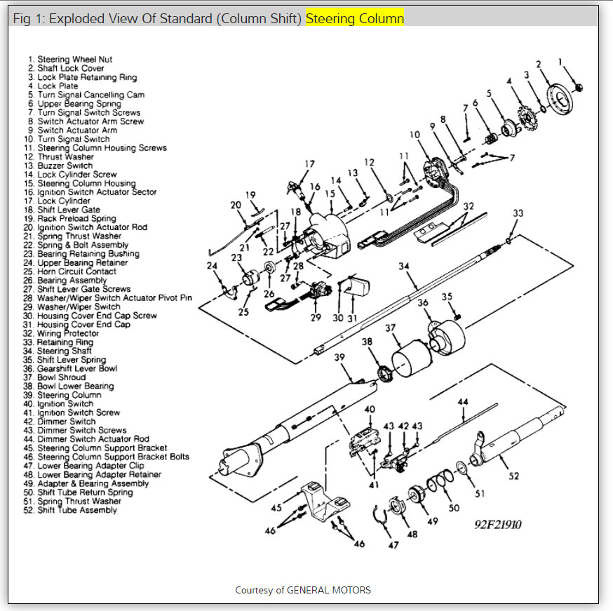

Thanks for your quick reply. You were right about the ignition switch being bad. I removed the wheel and plastic ring, then noticed 2 brass wires that
were bent after removing the plastic that was attached. Yesterday, I bought
a new switch and will bolt it on later today. How do these brass rods connect to the switch at the bottom of the column? The guy at the parts
store said there is a rod that runs through the column. I haven't removed it
yet. We live in the country with much grass to cut. So, I'm late getting back
to you, Thanks so much for your help. George

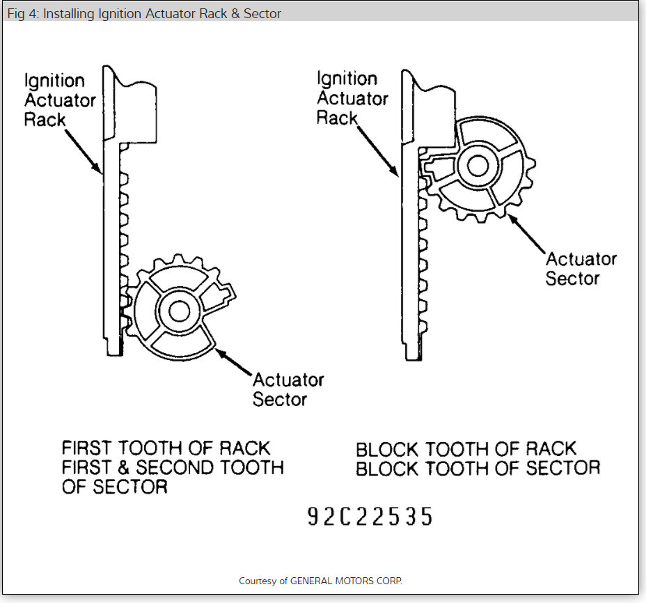

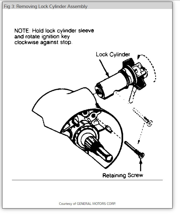

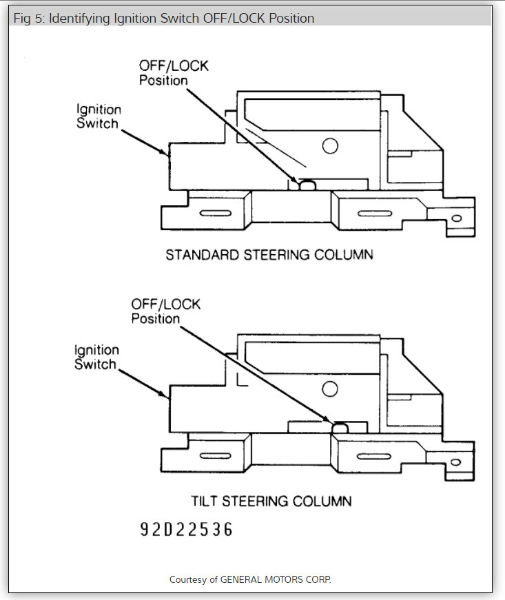

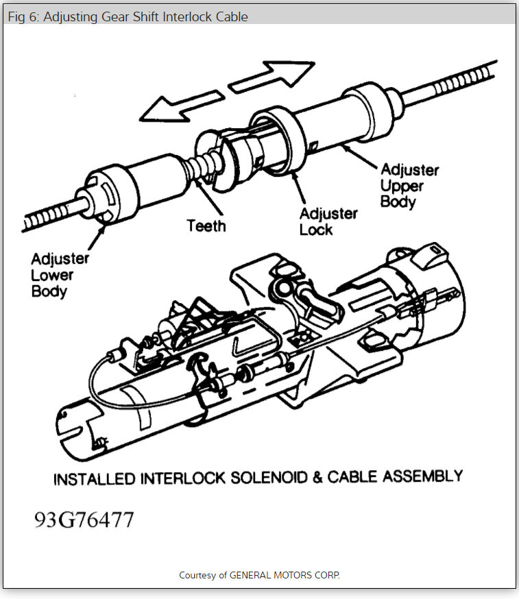

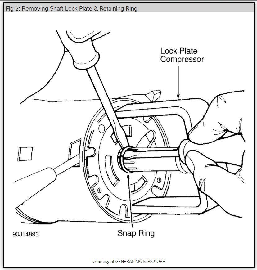

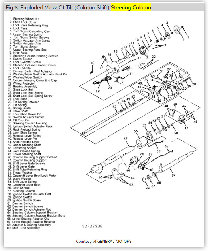

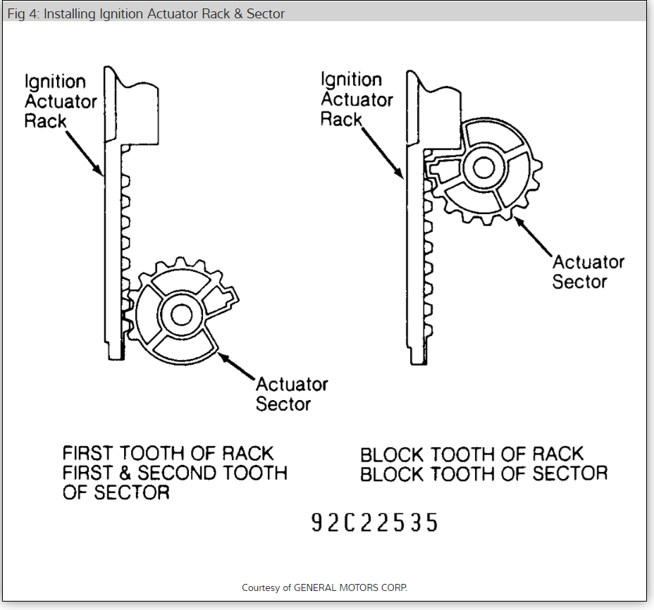

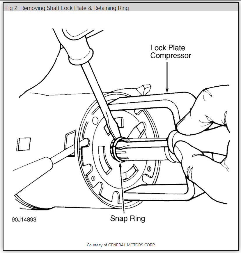

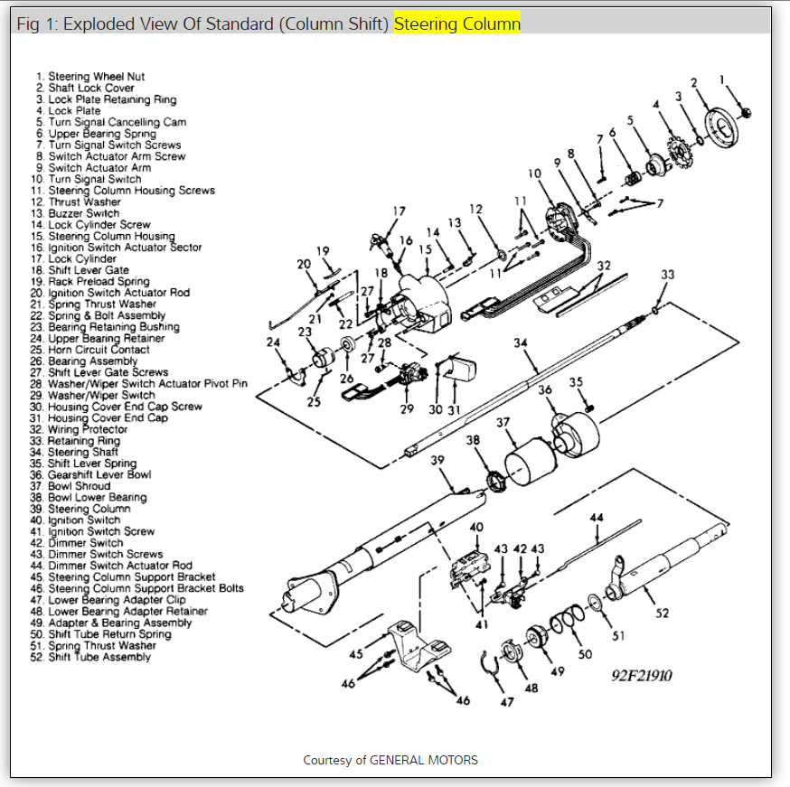

Good find here are instructions and diagrams to help you see how the system works. Check out the diagrams (Below). Please let us know what happens.
