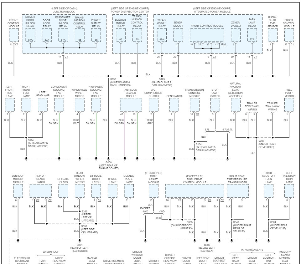

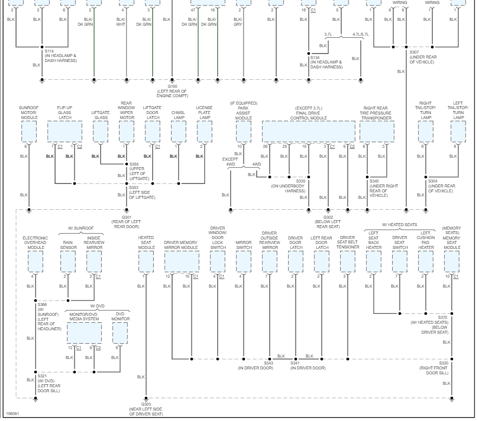

I recently changed the timing and the oil pump and when I got it all back together it won't start. it cranks but no start. I changed the crank and camshaft positioning sensors and checked them to make sure that are getting power from the PCM and that was good. I checked the coils, and they seem fine. checked for spark and got nothing. I should mention that the relays for the electric fan and running lights I have pulled because they run continuously if i connect them. I'm not sure if that's related but I was planning on addressing that after I got it running. And no communication to the code reader as well.

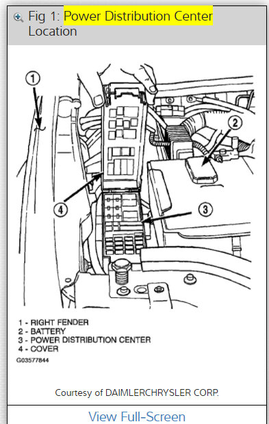

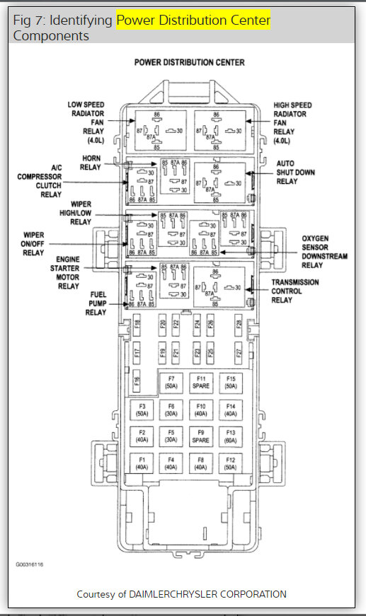

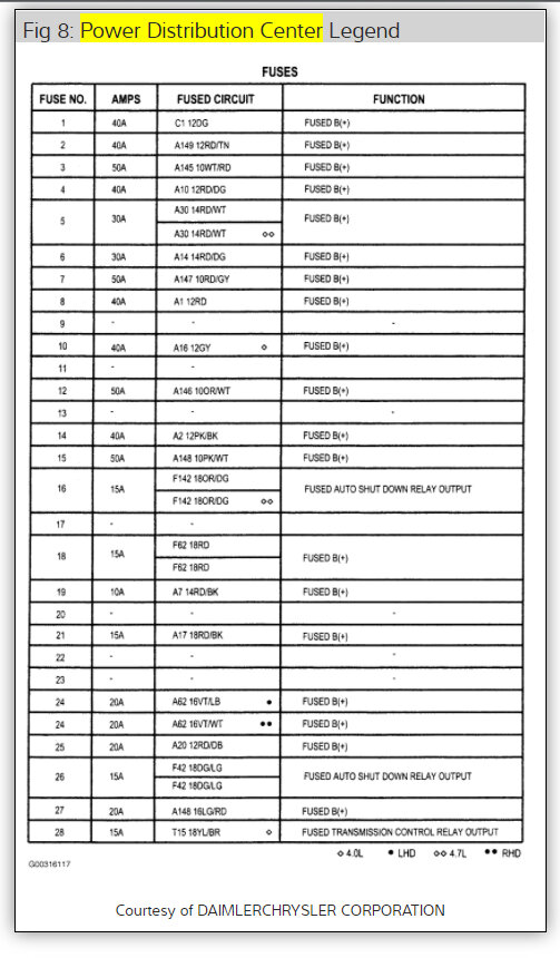

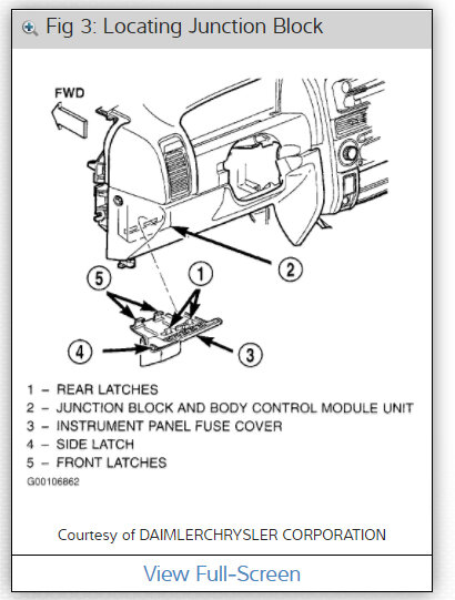

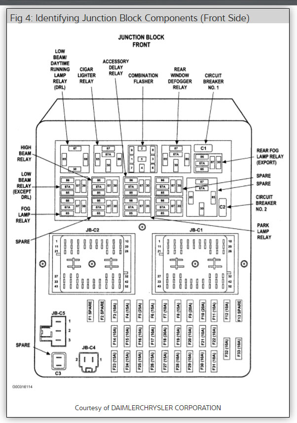

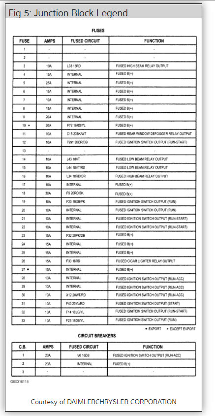

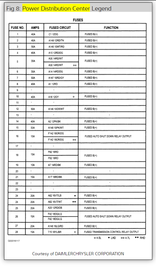

I would start by checking all fuses with the key on here is a guide that will help, and I have included the fuses' locations. Also recheck the grounds to the engine block you might have to take it off while doing the job.

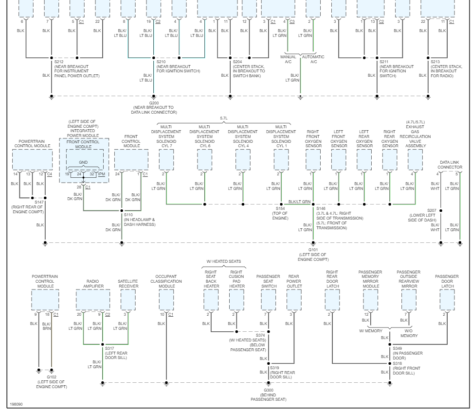

I have gone over the fuses endless times this time was the same. All good. If you have a ground location doc. It would be greatly appreciated I can't find one anywhere and it's been a couple months from when I started this so I'm not confident i remember where they all are. Thanks you for any help btw.

  • 55,433 POSTS

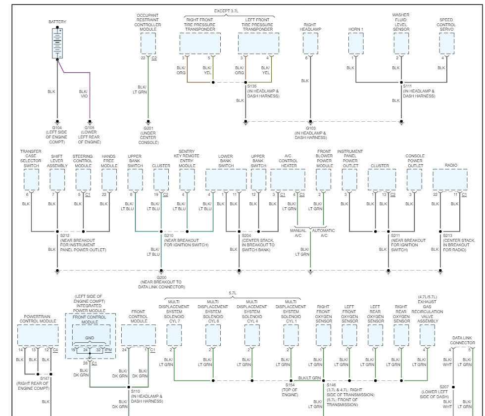

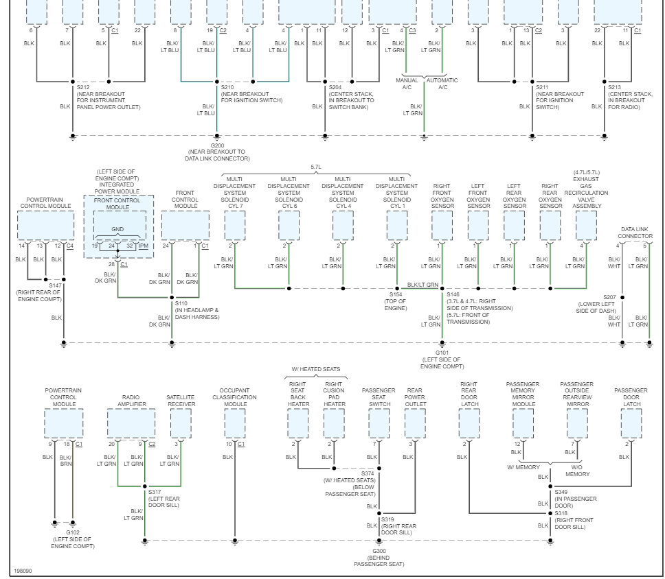

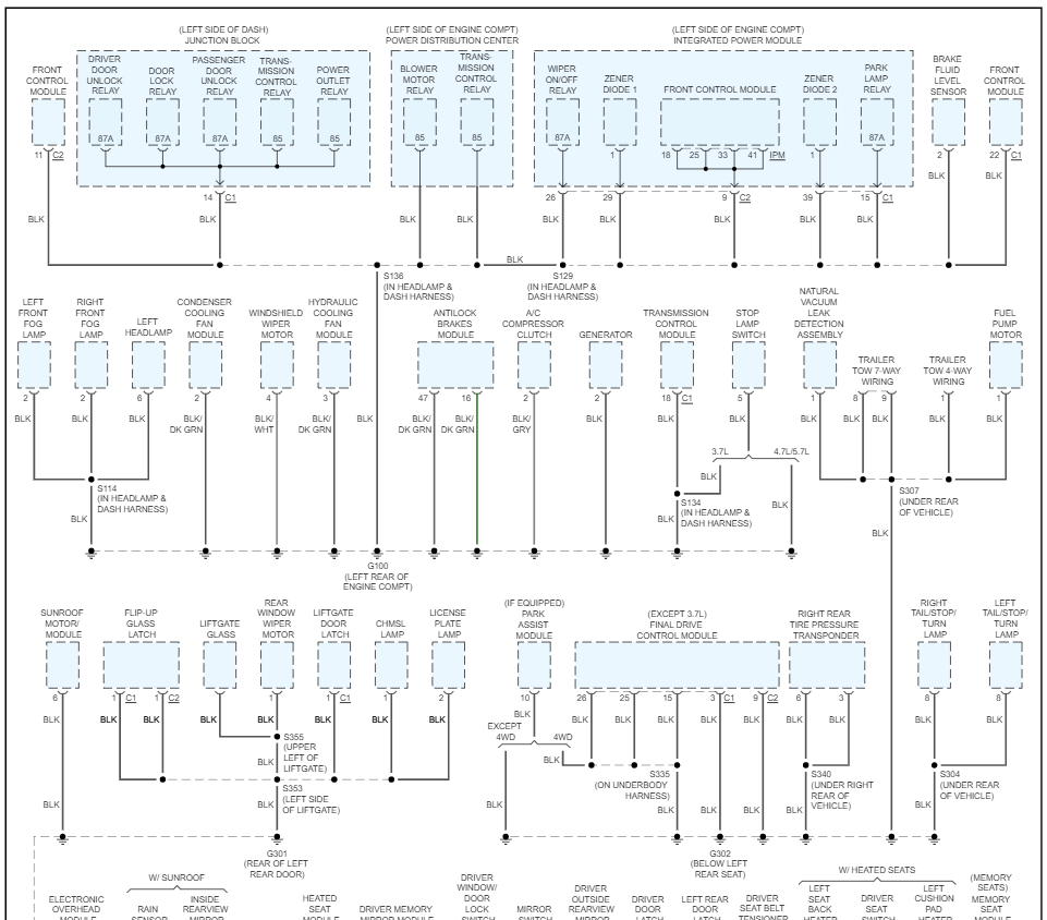

Sure, here are the ground locations of the PCM etc. Check out the images (below). Please let us know what you find.

I appreciate the diagrams but so far, I haven't found anything. Well, my fcm fuse was blown but I replaced it to no avail. I was thinking it could be the skim but I don't get any light on my dashboard. any advice on where I should proceed? You mentioned checking the engine block grounds and that I may have to remove it to do this. What did you mean by that? remove the engine block?

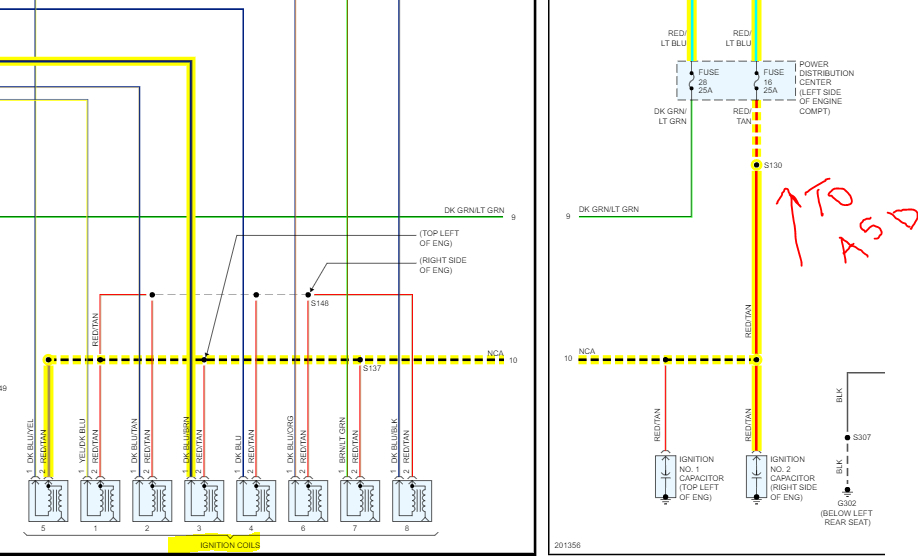

  • 110,244 POSTS

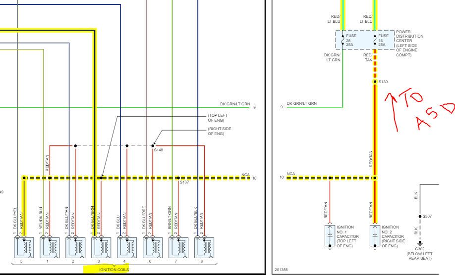

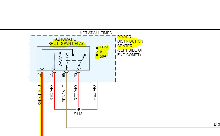

At each ignition coil, there will be a red wire with a tan tracer. Those wires provide power to the coils via fuse 16 in the power distribution box under the hood. Fuse 16 will only receive power when the automatic shutdown relay (ASD) is actuated. Have you checked the ASD? The ASD is also in the power distribution box and powered by fuse 6 (50amp).
If you have checked the ASD and all fuses, go to the injectors. With the key in the run position, see if the red/tan wires at the coils are getting power. If they are, then we need to check for a ground path from the PCM.
The opposite wire than the red/tan at each injector provides a ground. With the connector disconnected, take a test lamp and connect the alligator clip to the battery positive and probe the ground wire with the test lamp. Have a helper crank the engine. When cranking, the light should strobe on and off.
Let us know if that happens.

well I noticed right away that the 50-amp fuse was switched with a 30 amp from slot 11 and I switched them back. the fuse for the coils is getting power. When I checked the coils themselves, I got different weak readings from one to the next, but I noticed my battery had drained. I'm not sure if I mentioned that I have relay #11 and #25 pulled in the integrated power fuse box because they are stuck on constantly when connected. The running lights and electric fan both stay on if connected. I just charged my battery, and had it disconnected so it was charged when I connected it. The battery drained within 45 minutes to where it will hardly crank... I'm not very electrical wise so I'm really lost now.
