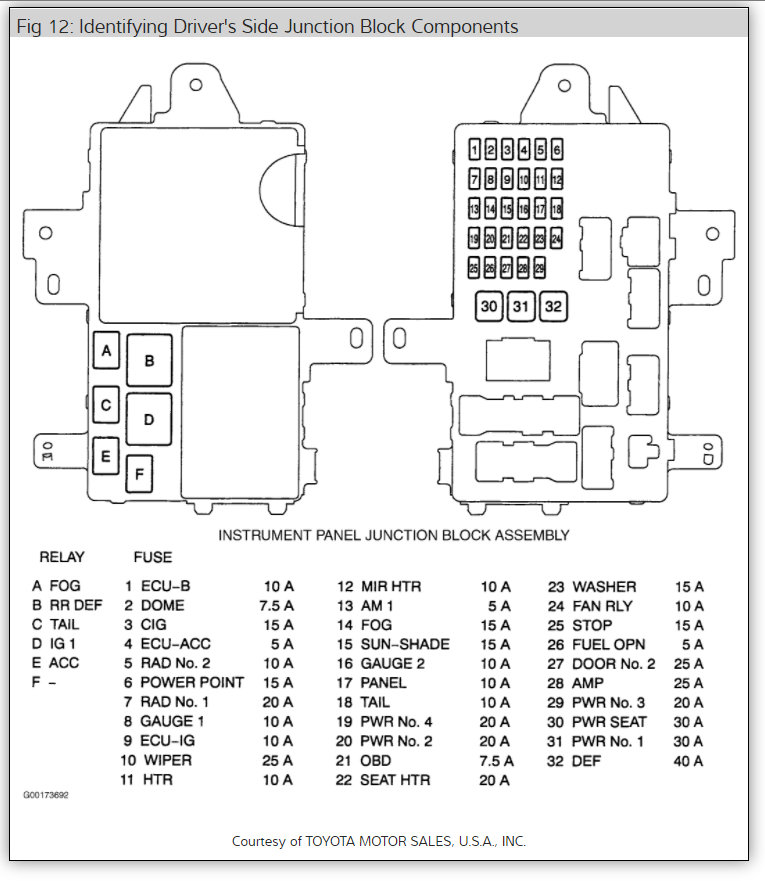

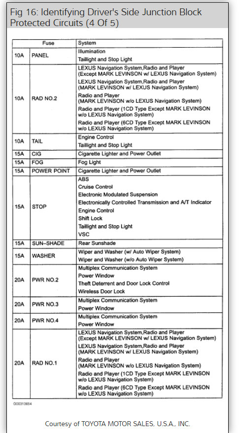

My CD player/changer had gotten stuck where it would not play or eject any of my CD's that I had in it. so my husband took the CD player out and got the CD's out and put it back in but now the volume button does not work. We can turn it but no sound comes out. What do you think happened by him just taking it out and putting it back in?
Mar 3, 2018 at 7:19 AM
  • 55,748 POSTS
Did he need to take the CD player apart when he did the repair? I would start by checking the fuses to make sure we didn't blow out something.
Mar 5, 2018 at 3:48 AM
PCHAVERS
  • 6 POSTS
He is going to check all the fuses but he hasn't had a chance to do that yet. He got tied up with work and stuff. I will update the progress when he gets that checked out. Thanks!
