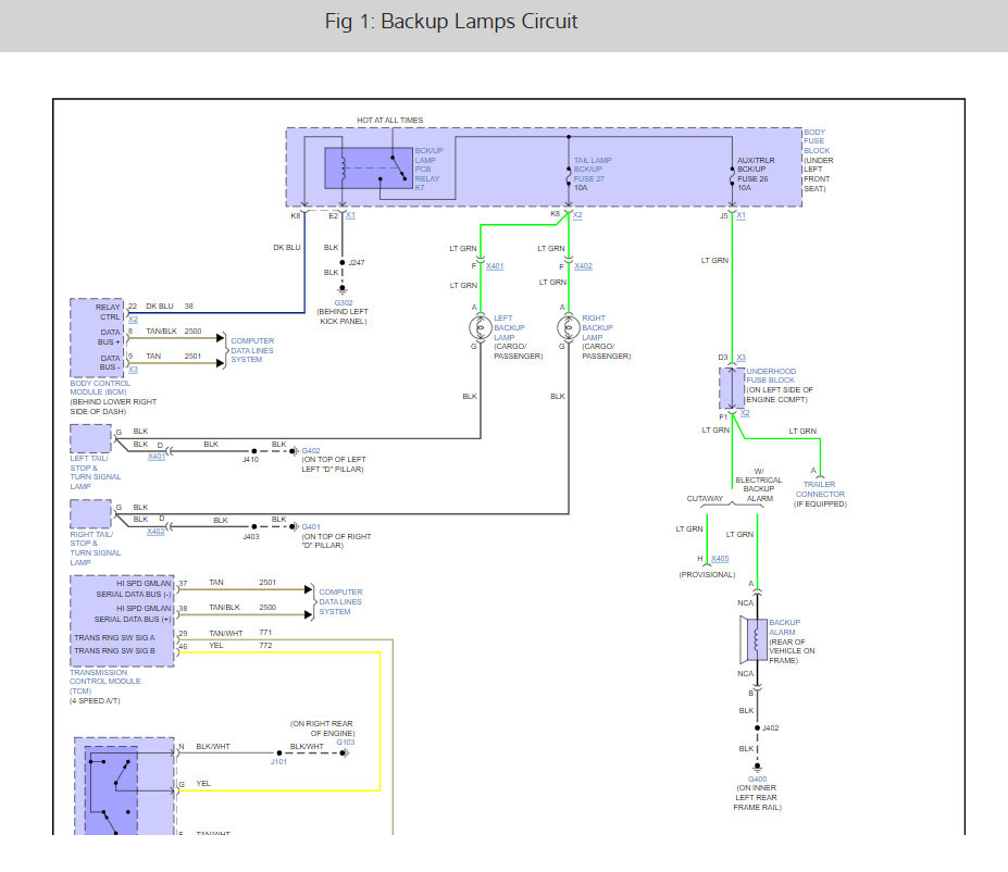

I have traced the wire and successfully tested for continuity from the reverse lights all the way forward to a bundle where it either joins into another wire or goes down to the fuse panel. It will be a lot of work to trace any farther, and I'm hoping there's a short to ground coming off of the transmission switch or the switch is somehow stuck from sitting all winter.
I believe the transmission is the 6L90, but I don't know how to tell for sure. I do not see any screw-in ball-check valves like the GM Genuine Parts 14069600 Back-Up Lamp Switch. I also do not see any bolt-on sensors like the GM Genuine Parts D2257C Park/Neutral Position and Back-Up Lamp Switch. I think this means the trigger for the backup lights is a slide switch inside the pan bolted to the valve body to tell the ECM which gear you have selected. I'm not super comfortable opening up my transmission like that. Can anyone tell me how to confirm which transmission I have, and/or advise on where the reverse switch is?
