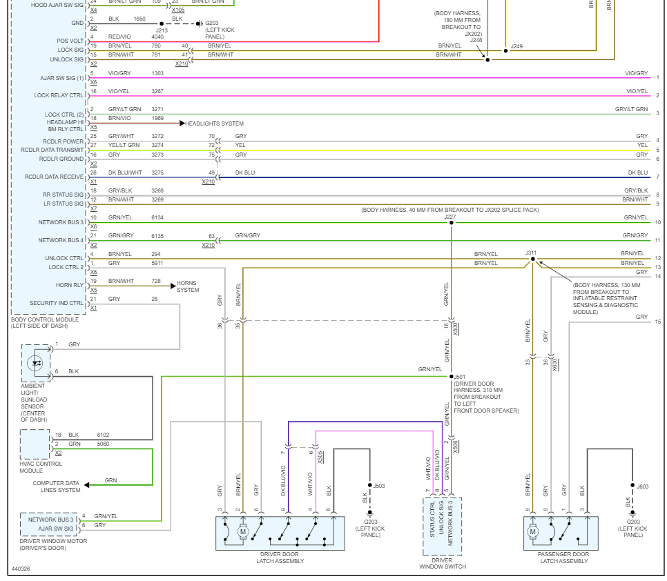

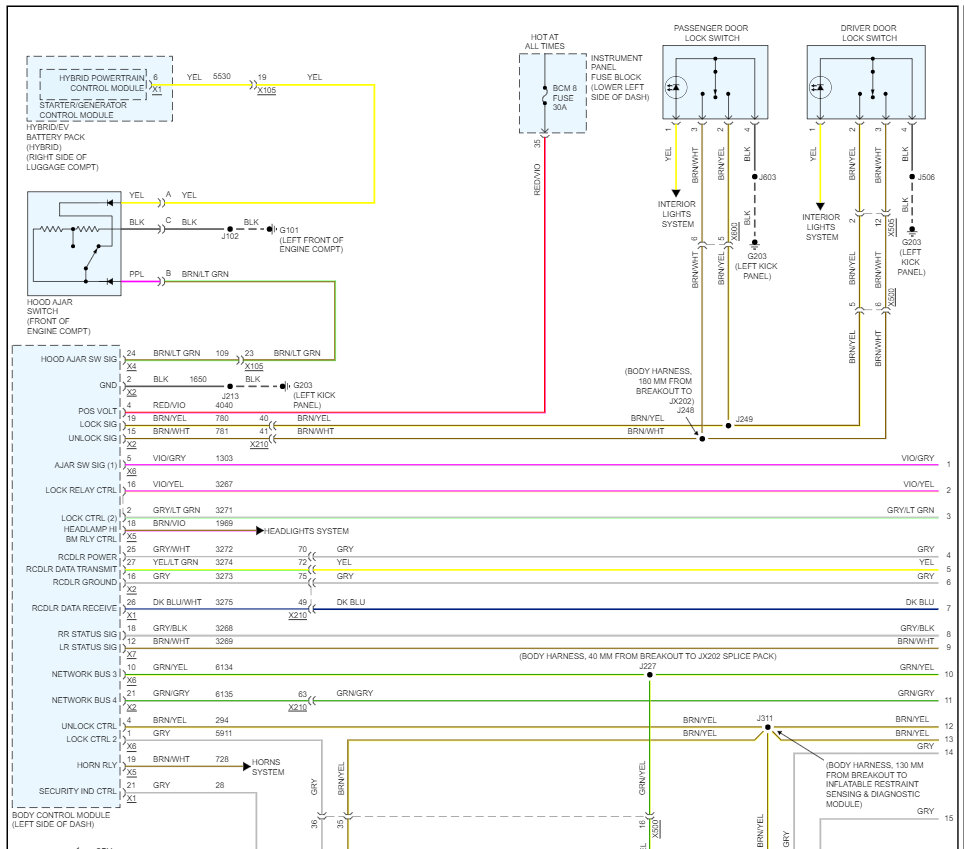

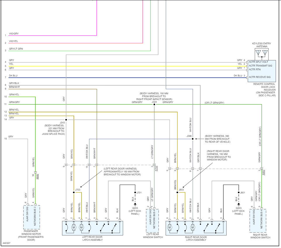

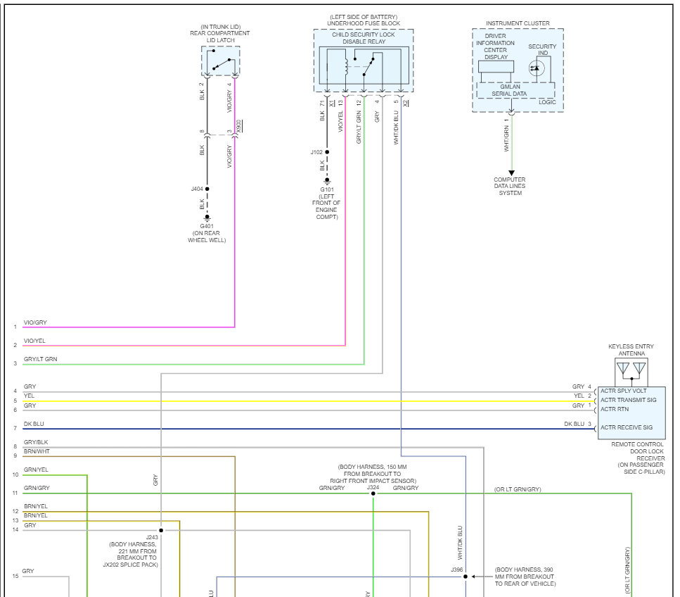

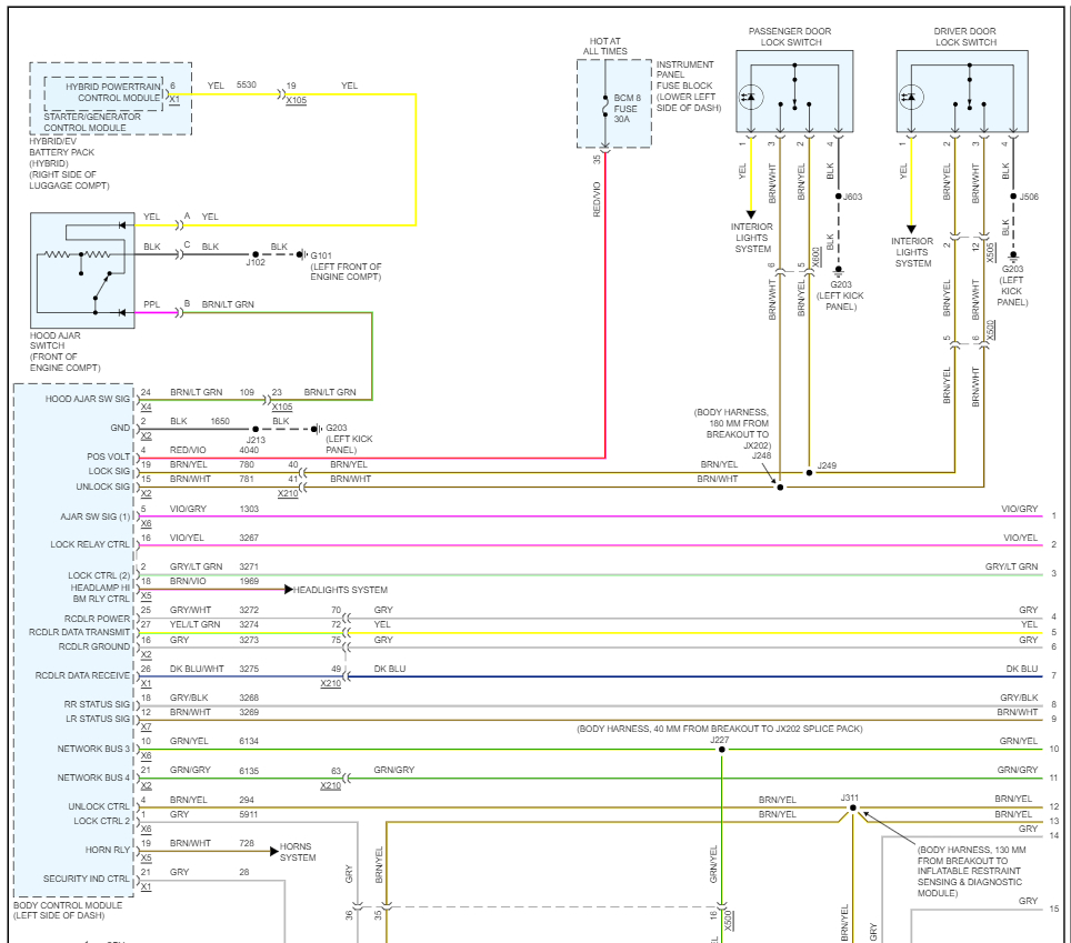

The car has been giving the message "no remote detected" when starting. It is not every time, mostly at the first start of the day or after it has been sitting awhile. We purchased a new key fob, but the problem pursuits. After looking around online, I am guessing it is not receiving the signal. Any help would be greatly appreciated.
Apr 10, 2023 at 7:58 AM
  • 55,711 POSTS

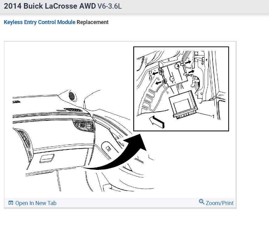

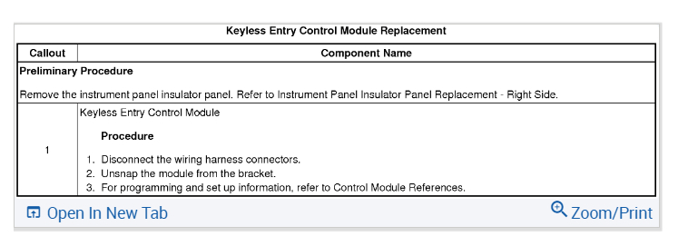

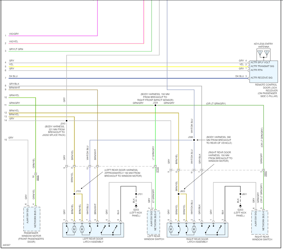

This problem can be the keyless entry antenna, keyless entry control module or the BCM is going out, but you should check the fuse BCM# 8 at the lower left side of the dash panel. I would run a CAN scan to see what codes come up. You can get a CAN scanner (Controller Area Network) which will work on most cars from Amazon.
https://youtu.be/u-4syLc-ifQ
and
Here is one for about $99.00 if you need it:
https://amzn.to/3ZixY4v
Here is the keyless entry wiring diagrams and module location so you can see how the system works. Check out the images (below). Please let us know what happens.
