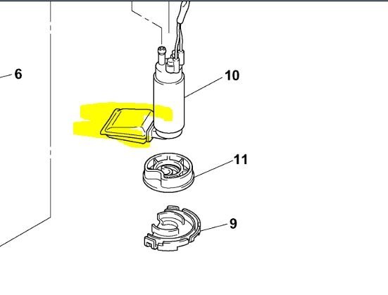

The fuel lines themselves are not associated with the electrical system. What do you mean you blow the lines? Are you forcing compressed air into the lines? If that is the case, have you checked to see if the fuel pump is producing pressure? Have you checked to see if the fuel filter is plugged? On this vehicle, the filter is part of the fuel pump module. However, there is what I call a sock at the bottom of the pump that could be plugged. Take a look at the picture I attached.

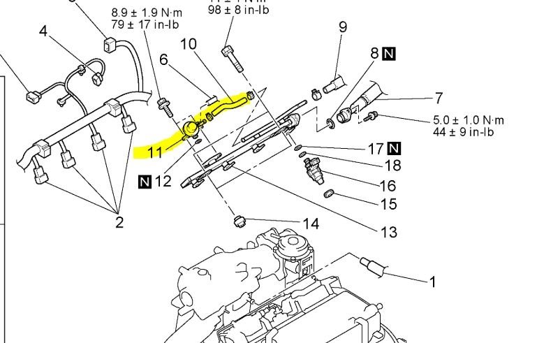

There is a fuel pressure regulator. Do you hear the pump run when you turn the key to the on position? Since it starts when you blow into the fuel line, something is preventing the pump from doing its job.
I attached an exploded view of the fuel rail and components. I highlighted the regulator that I am referring to.

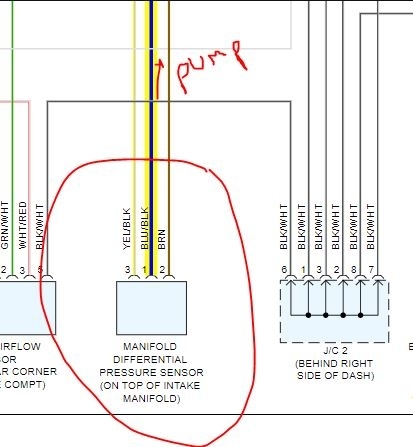

No power to pump until after I blow lines, is there a sensor between tanks?
Sep 19, 2019 at 5:19 AM
  • 110,194 POSTS
Welcome back:

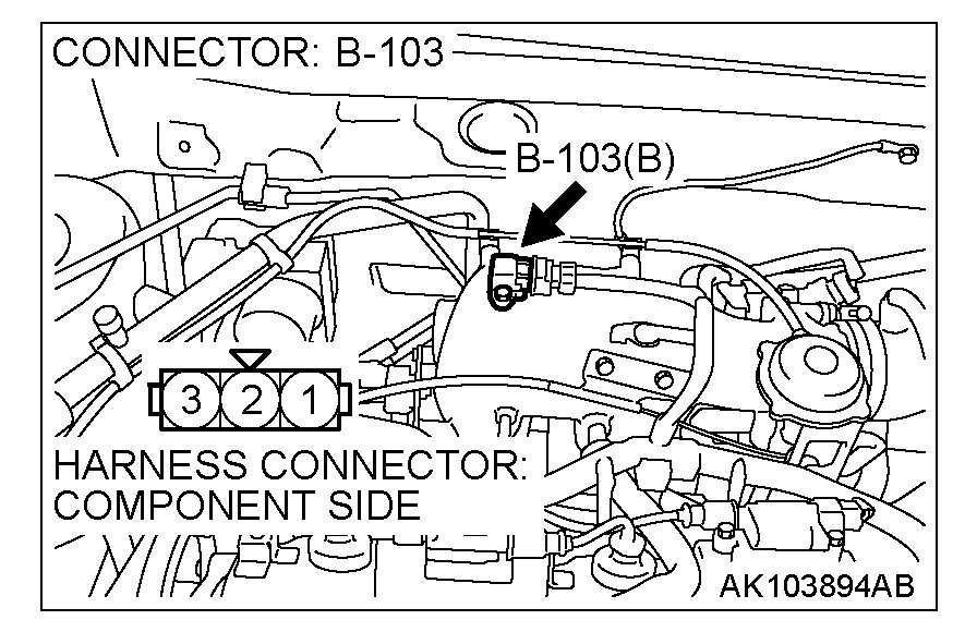

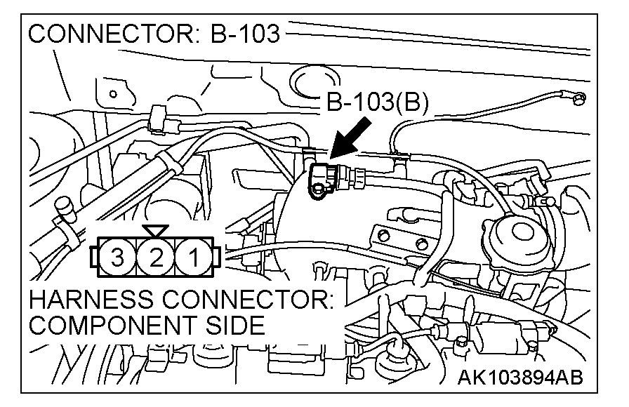

I have to be honest, that doesn't even make sense to me. There is a fuel tank pressure sensor, but that isn't related to this issue (EVAP). There is a manifold differential pressure sensor that could be bad, but I really have to question if that is causing this because you get power when you blow into the hose. Ugh!!!

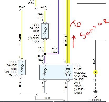

Take a look at the two pics I attached (the first and last pics). One shows the pump and the other the differential pressure sensor. Note that the power to the pump runs through that sensor which then runs to the PCM. That is the only tie in that makes any sense to me. Please understand it's difficult not being there. Also, sorry for the sloppy writing on the pics.
Here are the diagnostics for the sensor I mentioned. All remaining pics correlate with this. I'm adding them if it is something you want to check. However, if this is a problem, you should see a P1400 code. I feel like I am sending you on a wild goose hunt. LOL

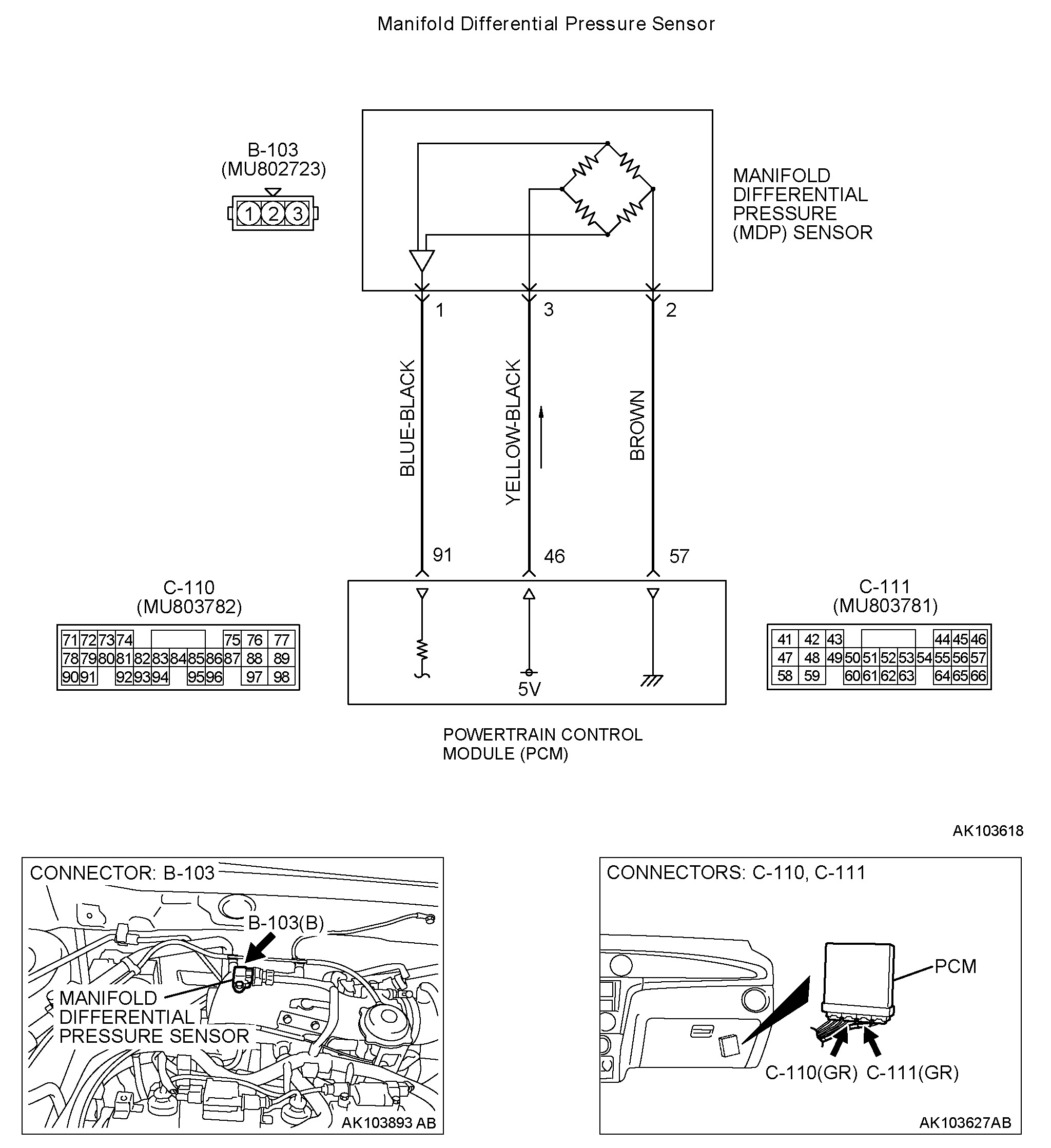

Manifold Differential Pressure Sensor
pic 2
CIRCUIT OPERATION
- A 5-volt voltage is applied on the manifold differential pressure sensor power terminal (terminal No. 3) from the PCM (terminal No. 46). The ground terminal (terminal No. 2) is grounded with the PCM (terminal No. 57).
- A voltage proportional to the pressure in the intake manifold plenum is sent from the manifold differential pressure sensor output terminal (terminal No. 1) to the PCM (terminal No. 91).
TECHNICAL DESCRIPTION
- The manifold differential pressure sensor outputs a voltage which corresponds to the negative pressure in the intake manifold.
- The PCM checks whether the voltage output by manifold differential pressure sensor is within a specified range.

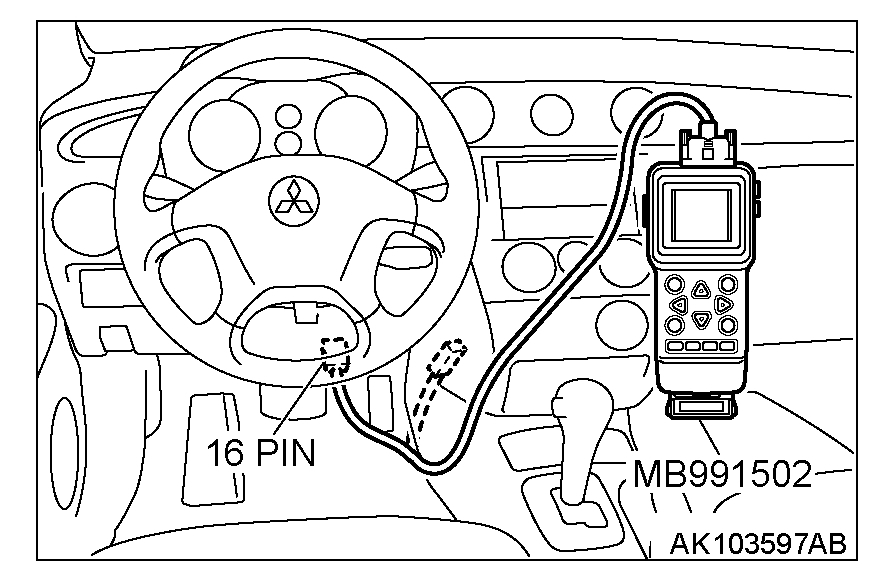

STEP 1. Using scan tool MB991502, check data list item 95: Manifold Differential Pressure Sensor.
pic 3
CAUTION: To prevent damage to scan tool MB991502, always turn the ignition switch to the "LOCK" (OFF) position before connecting or disconnecting scan tool MB991502.
1. Connect scan tool MB991502 to the data link connector.
2. Start the engine and run at idle.
3. Set scan tool MB991502 to the data reading mode for item 95, Manifold Differential Pressure Sensor.
- While engine is idling, pressure should be between 64 and 78 kPa (18.9 - 23.0 in.Hg).
4. Turn the ignition switch to the "LOCK" (OFF) position.
Q: Is the sensor operating properly?
YES: It can be assumed that this malfunction is intermittent. Refer to How to Use Troubleshooting/Inspection Service Points.
NO: Go to Step 2.

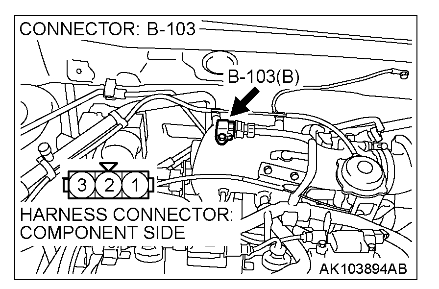

pic 4

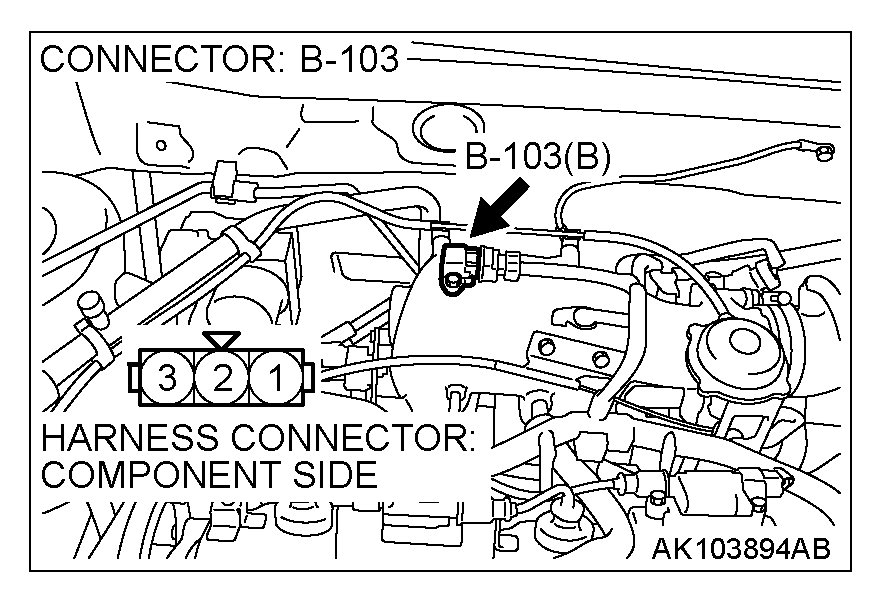

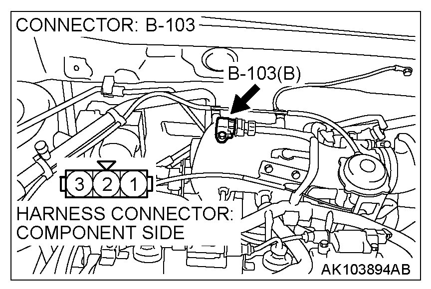

STEP 2. Check connector B-103 at manifold differential pressure sensor for damage.
Q: Is the connector in good condition?
YES: Go to Step 3.
NO: Repair or replace it. Refer to Harness Connector Inspection. Then go to Step 12.

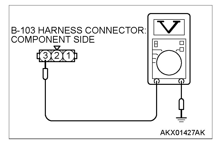

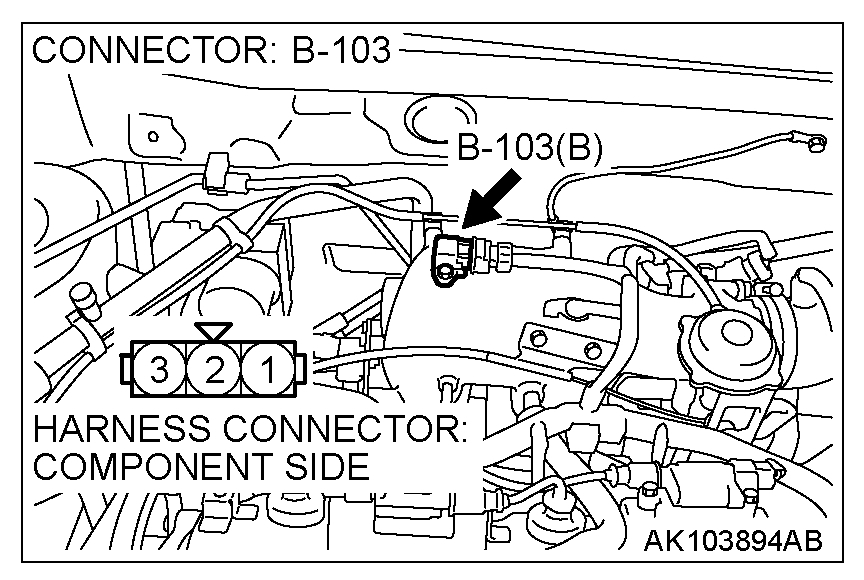

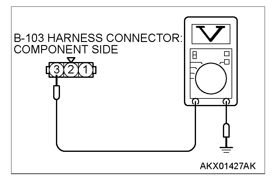

STEP 3. Measure the sensor supply voltage at manifold differential pressure sensor harness side connector B-103.
pic 5
1. Disconnect the connector B-103 and measure at the harness side.
2. Turn the ignition switch to "ON" position.
pic 6

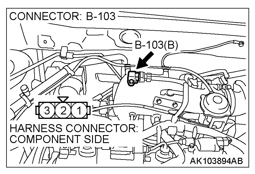

3. Measure the voltage between terminal No. 3 and ground.
- Voltage should measure between 4.8 and 5.2 volts.
4. Turn the ignition switch to "LOCK" (OFF) position.
Q: Is the measured voltage between 4.8 and 5.2 volts?
YES: Go to Step 6.
NO: Go to Step 4.

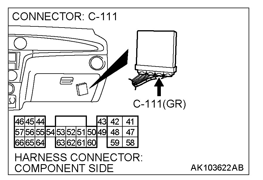

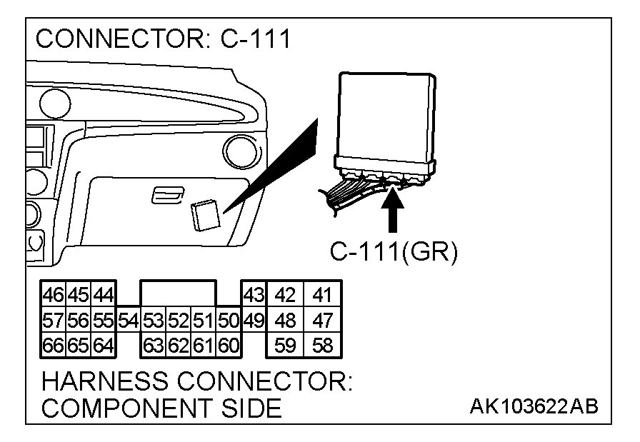

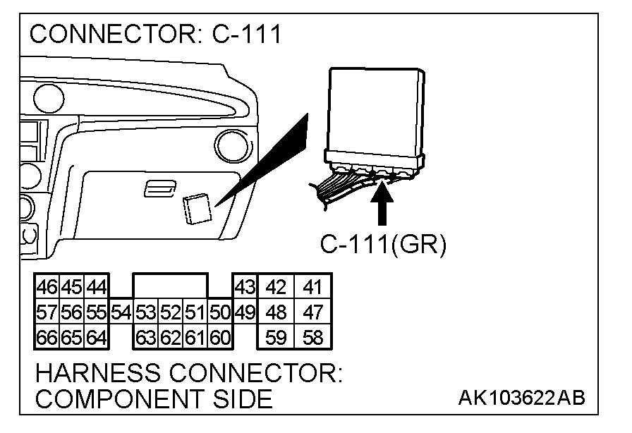

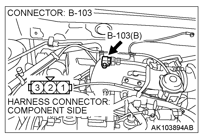

STEP 4. Check connector C-111 at PCM for damage.
YES: Go to Step 5.
pic 8
pic 9
STEP 5. Check for open circuit and short circuit to ground between manifold differential pressure sensor connector B-103 (terminal No. 3) and PCM connector C-111 (terminal No. 46).

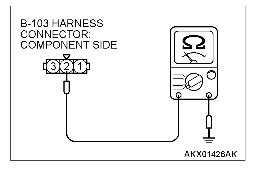

STEP 6. Check for continuity at manifold differential pressure sensor harness side connector B-103.
pic 10
pic 11
2. Measure the continuity between terminal No. 2 and ground.
- Should be less than 2 Ohms.

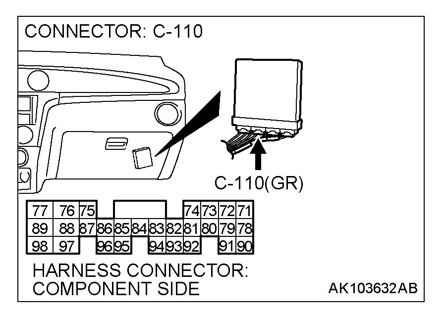

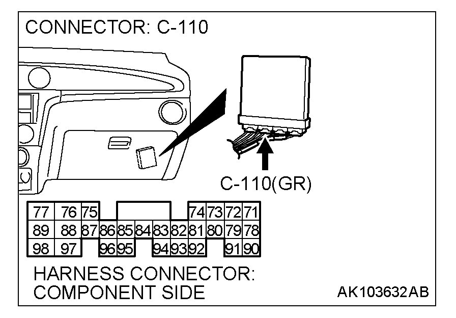

STEP 9. Check connector C-110 at PCM for damage.
YES: Go to Step 10.
pic 16
pic 17
