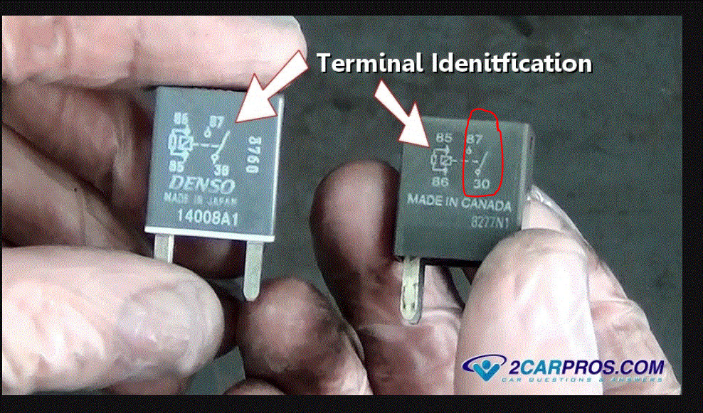

Relays and fuses are good. Car sat for 1 year. Brand new fuel pump installed. Still no power. What do I do now?

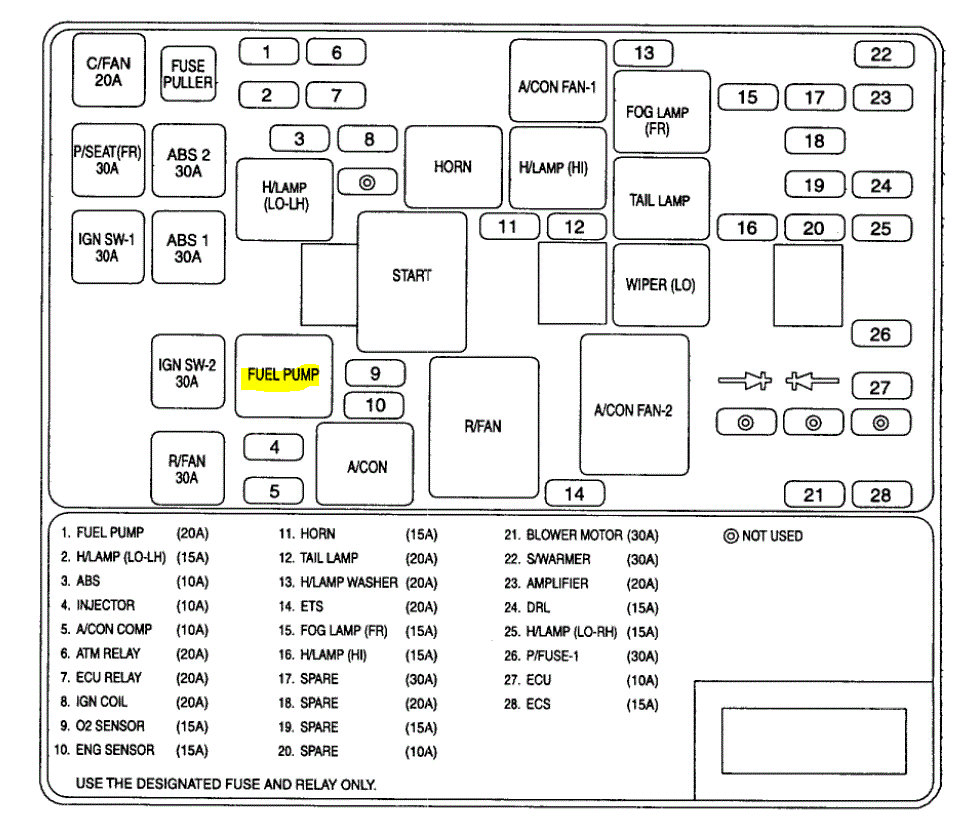

If you have access to the fuel pump, check the white wire in the harness for power when the key is first turned on.
Or remove the fuel pump relay and look at the bottom. There will be 4 pins each numbered 85, 86, 87, 30.
With a jumper wire, jump the two pins where numbers 30 and 87 plug into the relay box. By doing this, it should turn the fuel pump on. Do this and let me know the results.
Also, here is a link you may find of interest:
Let me know what you find.
See pics below. Pic 2 shows the fuel pump relay in the under-hood fuse box.

I did what you suggested. Used jumper wire. Fuel pump is pumping. I have fuel pressure. Car still will not run. I did notice that an indicator light in the dash was flashing. It's orange, the shape of a car with a key in the middle. Could this be the anti-theft? The car was wrecked. It has been sitting for over a year, battery is not good, and I tried jump starting it. And I also found out that the key I have is not the original key. Key was cut, but not programmed. And the car has no key fob. So, my question is, is it the anti-theft? And do I need to get it towed to dealership to deal with anti-theft reset?
