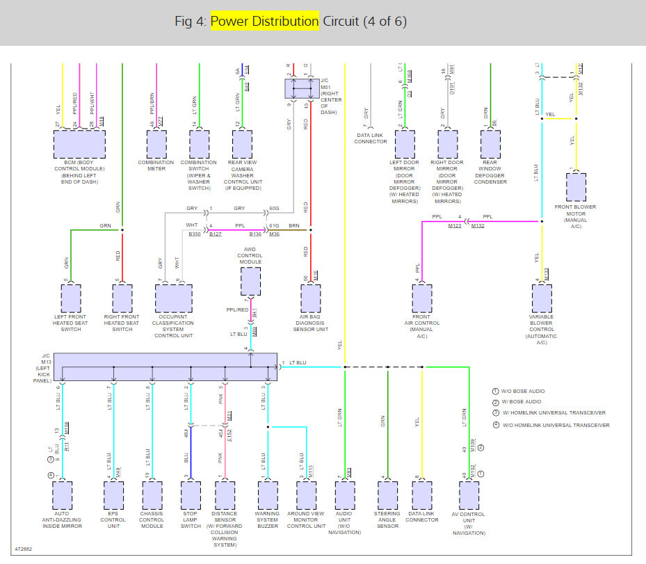

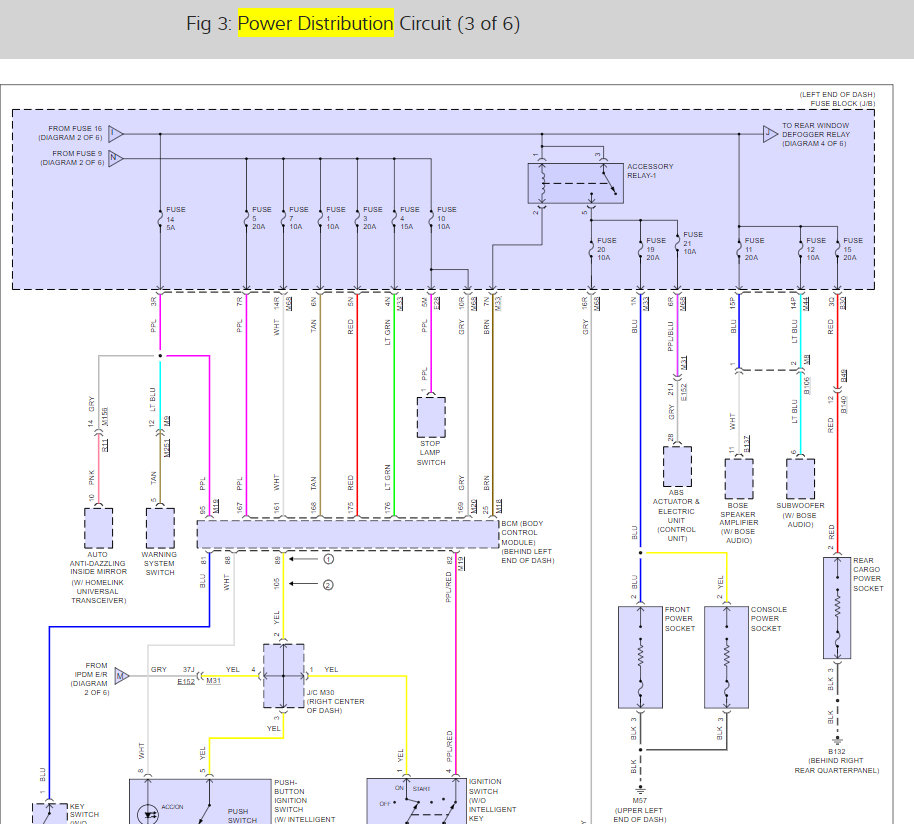

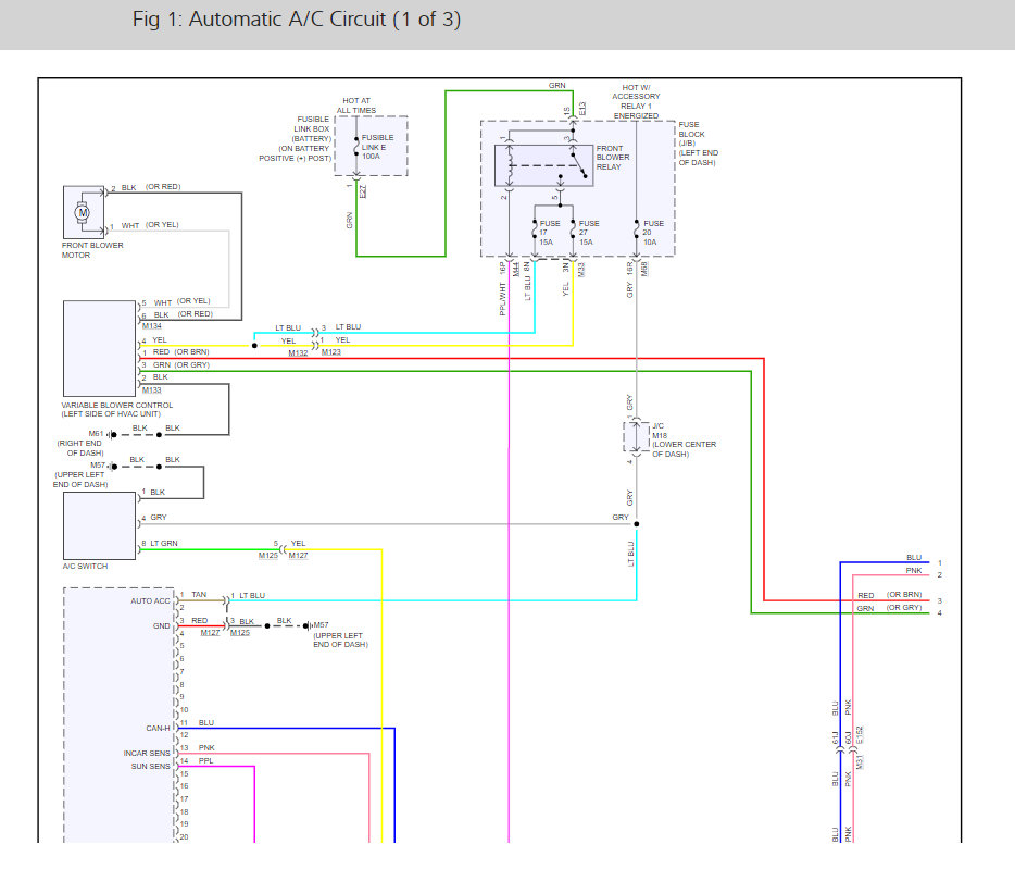

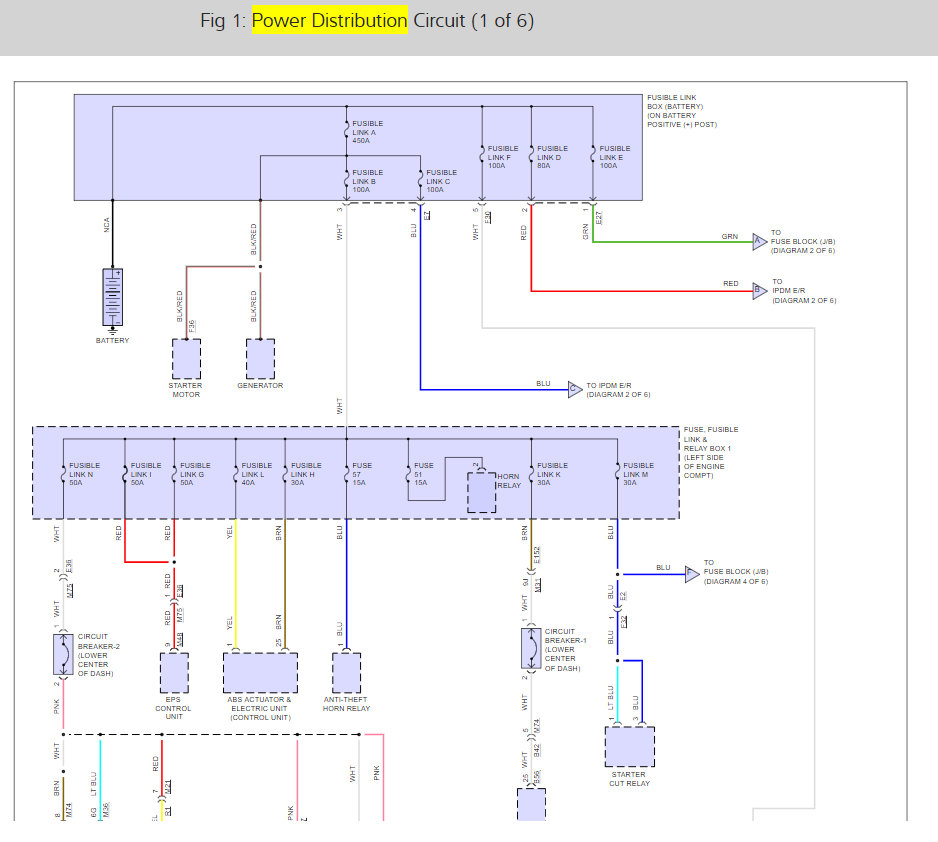

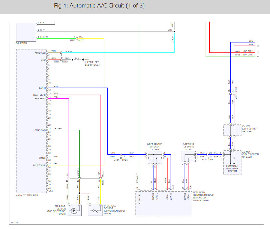

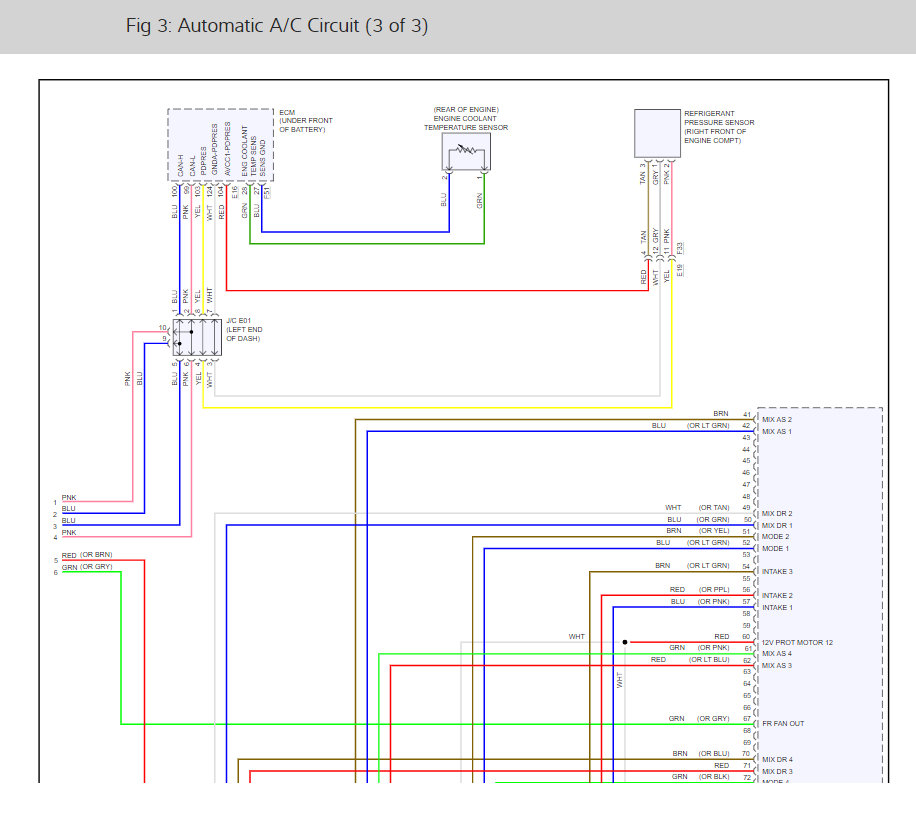

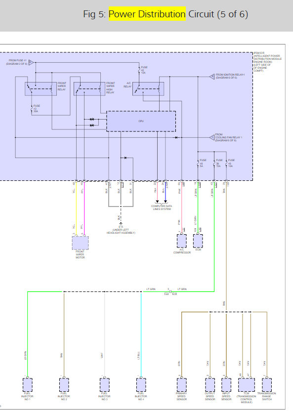

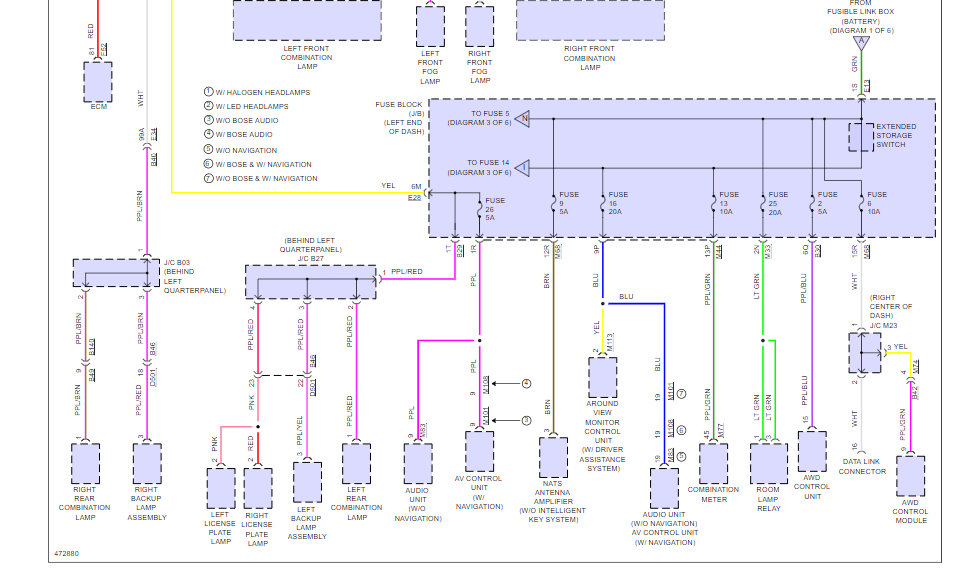

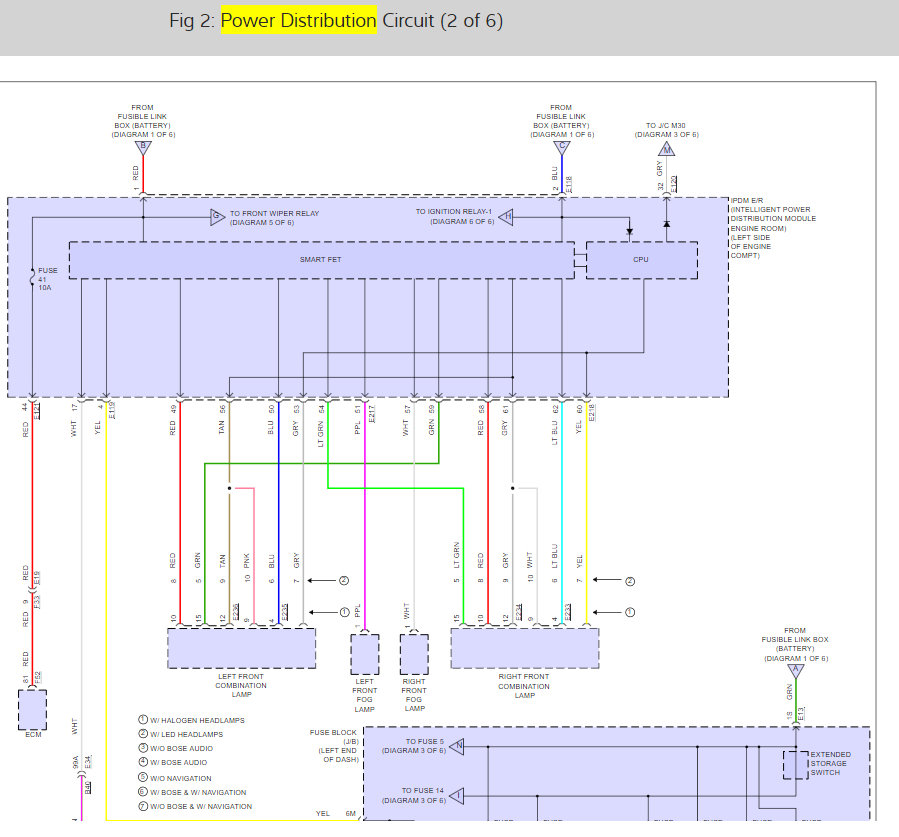

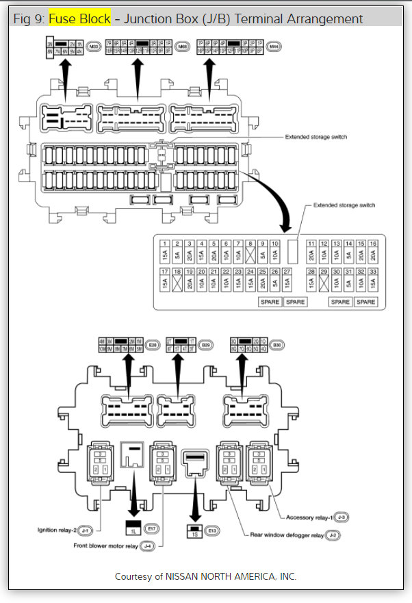

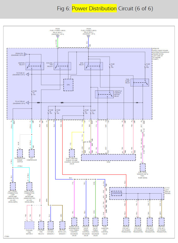

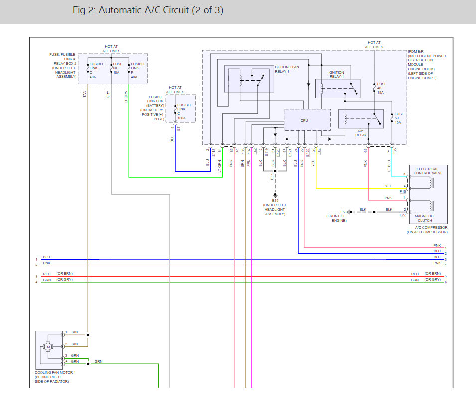

I recently changed my battery to discover there was no power to the A/C controls. I checked the 10A fuse (it's okay) but could it be the relay that got fried when I changed the battery? The fuse I checked was for ACC (I assumed it was the A/C) behind the panel when you open the driver door. I did not check the one under the hood.
Sep 22, 2019 at 11:02 PM
  • 55,421 POSTS
Hello

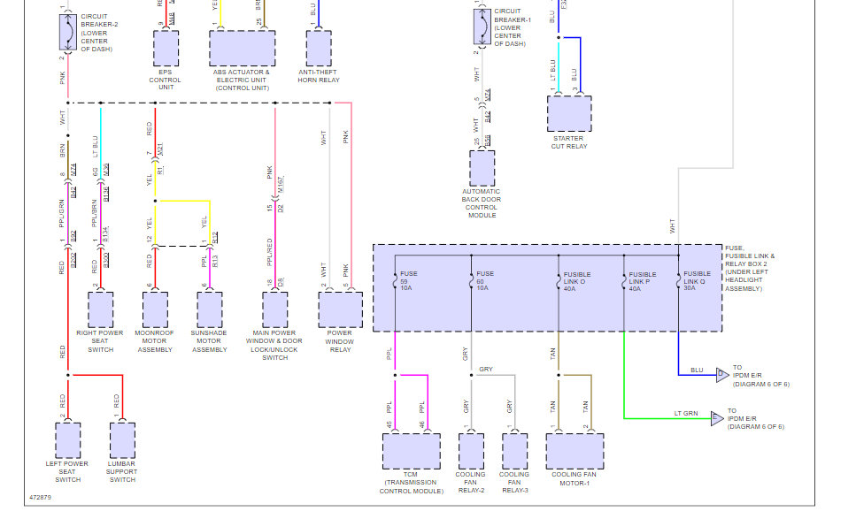

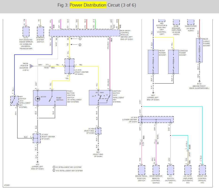

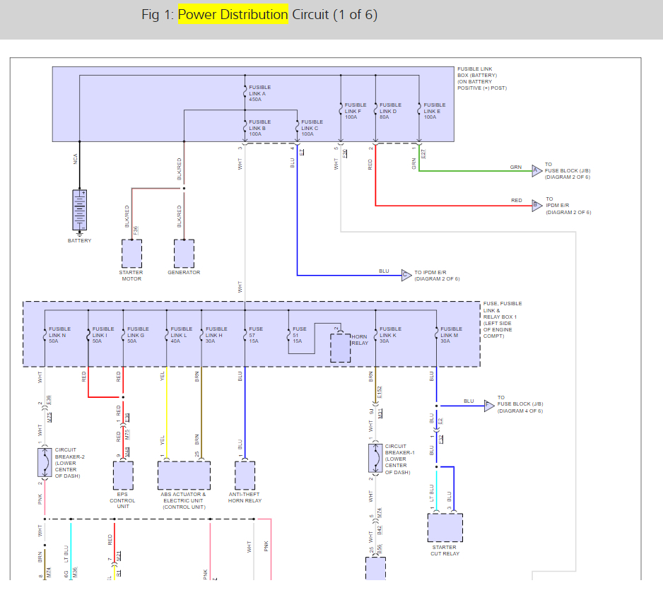

There are 7 fuses and three fusible links that need to be checked. can I ask if a set of jumpers was used backwards? if so it could have taking out a fusible. Here is a guide to help check the fuse and for power with the air conditioner heater wiring diagrams so you can see which fuses to check and how the system works. Also the fuse locations are below as well.
