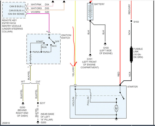

I've tested the wiring harness up to the plug where it plugs into the bottom for the fuse box, but when i plug it in i get two dead fuses that won't get power, but all the other ones do.
The two fuses are for starting and running the car.
I can use a wire from that fuse to the battery and the car will start but then i won't get any throttle body with the gas pedal.
Mar 7, 2022 at 11:07 PM
  • 110,244 POSTS

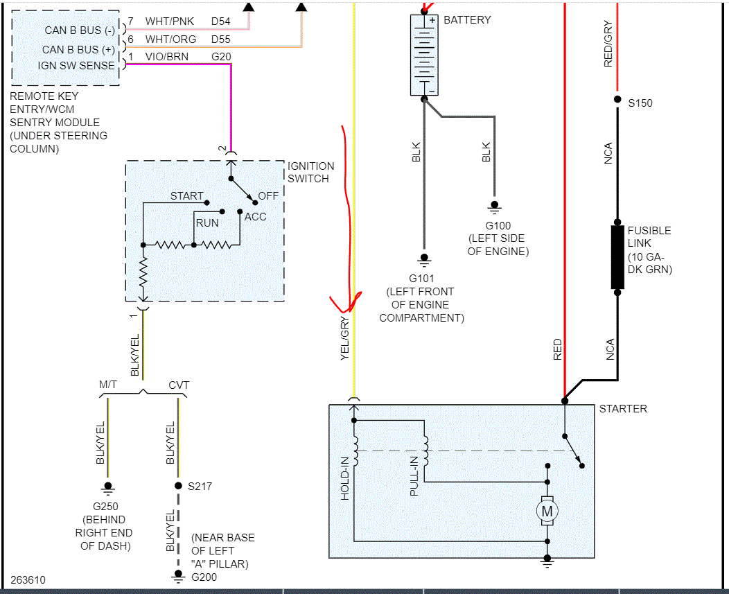

Which fuses are you not getting power to? Also, there should always be 12v at the larger wire on the starter. The smaller (yellow with a gray tracer) only gets power with the key in the start position.

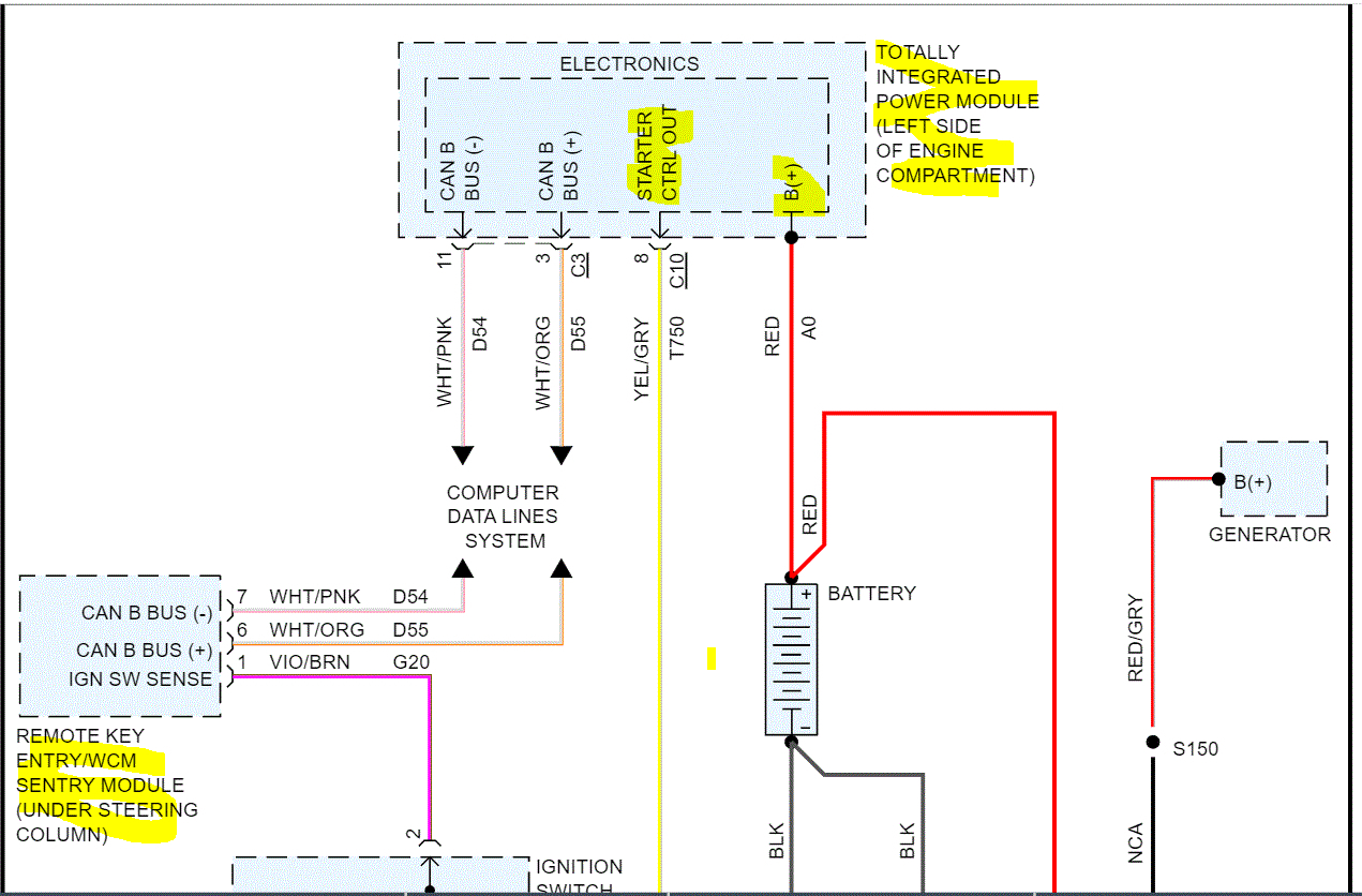

The power comes from the totally integrated power module (TIPM). Is that where you are not getting power? I ask because the TIPM's are known for connector issues. Because they are small connectors with many pins, they end up breaking, corroding, or being pushed back in, as a result, you get no power, or the power supply fails when a load is placed on it.
Let me know if that is what you are referring to. Also, I attached the wiring schematic below for the starting circuit. I figured you could use it as a guide.
