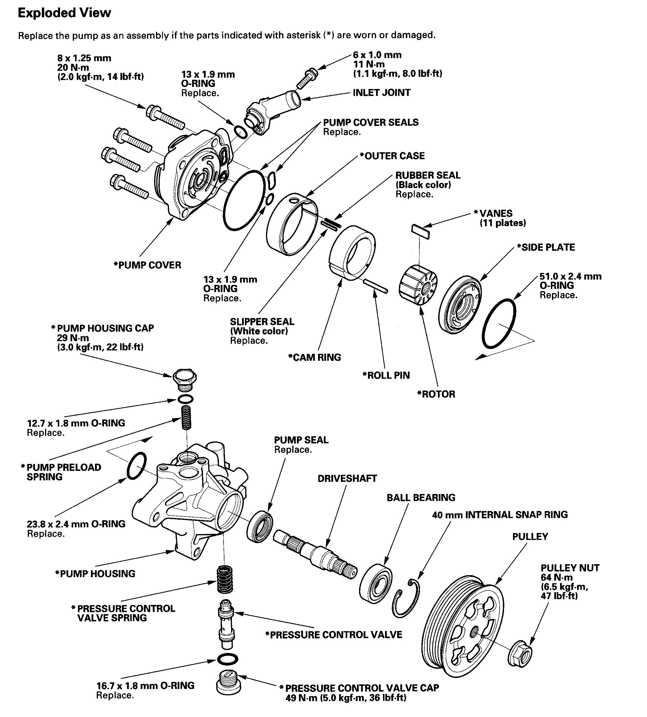

Pump was leaking and it was removed and rebuilt. Now there is no power steering at all.
(May be important to note that the pressure sensor seal was not replaced as I did not have the right size hex. The leak was obviously elsewhere so I left it.)
No whining, no noises, no leaks, no foam. Jacked it up and turned from lock to lock for about 45 minutes and bled until there were no more bubbles. Plenty of fluid. No power steering.

Did you remove the pulley? If so, is it properly reinstalled? Do you see any circulation on the fluid with the engine running?
Here are the specific directions for overhauling the pump. Take a look through them to see if you may have missed anything. The attached pics correlate with the directions.

PUMP OVERHAUL
Pump Overhaul
Pump
pic 1
Special Tools Required
^ Driver 07749-0010000
^ Attachment, 28 x 30 mm 07946-1870100
^ Pulley holder 07ZAB-S5A0100
Disassembly
NOTE: Refer to the Exploded View as needed during the following procedure.
1. Drain the fluid from the pump.
2. Remove the power steering pump.

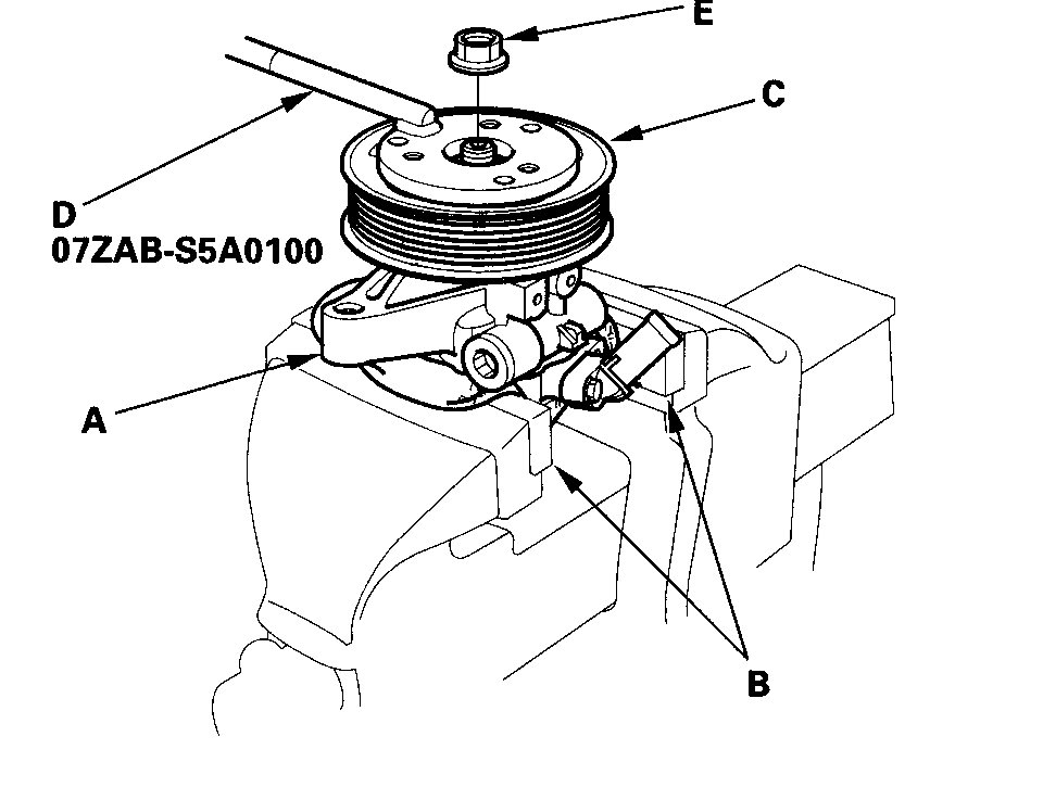

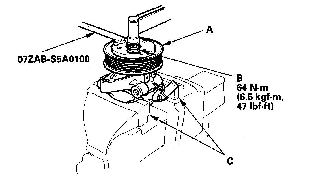

3. Hold the steering pump (A) in a vise with soft jaws (B), hold the pulley (C) with the pulley holder (D), and remove the pulley nut (E) and pulley. Be careful not to damage the pump housing with the jaws of the vise.

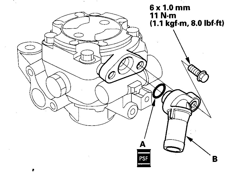

4. Remove the inlet joint and O-ring.

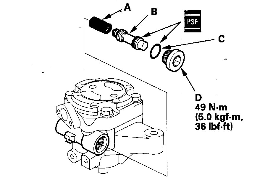

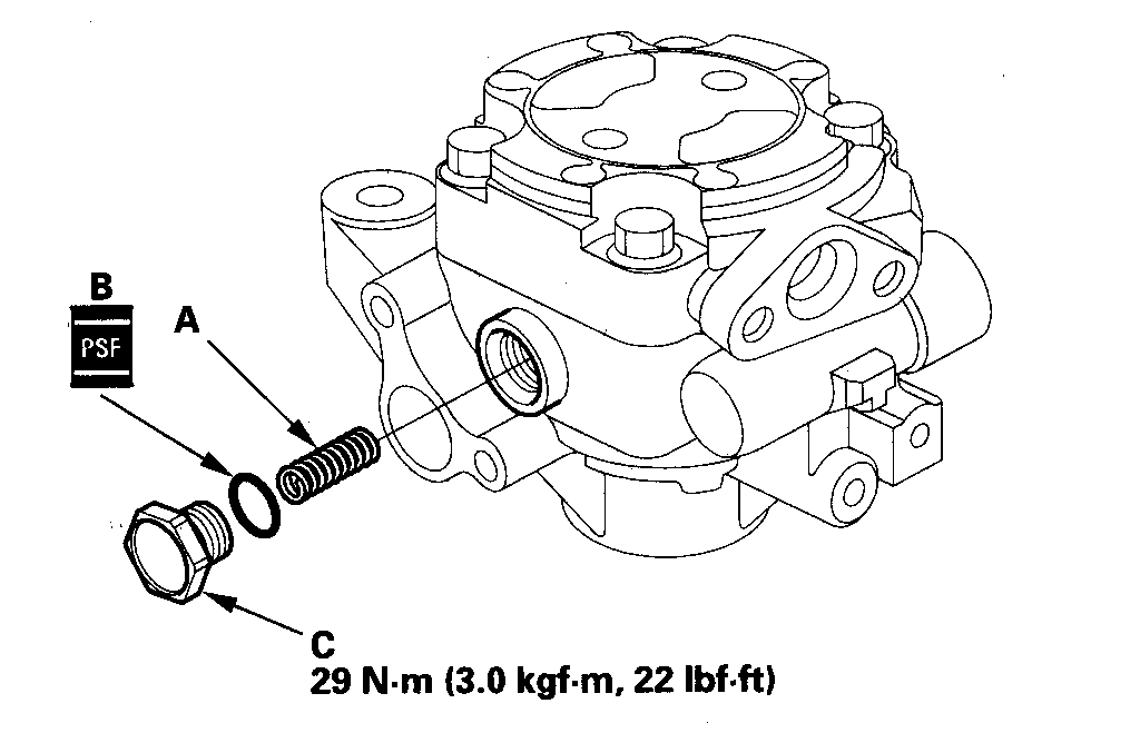

5. Remove the pressure control valve cap, O-ring, valve spring, and pressure control valve.

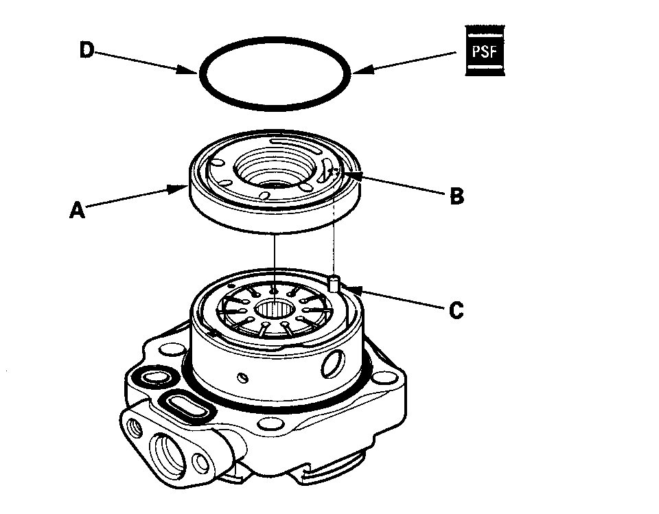

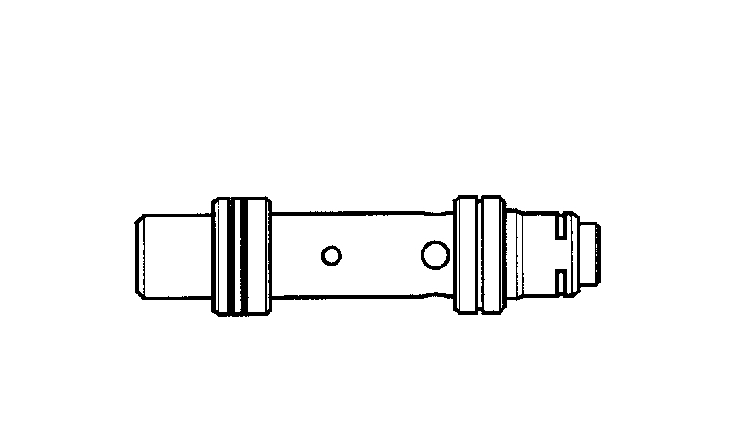

14. Check the pressure control valve for wear, burrs, and other damage to the edges of the grooves in the valve.
pic 3
15. Inspect the bore of the pressure control valve on the pump housing for scratches and wear.

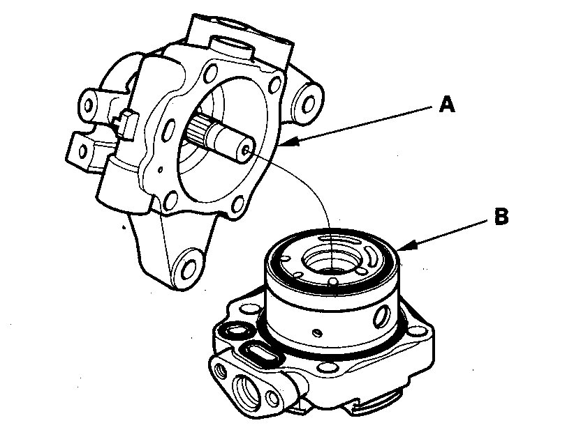

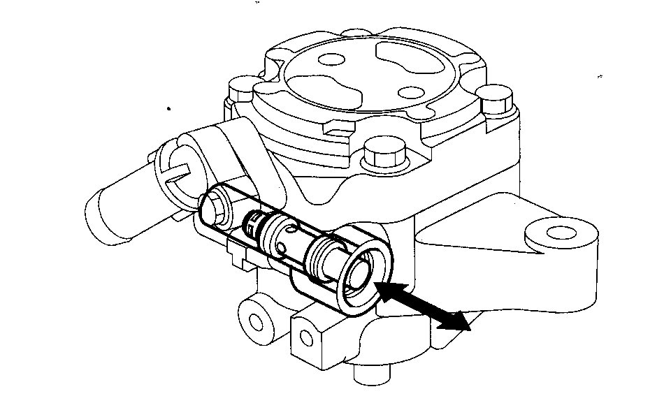

16. Slip the pressure control valve back in the pump housing, and check that it moves in and out smoothly. If OK, go to step 17; if not, replace the pump as an assembly. The pressure control valve is not available separately.
pic 4

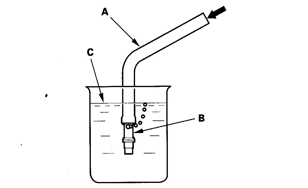

17. Attach a hose (A) to the end of the pressure control valve (B) as shown. Then submerge the pressure control valve in a container of power steering fluid or solvent (C), and blow in the hose.
^ If air bubbles leak through the valve at less than 98 kPa (1.0 kgf/cm2, 14.2 psi), replace the pump as an assembly. The pressure control valve is not available separately.
^ If the pressure control valve is OK, set it aside for reassembly later.

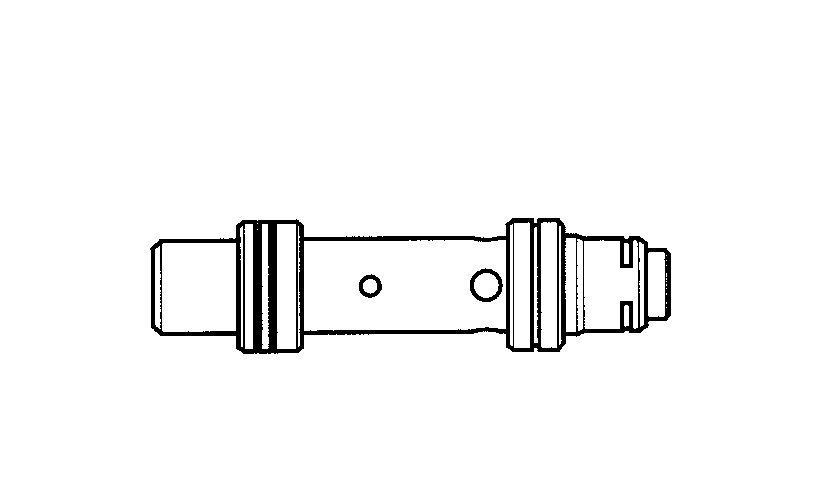

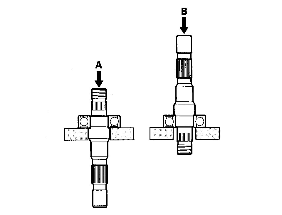

18. Inspect the ball bearing by rotating the outer race slowly. If you feel any play (axial or radial) or roughness, remove the faulty ball bearing (A), and install a new one (B).
pic 6

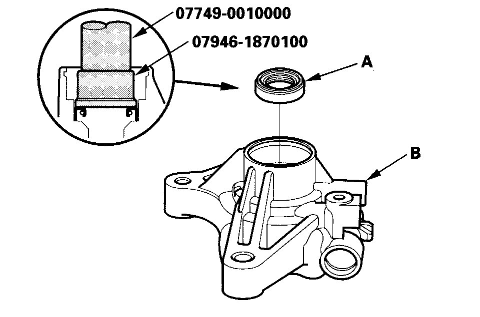

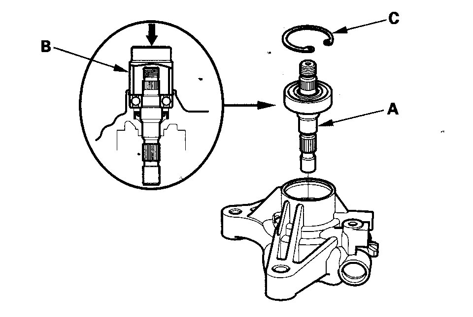

20. Install the new pump seal (A) (with its grooved side facing in) into the pump housing (B) by hand, then drive it in using the driver until the seal is fully seated in the pump housing. Do not apply more than 1,370 N (140 kgf, 308 lbf) of pressure.
pic 7
21. Position the pump driveshaft (A) in the pump housing, then press it in with the appropriate size socket wrench (B) as shown.
pic 8
22. Install the 40 mm internal snap ring (C) with its radiused edge facing out.

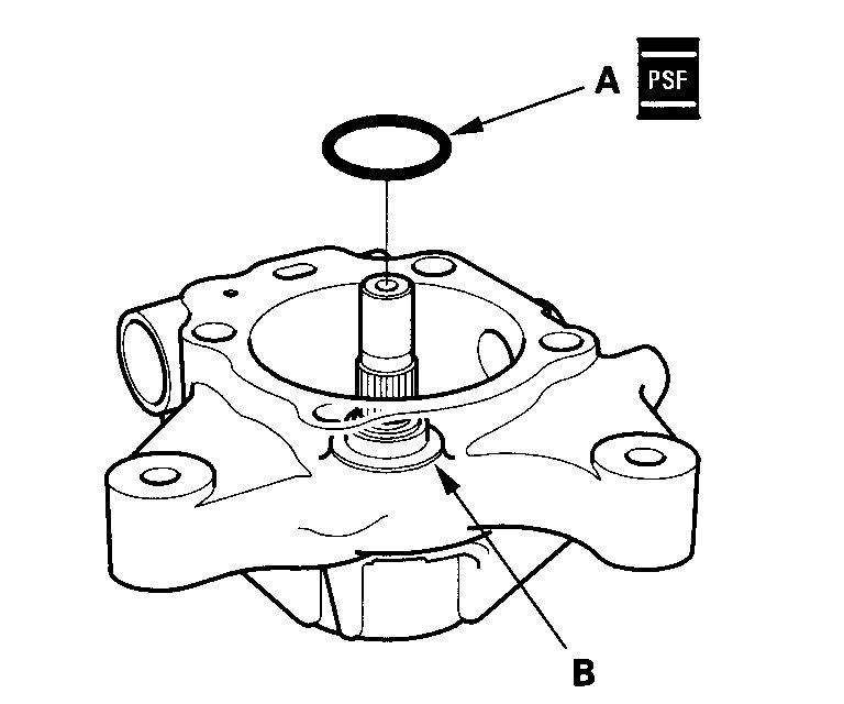

23. Coat the new 23.8 mm O-ring (A) with power steering fluid, then position it on the bottom (B) of the pump housing.

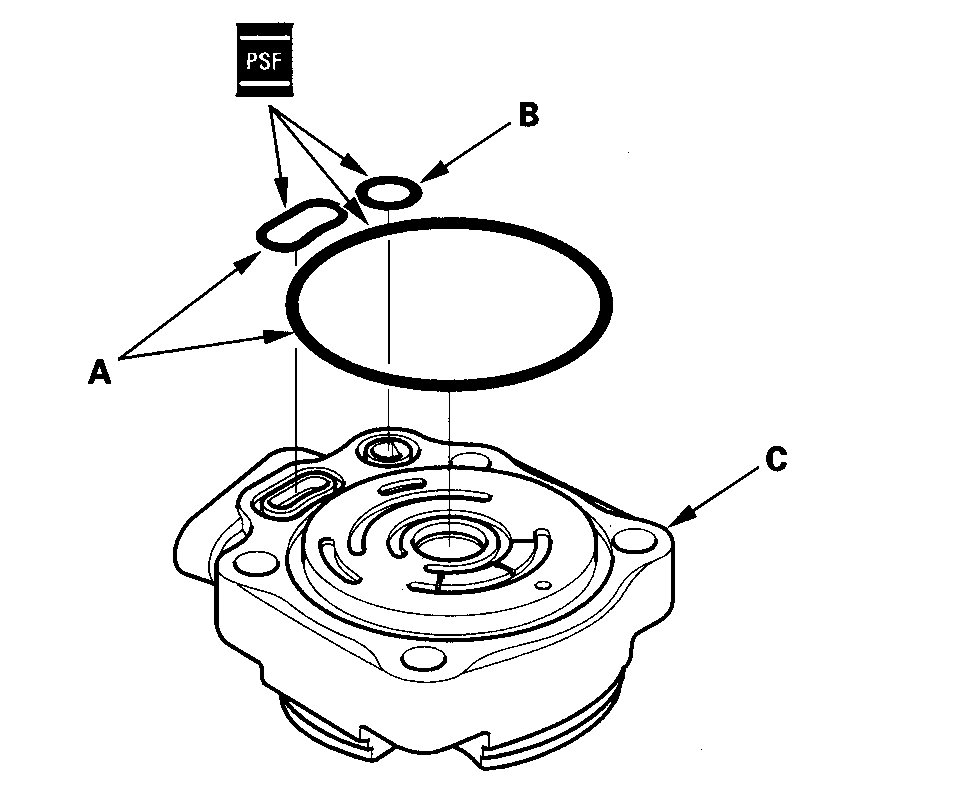

24. Coat the new cover seals (A) and new 13.0 mm O-ring (B) with power steering fluid, then position them into the grooves on the cover (C).
NOTE: Be careful not to install the inlet joint O-ring because they are the same size.

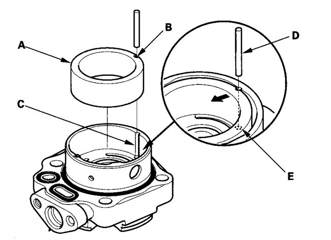

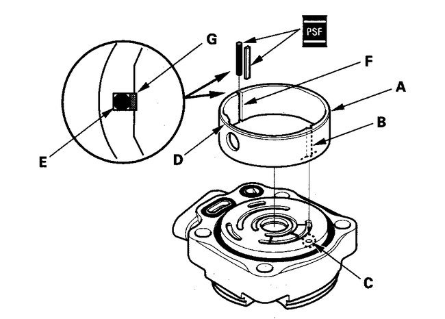

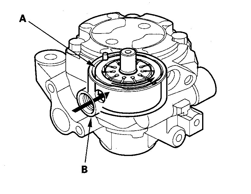

25. Install the outer case (A) by aligning the slot (B) inside the outer case with the cover roll pin hole (C). Be sure that the tapered side (D) of outer case is facing up.
pic 11
26. Apply, power steering fluid to the rubber seal (E) (black), and install it in the slot (F) of the outer case.
27. Apply power steering fluid to the slipper seal (G) (white), and install it on top of the rubber seal you just installed.

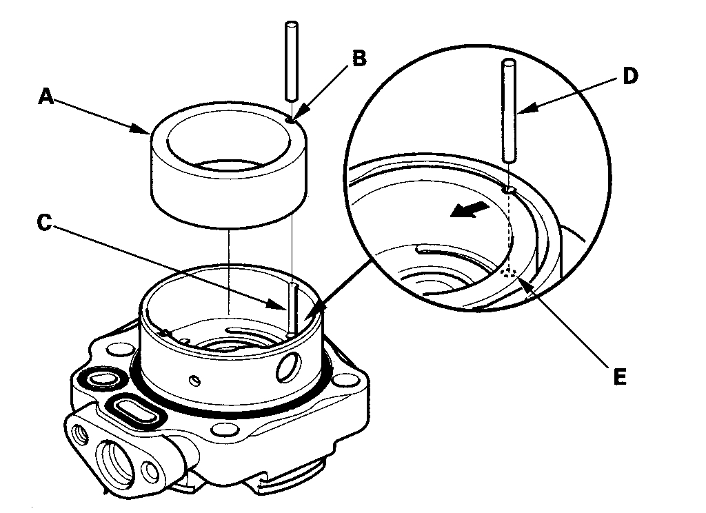

28. Install the cam ring (A) by aligning the slot (B) with the slot (C) in the outer case.
pic 12
29. Insert the roll pin (D) into the slots between the cam ring and outer case, then push the roll pin into the set hole (E).

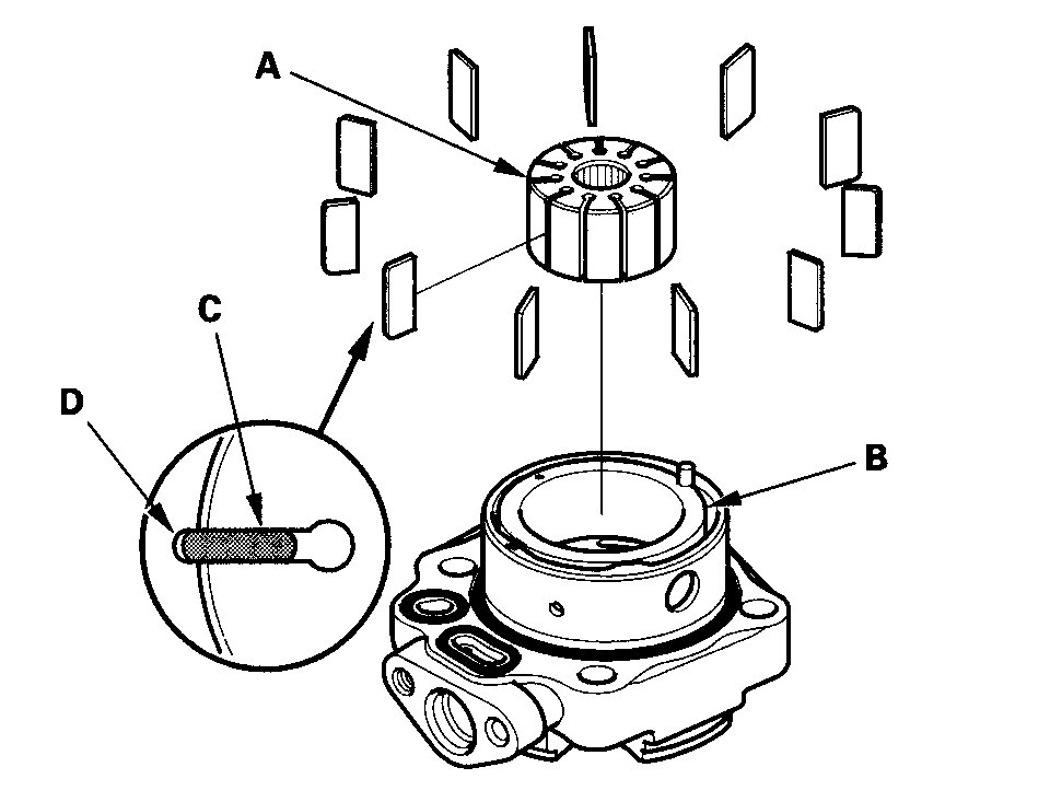

30. Install the rotor (A) in the cam ring (B).
pic 13
31. Set the 11 vanes (C) in the grooves in the rotor. Make sure that the gold-colored ends (D) of the vanes are in contact with the sliding surface of the cam ring.

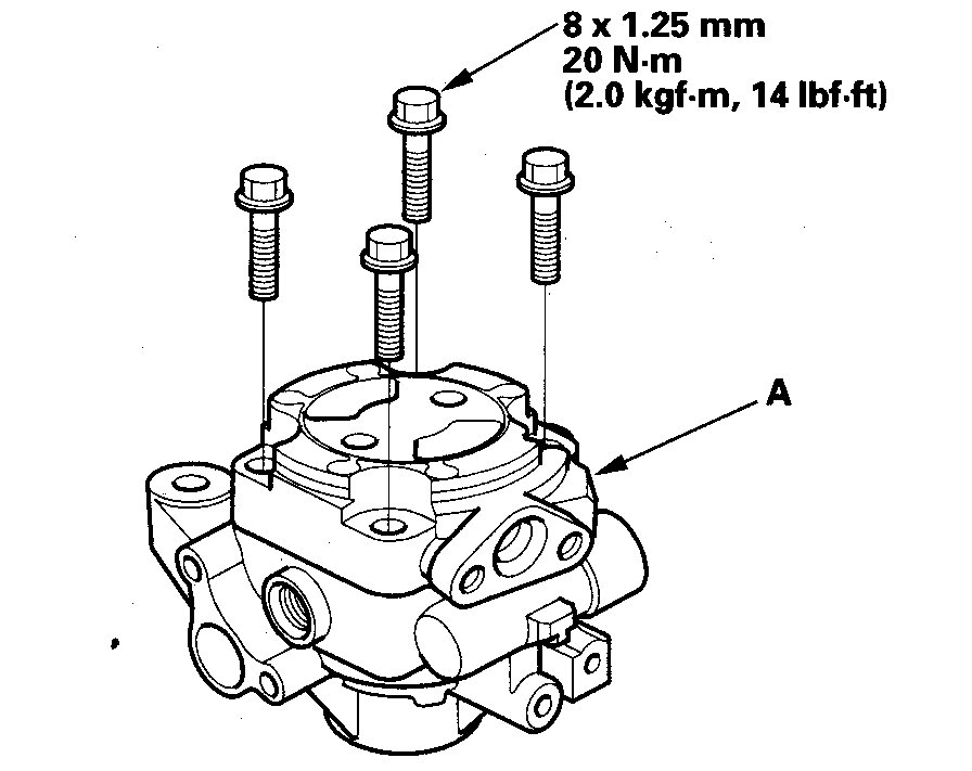

35. Align the bolt holes in the cover (A) with the threaded holes in the pump housing. Install the flange bolts loosely first, then torque the flange bolts in a criss-cross pattern in two or more steps.

39. Install the pump housing cap on the pump housing, and tighten it to the specified torque.
40. Install the pressure control valve spring (A) in the pump housing.
pic 19
41. Coat the pressure control valve (B) with power steering fluid, and install it in the pump housing.
42. Coat the new 16.7 mm O-ring (C) with power steering fluid, and install it on the pressure control valve cap (D).
43. Install the pressure control valve cap on the pump housing, and tighten it to the specified torque.

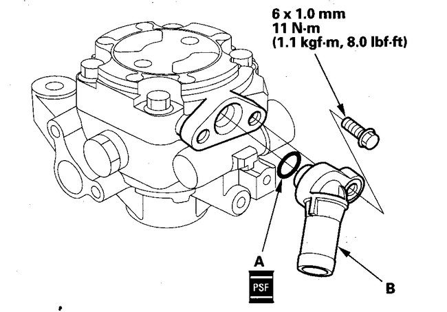

44. Coat the new O-ring (A) with power steering fluid, and install it on the inlet joint (B).
pic 20
45. Install the inlet joint on the pump housing.
46. Install the pulley (A), then loosely install the pulley nut (B). Hold the steering pump in a vise with soft jaws (C). Be careful not to damage the pump housing with the jaws of the vise.
pic 21
47. Hold the pulley with the pulley holder, and tighten the pulley nut to the specified torque.
