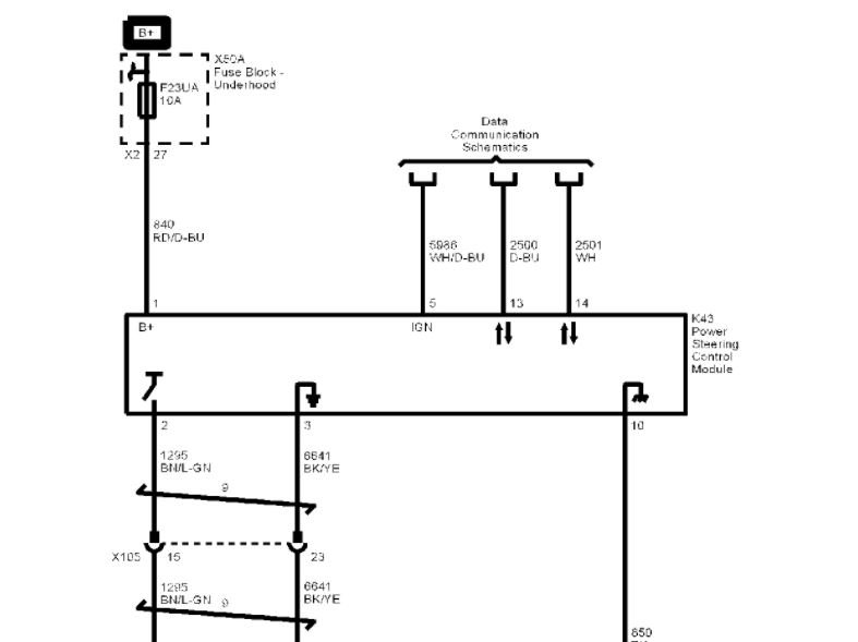

Yesterday the dash lights came on for the ABS system and the traction control system. Additionally, a warning came up to service the power steering system and the traction control systems. The car currently is driveable but has no power steering. I am assuming ABS And traction control are off too. I found a technical service bulletin that suggests it may be a fuse, but I cannot find a fuse for power steering in owners manual diagram. Is it combined with something else that I should be looking for?

You have two separate issues. Attached is a wiring diagram that shows the fuse for the power steering. If the fuse is blown, it blows for a reason and the failure needs to be determined.
As far as the ABS, there is a fault code stored in the system for the failure. A parts store will read it for you for free and once we know the code we can help narrow the area of failure.
