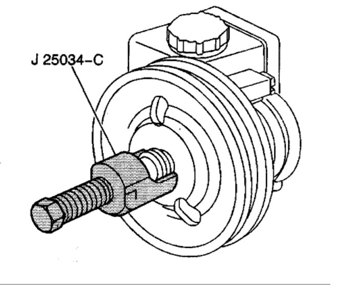

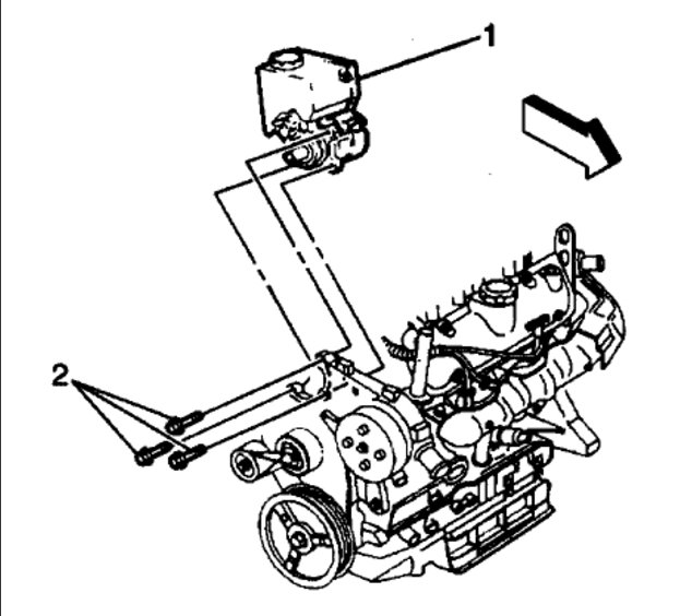

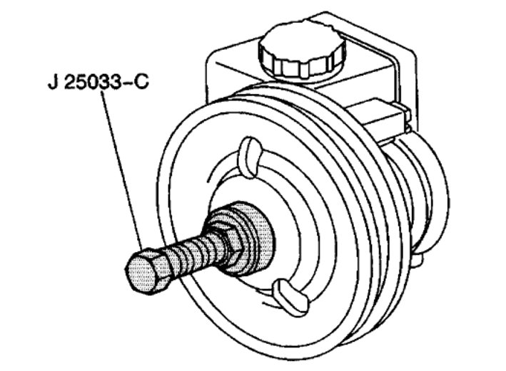

It sounds like the pump was run dry and it is now not supplying any pressure. I would start by replacing the pump.
Here is a guide and some diagrams (below) to help you get the job done:
https://www.2carpros.com/articles/how-to-replace-a-power-steering-pump
