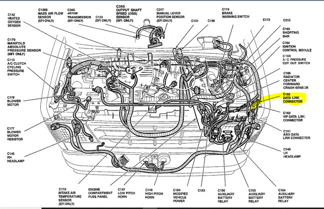

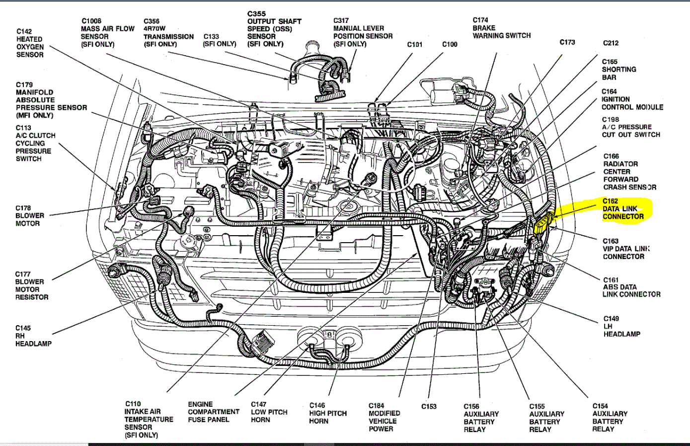

Just to confirm. The data link connector is under the hood on this vehicle. See pic 2 for location.

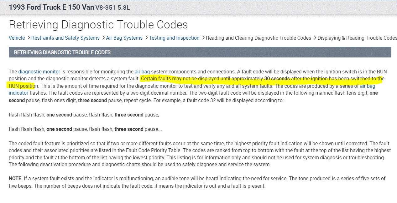

Next, how long did you wait for the codes to appear? Some codes will require up to 30 seconds before they are indicated. See pic 1
