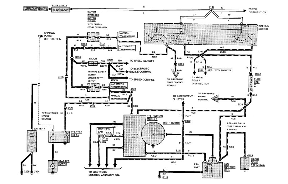

Just dropped a rebuilt motor into my truck and have all the wiring hooked up correctly, but my ignition coil won’t put out a spark. I’ve tried several new coils and still nothing. I have power all the way to the coil just nothing coming from it, to the distributor cap.
Sep 7, 2019 at 12:26 PM
Good morning.
Take a test light and test for power on the negative side of the coil with the key on.
Then have someone crank the engine and see if the test light flashes. That will tell me if the module is working.

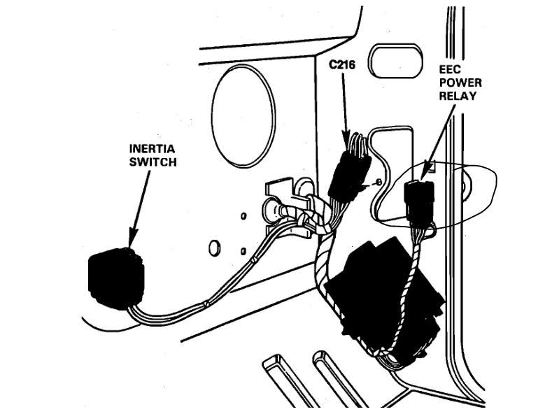

Okay, with the key on, you have no power to the injectors? That comes from the power relay by the fuel pump relay under the hood.
Did you verify no power to the fuel pump?
Sep 10, 2019 at 8:14 AM
CODYJAMES1
  • 18 POSTS
Correct. No power to fuel pump or injectors with key on.
Sep 10, 2019 at 8:21 AM
I attached a picture of the power relay location.
verify power to the relay with the key on. There should be 2 terminals with voltage.

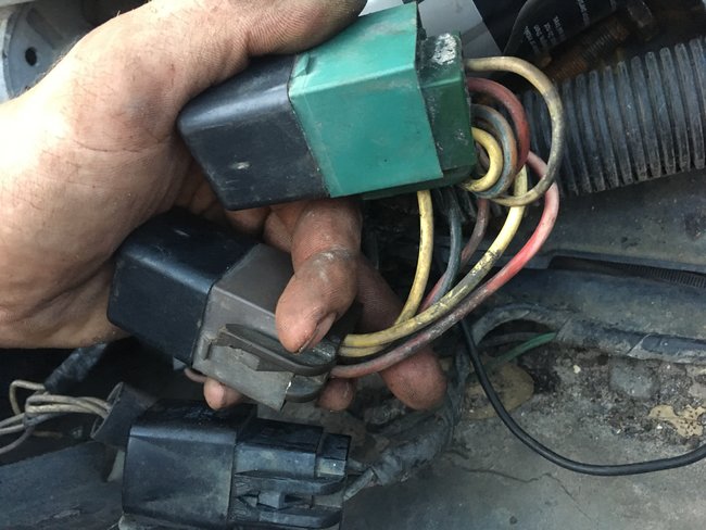

I attached an image of the relays. The middle one only has one terminal with voltage. Red wire with green stripe.
Sep 10, 2019 at 8:34 AM
The green one is the fuel pump relay. The black is the power relay.
Sep 10, 2019 at 8:44 AM
CODYJAMES1
  • 18 POSTS
Okay well the black is the one I tested. The test light only comes on when testing the red wire with green stripe. No other terminals lit up. I’ll get a new relay tomorrow if needed. I’m done working on it for the evening. The truck ran and drove fine until I did the motor swap. Old motor had a broken exhaust manifold.

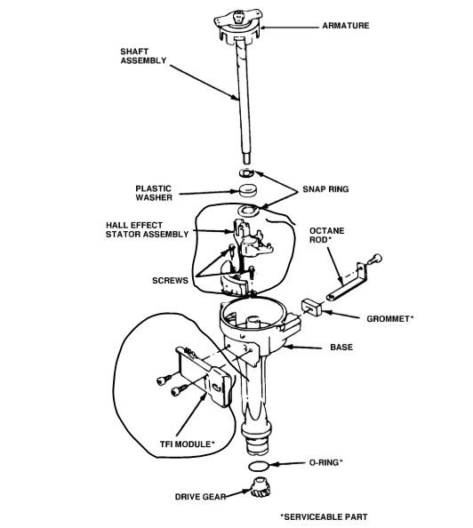

Okay, I did that and neither negative or positive blinks. Stays solid while cranking.
Sep 14, 2019 at 12:13 AM
Okay, the module is not working.
It could be the distributor pick up in the distributor or the module.
