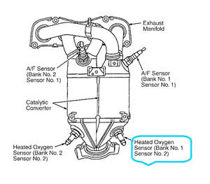

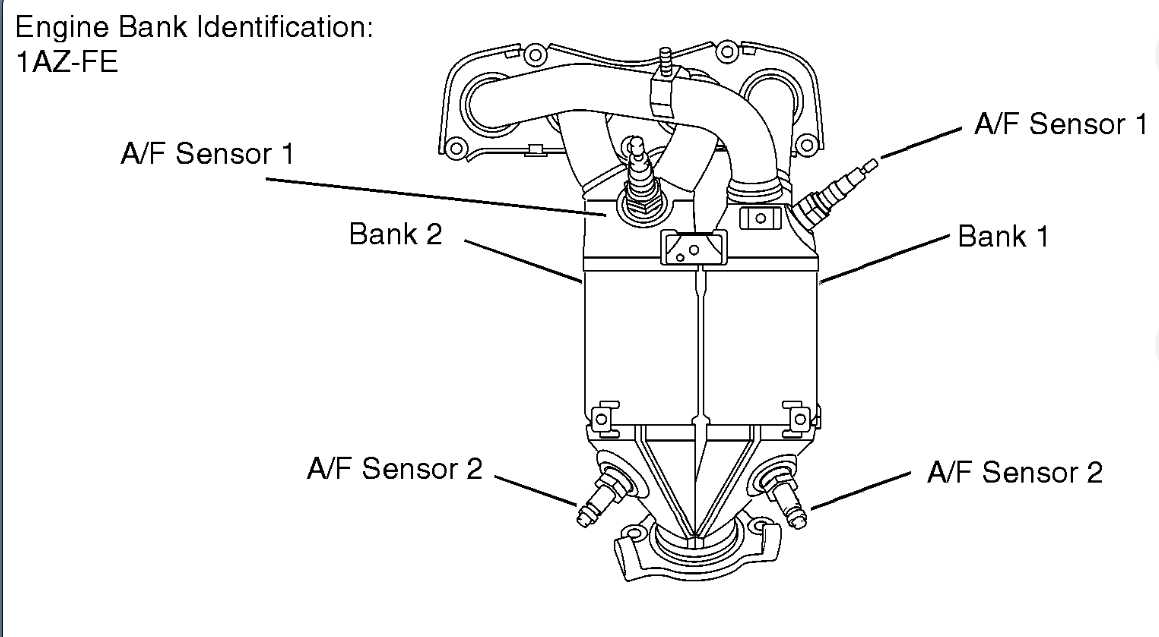

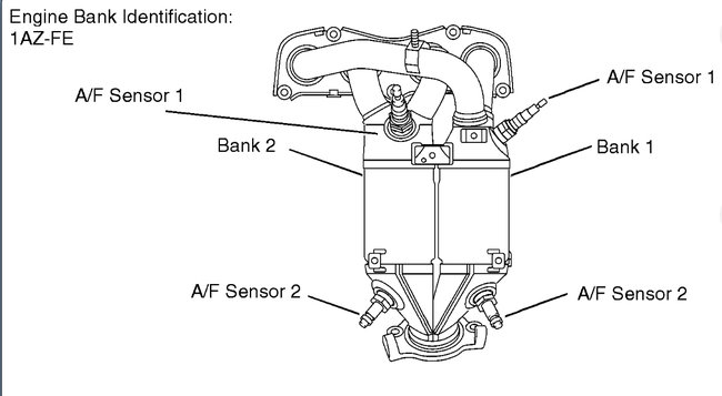

SCGRANTURISMO
  • 4,897 POSTS
Do you have the upstream O2 sensor, by upstream I mean the one before the catalytic converter, closest to the engine in and hooked up?
Thanks,
Alex
2CarPros
Saturday, July 27th, 2019 AT 4:56 AM

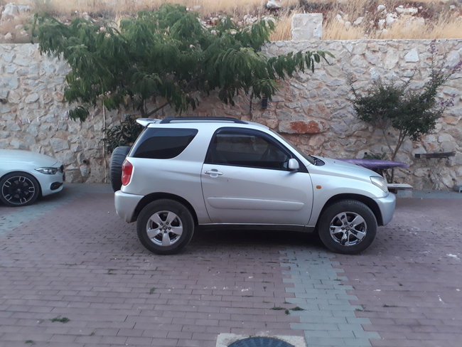

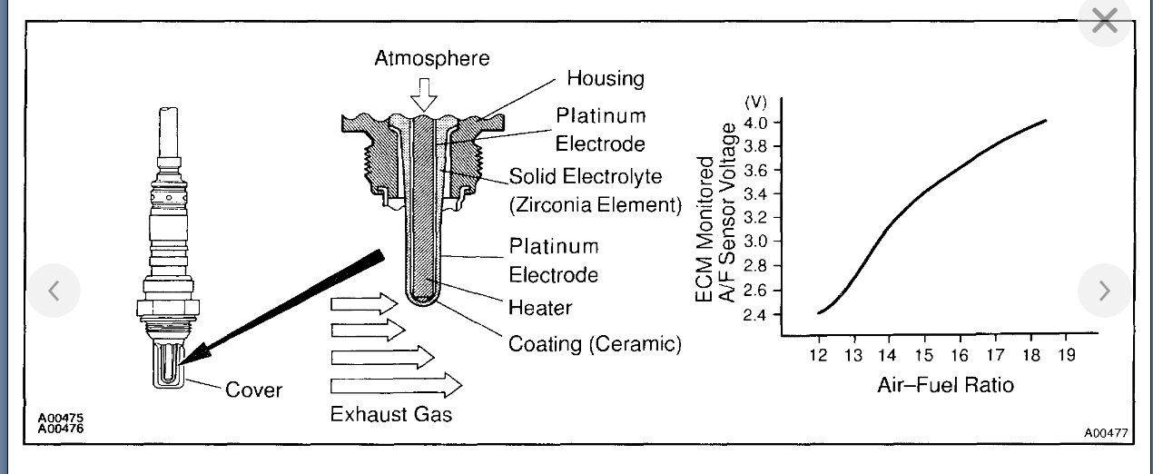

KRATOS1988
  • 7 POSTS
I change the 2 in the top and I still have a fault on them.
See the picture.
Thanks
Saturday, July 27th, 2019 AT 5:08 AM
SCGRANTURISMO
  • 4,897 POSTS

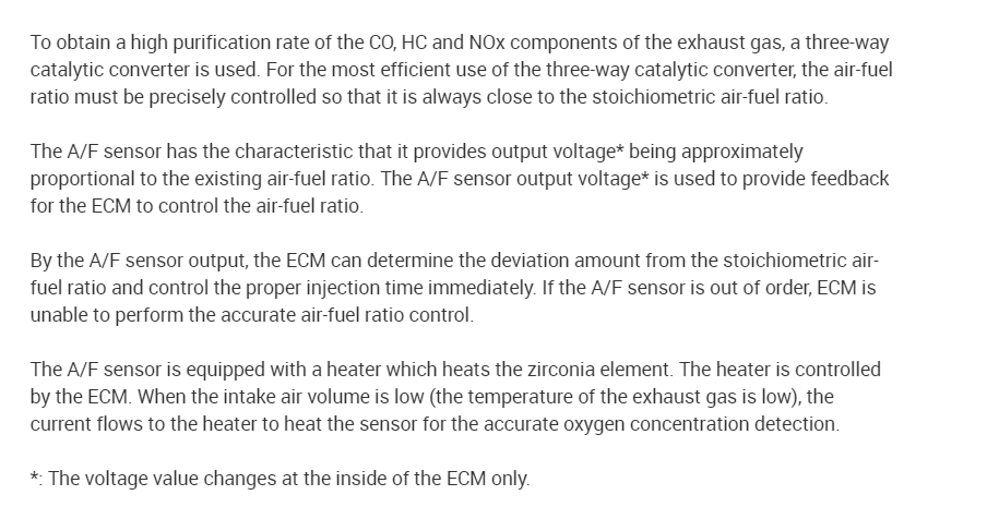

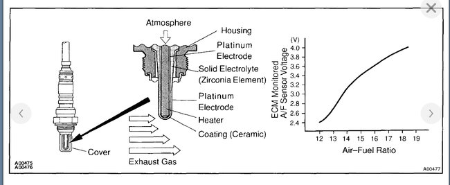

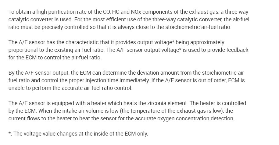

Hello again,
Okay good, the upstream O2's, in your vehicle's case Air/Fuel Sensors (AF) are the sensors that the Power-train Control Module (PCM) uses to maintain the vehicle as close to stoichmetric (14.7:1) Air:Fuel ratio. What exactly is the Direct Trouble Code?
Thanks,
Alex
2CarPros
Saturday, July 27th, 2019 AT 6:39 AM

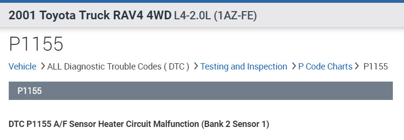

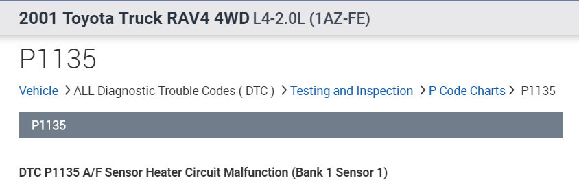

KRATOS1988
  • 7 POSTS
p1135 and p1155.
Can a bad fuel supply to my engine or a electric problems make this codes?
Saturday, July 27th, 2019 AT 6:53 AM

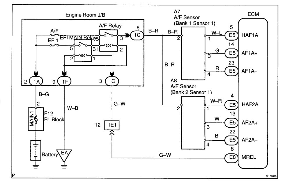

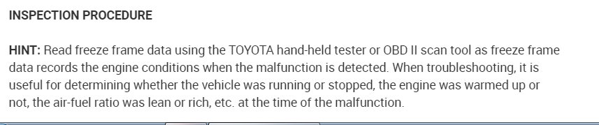

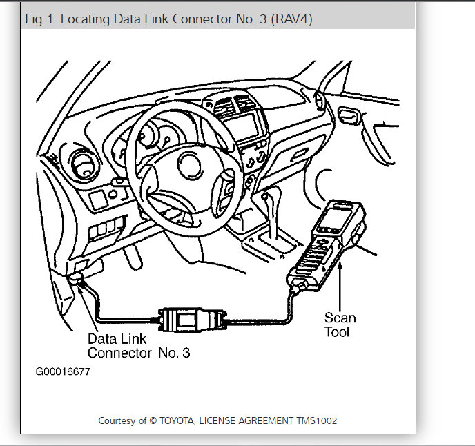

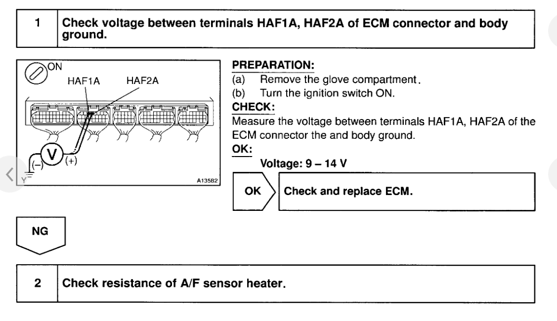

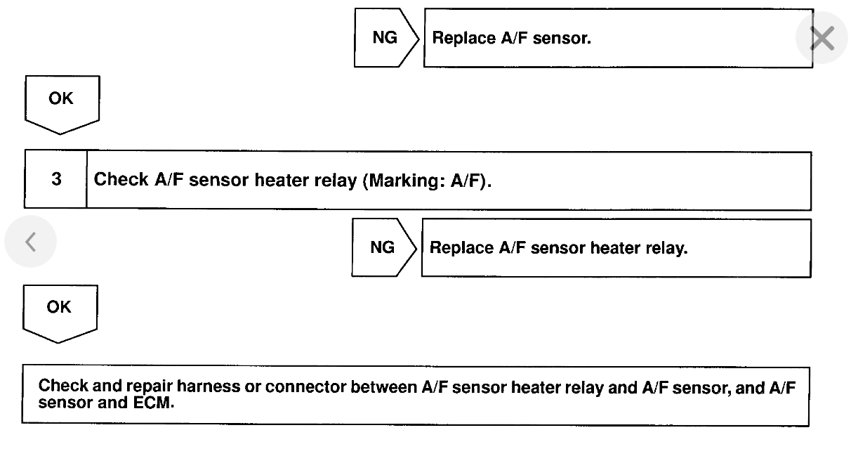

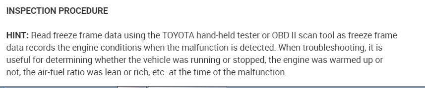

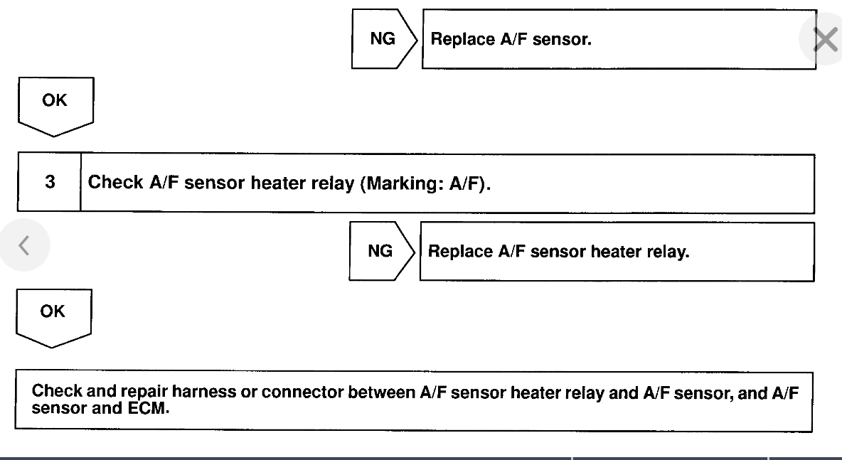

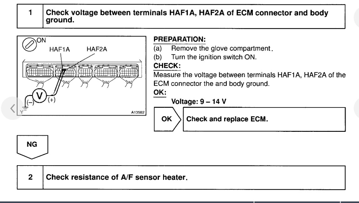

SCGRANTURISMO
  • 4,897 POSTS
Hello again,
In the diagrams down below I have included the factory diagnostic troubleshooting flowcharts for both DTC P 1135 and 1155. Please go through these guides and get back to us with what you are able to find out.
Thanks,
Alex
2CarPros
+1
Sunday, July 28th, 2019 AT 12:39 AM

KRATOS1988
  • 7 POSTS
Hello again,
so I check it and found that my o2 sensors was not good. I replaced them with new ones.
The problem now is the knock sensor fault, and still have the same problem no power and no torque.
Thanks

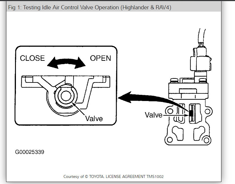

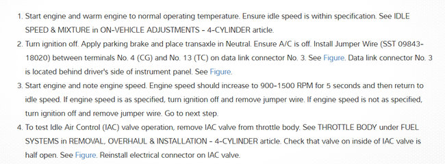

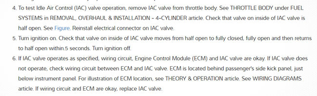

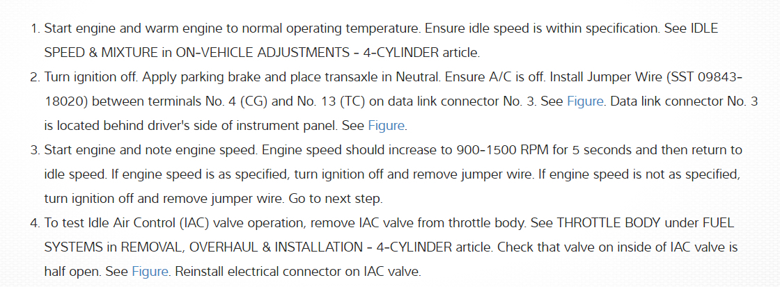

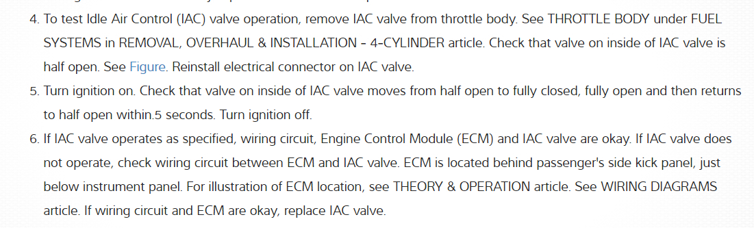

SCGRANTURISMO
  • 4,897 POSTS
Hello again,
I would do a Keep Alive Memory (KAM) relearn of your Power-train Control Module (PCM) by unhooking the negative battery cable for at least 5 minutes. This will wipe the KAM of the PCM clean. Then I have included the relearn procedure for your vehicle's Idle Air Control (IAC) Valve in the diagrams down below. Follow the guide and drive your car normally. It should relearn itself, but this time with a clean throttle and throttle body.
Thanks,
Alex
2CarPros
Monday, August 5th, 2019 AT 9:02 PM
KRATOS1988
  • 7 POSTS
Hello Alex.
Thank you so much my car working great again.
My car stopped for 3 months, and now it is working again thanks to you.
Best regards
Saturday, August 10th, 2019 AT 9:43 AM
